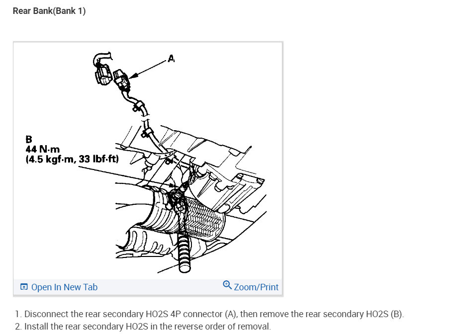

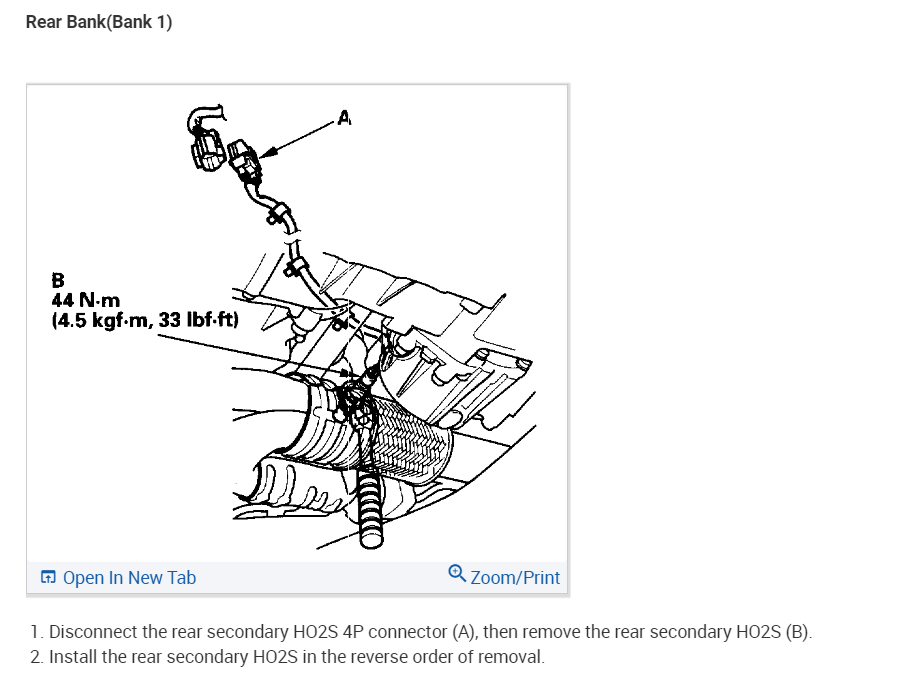

The P0141 code is a problem with the O2 bank 1 sensor 2 heater circuit. So, this will be the sensor or the wiring. I would raise the car up and check the work that was done.
And this guide can help walk you through:
https://www.2carpros.com/articles/how-to-replace-an-oxygen-sensor
Here is the location of the sensor in question so we are the same page on its location. This sensor is behind the catalytic converter. Check out the images (below). Please let us know what happens.
