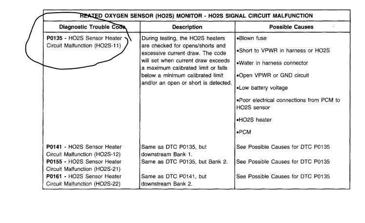

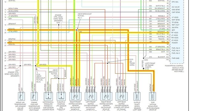

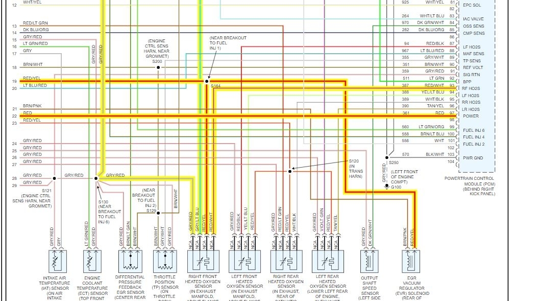

Below are the possibilities for the code. Most likely it is a wiring harness issue.
Check the red/yellow wire in the connector for power with the key on.
P0135
Descriptor
Ho2S Sensor Circuit Malfunction (Ho2S-11)
Probable Causes
Ground Circuit Open
Harness or Heated Oxygen Sensor (HO2S) Short to Ignition Switched Power (VPWR)
Heated Oxygen Sensor (HO2S) Heater Damaged
Ignition Switched Power (VPWR) Circuit Open
Low Battery Voltage
Poor Mating Terminals and Wiring or Corrosion
Powertrain Control Module (PCM) Damaged
Water in Harness Connector

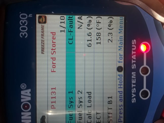

Yes can you tell me what fuel sys 2 n/a means?
Oct 14, 2019 at 4:33 PM
Where do you see that?

On my obd2 scanner.

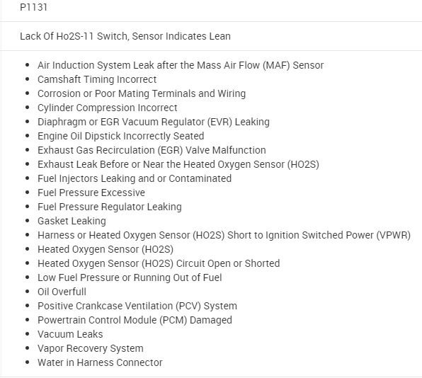

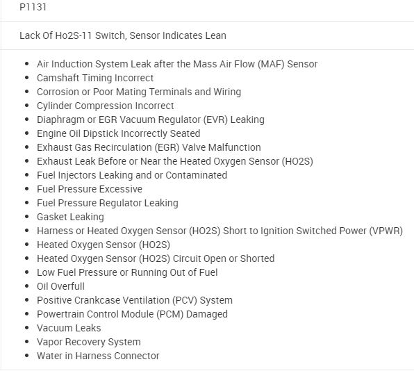

And i am getting this now:
Oct 27, 2019 at 8:16 AM
CHRIS KINARD
  • 94 POSTS

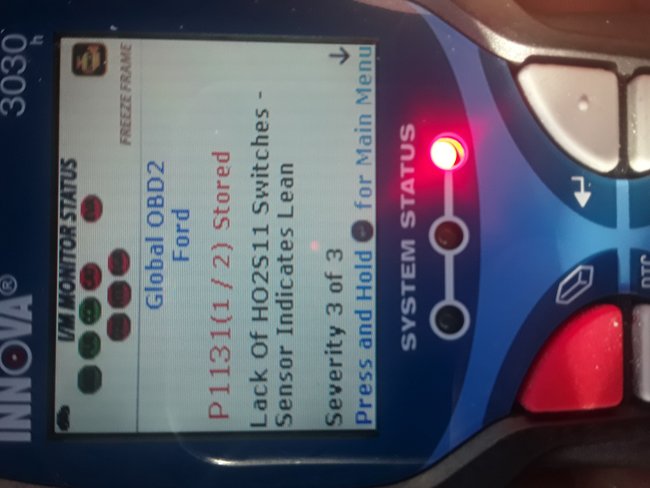

And that. Let me know the details please. God bless.
Oct 27, 2019 at 8:17 AM
What did you do to get this code?
This is for bank 1 sensor 2. It is the sensor on the driver's side down behind the converter.
Oct 27, 2019 at 10:10 AM

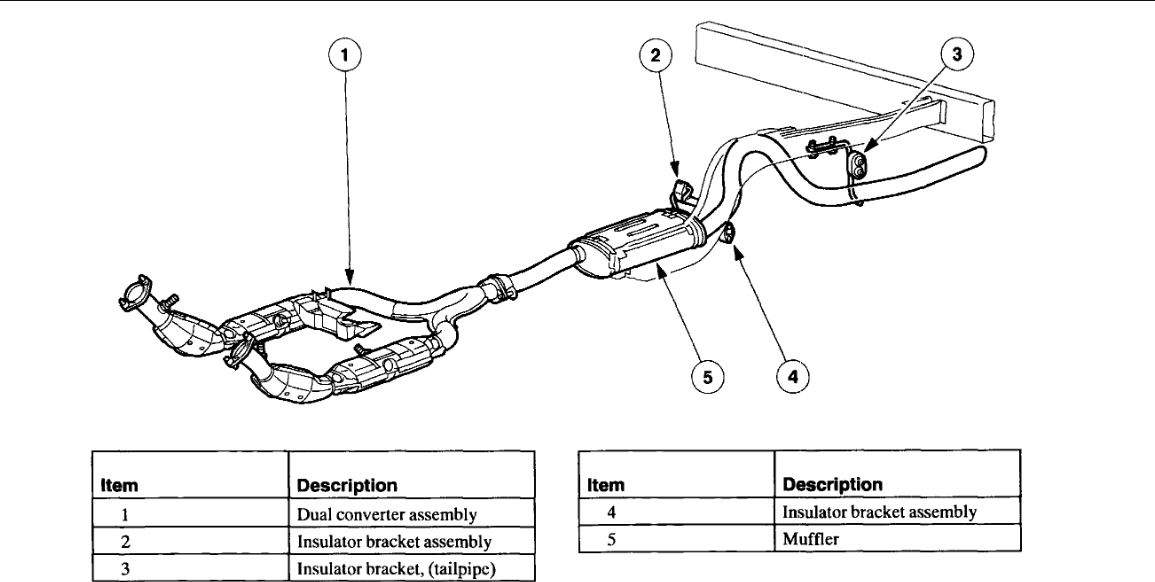

Hi, how many hangers do i have for my exhaust?
Nov 4, 2019 at 1:17 AM
3. I attached a picture.

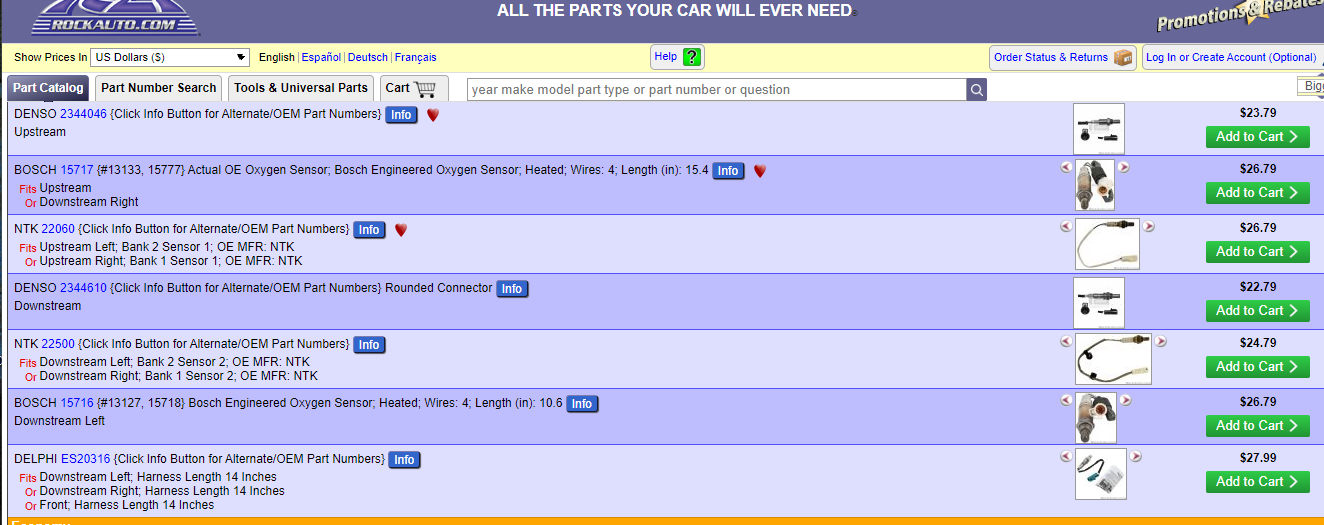

Yes, can you tell me which 02 sensors go where OEM? i have a blue, white green and purple one. Please let me know.
Nov 17, 2019 at 2:24 PM
CHRIS KINARD
  • 94 POSTS
The people at these auto stores are newbies. so i rather get a professionals answer.
Nov 17, 2019 at 2:26 PM
Okay, I attached rock auto site. It has the location of the sensor and the numbers for you.
Nov 17, 2019 at 2:34 PM
