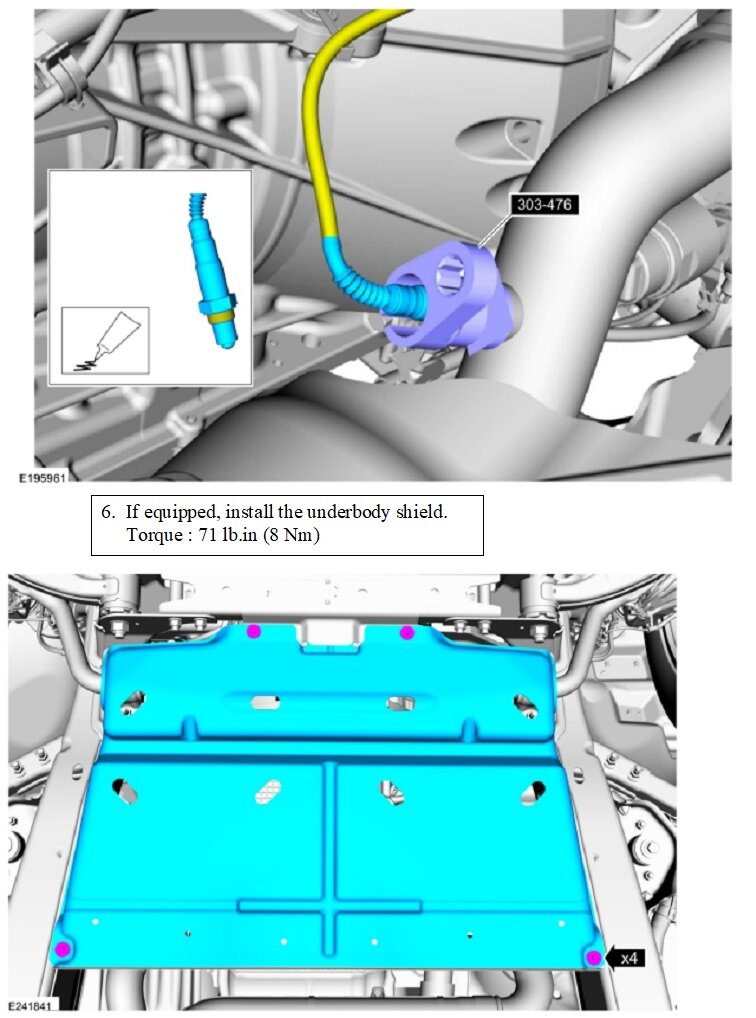

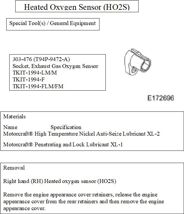

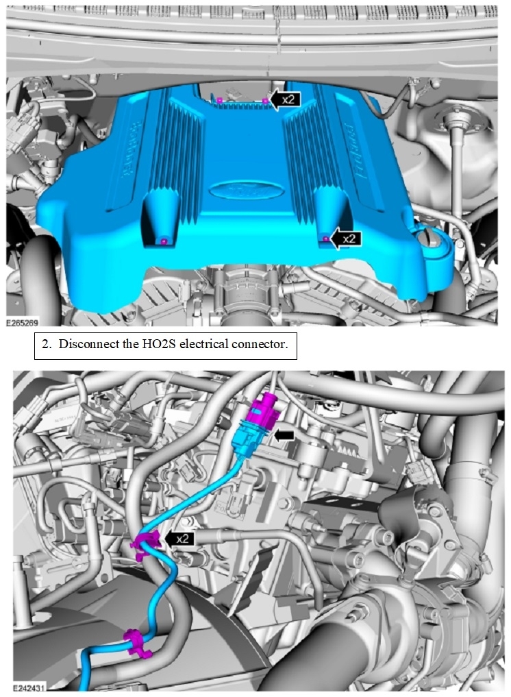

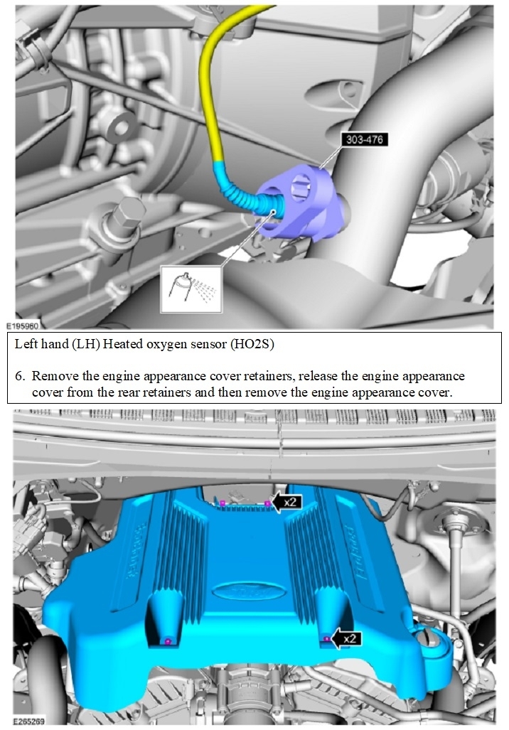

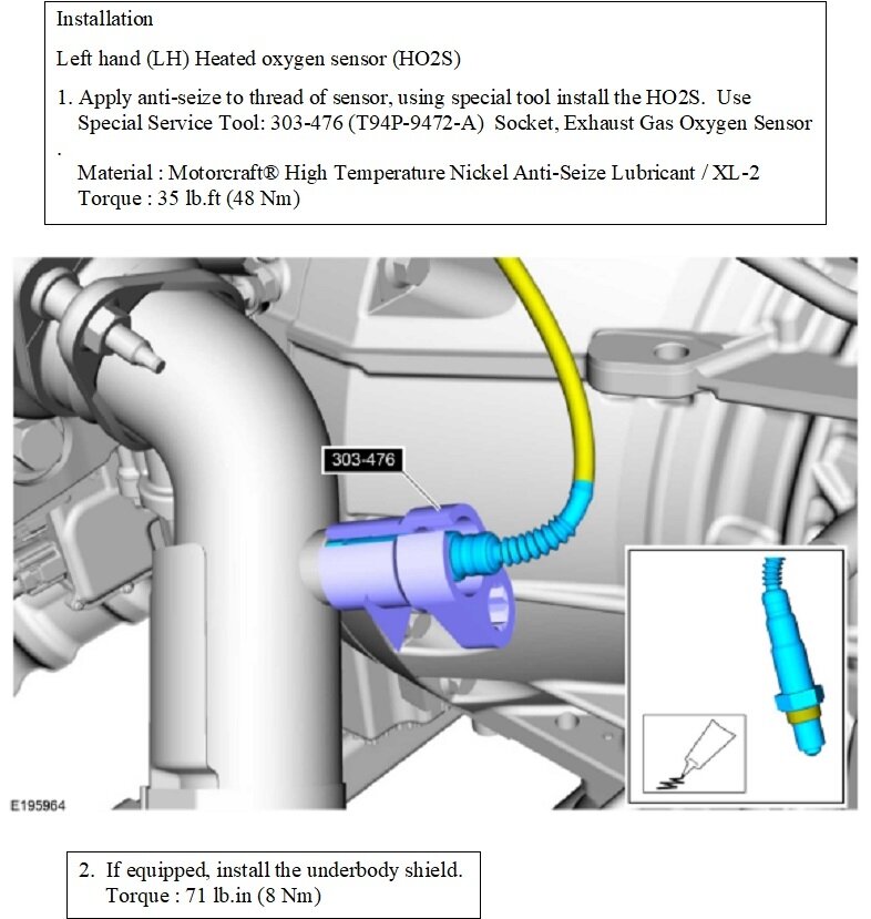

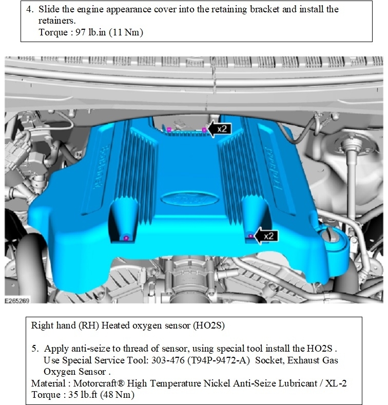

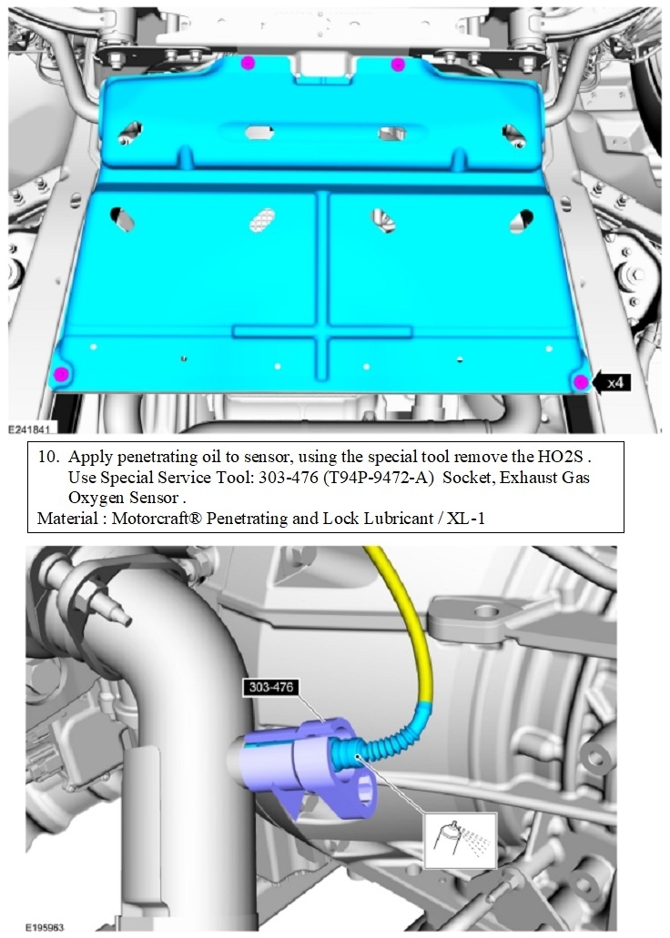

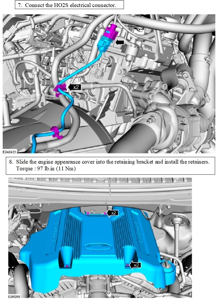

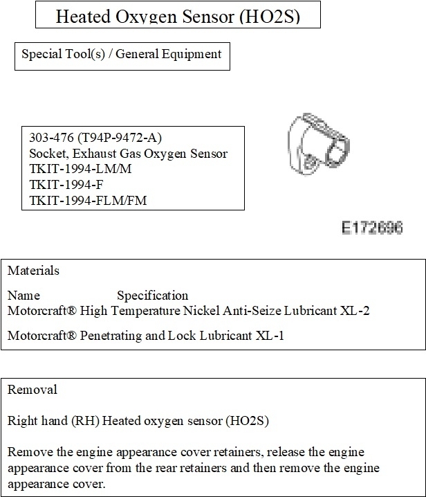

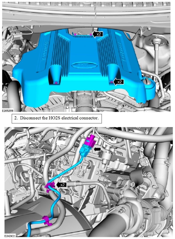

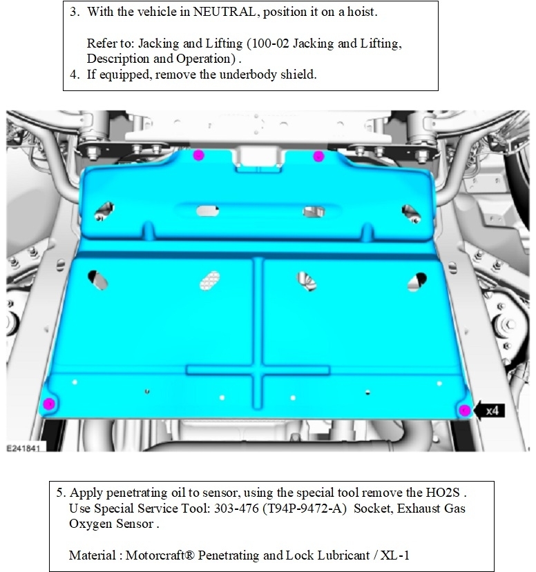

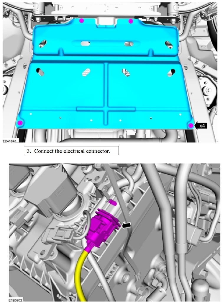

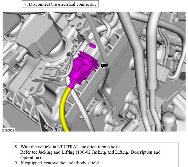

The only engine listed is a 3.5L turbo. Here's the removal instructions for all four sensors. Pictures are included to show the locations. Bank 2 is the passenger side.
