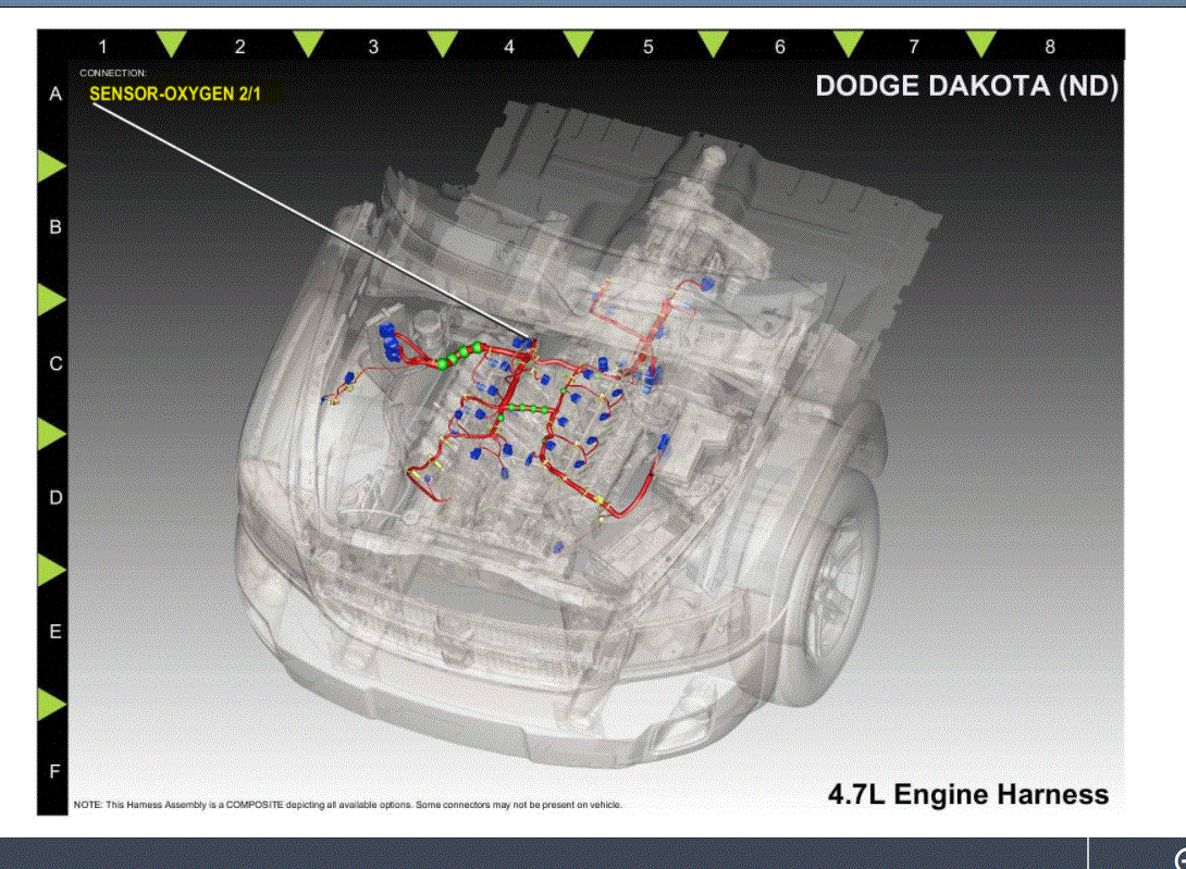

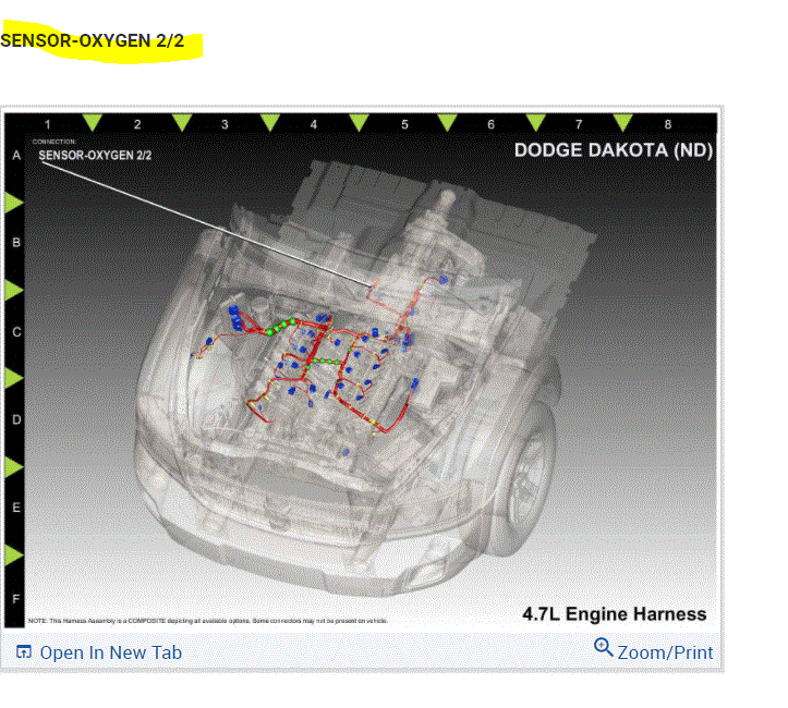

Bank 1 on a V-6 or V-8 engine is the left, or driver's side. Bank 2 is the right side. Upstream oxygen sensors are on the engine side of the catalytic converter, and downstream oxygen sensors are after the converter(s). 1995 and older models only had the upstream sensors.
