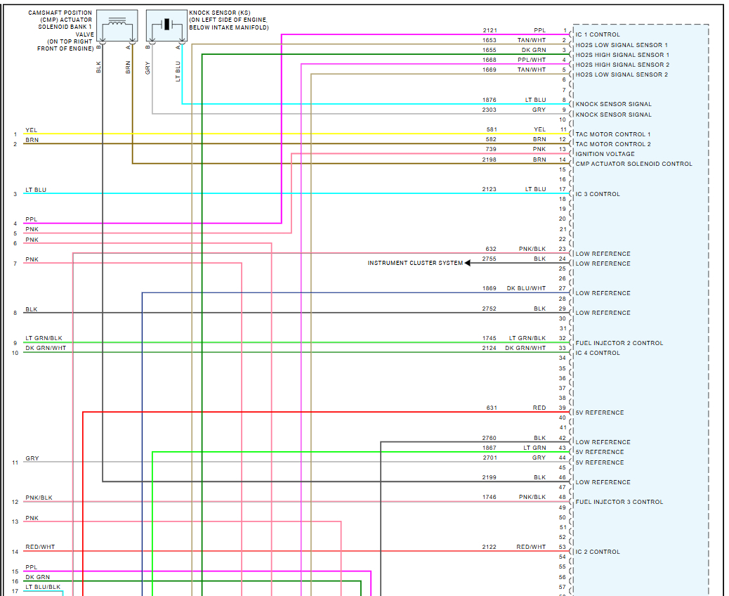

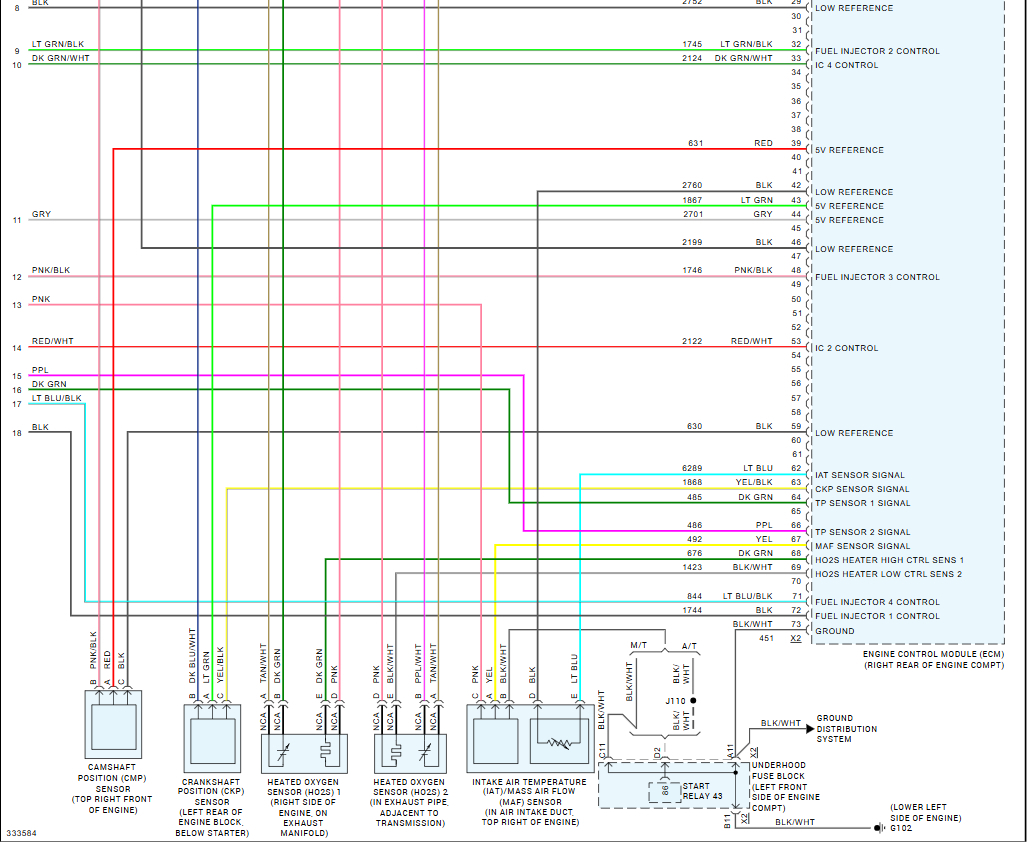

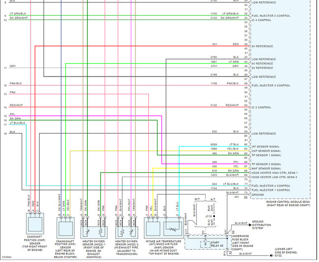

Have replaced sensor 3 times getting a sensor inactive code best I can tell only getting 0.47 volts to sensor can't find out what voltage is supposed to be coming to sensor. if I could find the correct wiring diagram it would help. Any tips on fixing this problem would be appreciated. thank you
