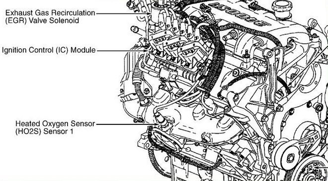

How many O2 sensors does my car have?
Feb 7, 2018 at 9:20 AM
There are two. One is an upstream (see attached picture) and the other is the downstream which is near the catalytic converter. Here is a guide to help you step by step with instructions in the diagrams below to show you how on your car.
https://www.2carpros.com/articles/how-to-replace-an-oxygen-sensor
Feb 7, 2018 at 12:10 PM
