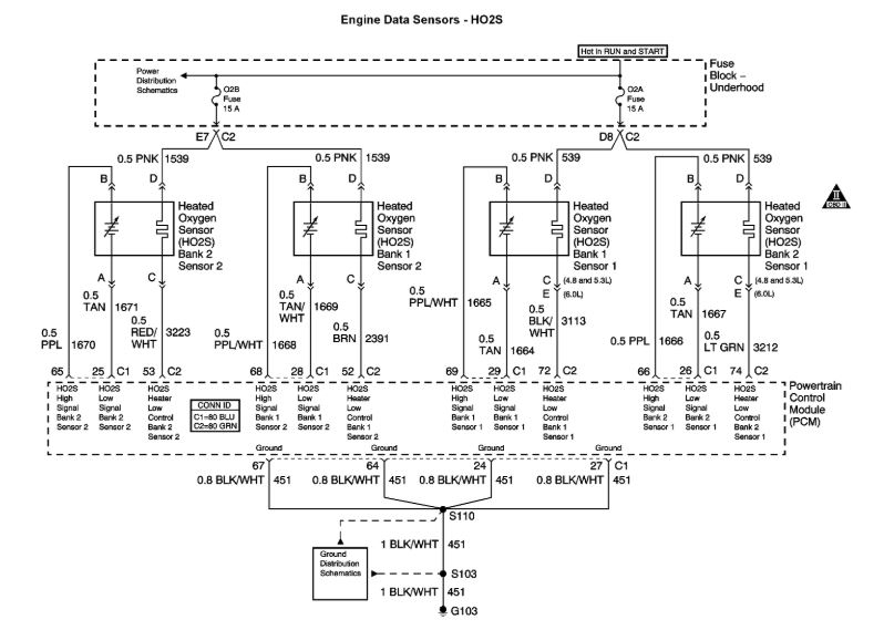

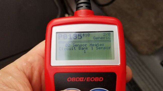

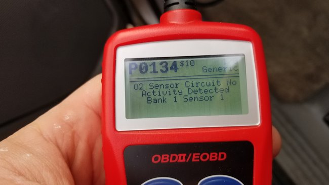

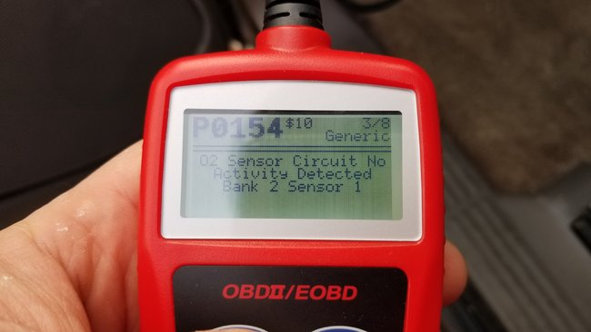

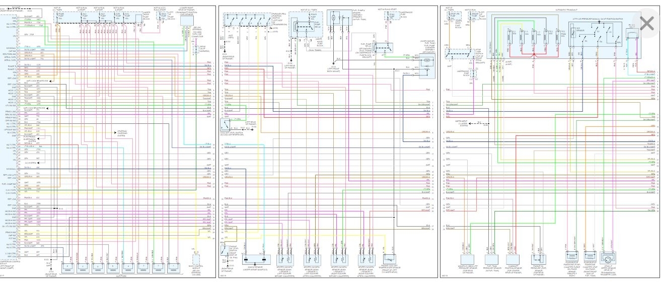

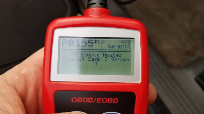

Engine light came on so I attached my code reader to truck it produced codes saying the bank 1 o2 sensor 1 and bank 2 o2 sensor 1 were not functioning. replaced both sensors and cleared codes after forty five minutes running the light came back on and produced the same codes.
