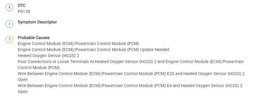

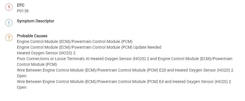

Good morning,
This code looks like an electrical issue with the wiring harness or possible ECM.
The 2 codes are the same the difference being 138 is the rear and the 139 is the front.
You will need a voltmeter to do the correct testing.
DTC P0138: Secondary HO2S (Sensor 2) Circuit High Voltage (2005-2006 models)

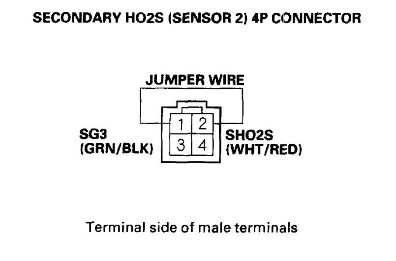

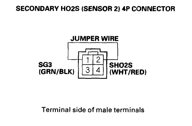

7. Connect secondary HO2S (Sensor 2) 4P connector terminals No. 1 and No. 2 with a jumper wire.
8. Turn the ignition switch ON (II).
9. Check the HO2S S2 in the DATA LIST with the HDS.
Does the voltage stay at 1.25 V or more?
YES - Go to step 10.
NO - Go to step 19.

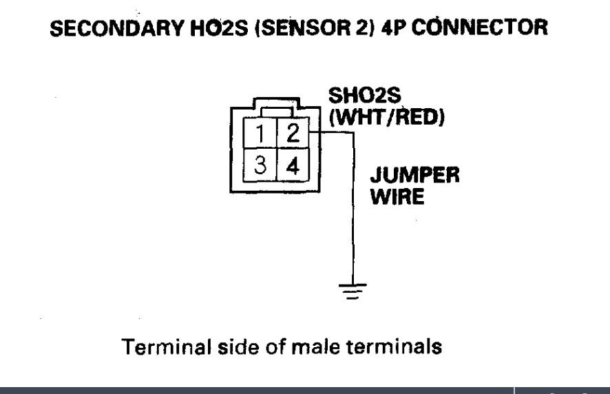

12. Connect secondary HO2S (Sensor 2) 4P connector terminal No. 2 to body ground with a jumper wire.
13. Turn the ignition switch ON (II).
14. Check the HO2S S2 in the DATA LIST with the HDS.
YES - Go to step 15.
NO - Repair open in the wire between the ECM/PCM (E4) and the secondary HO2S (Sensor 2), then go to step 21.

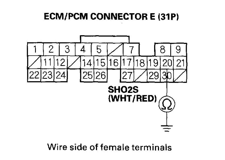

17. Disconnect ECM/PCM connector E (31P).
18. Check for continuity between ECM/PCM connector terminal E20 and body ground.
Is there continuity?
YES - Go to step 29.
NO - Repair open in the wire between the ECM/PCM (E20) and the secondary HO2S (Sensor 2), then go to step 21.
