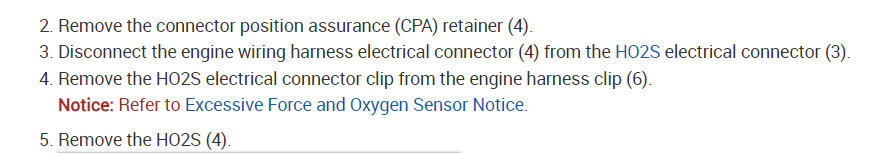

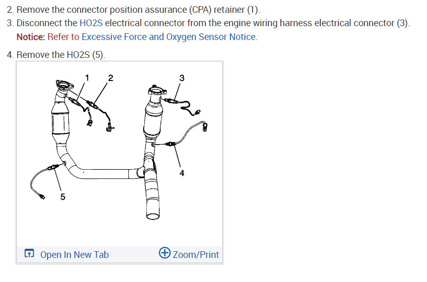

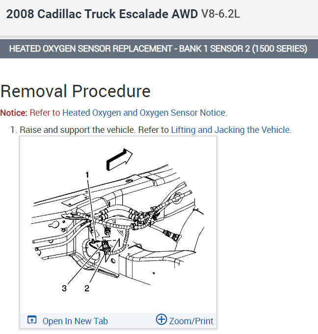

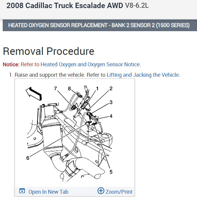

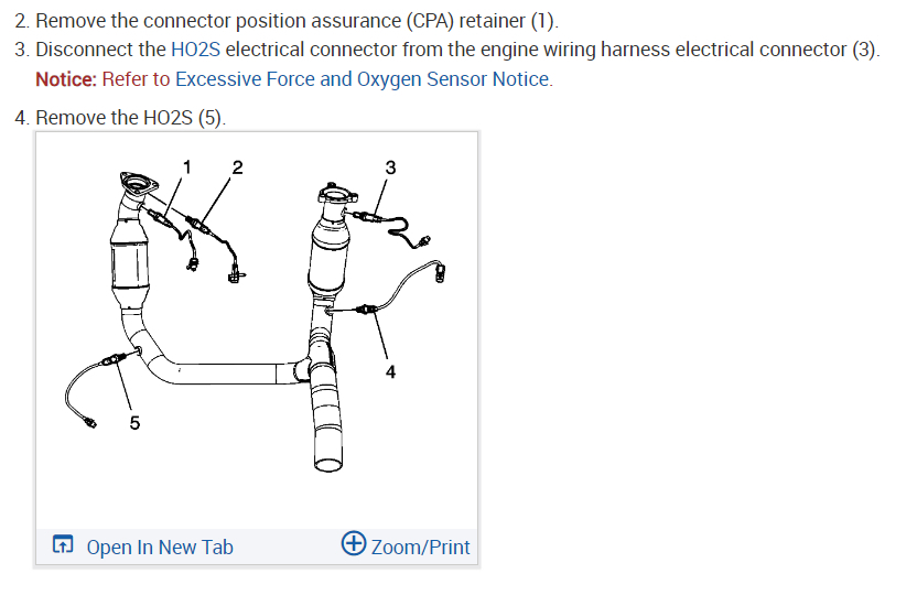

Did all of these codes come up at once? If not let's replace the 4 oxygen sensors with new units, here are the locations in the images below, here is a generic guide to help you step by step with instructions in the diagrams below to show you how on your car.
https://www.2carpros.com/articles/how-to-replace-an-oxygen-sensor
Clear the codes once the repairs have been completed and the problem should be solved. Check out the images (below). Let us know how it goes.
