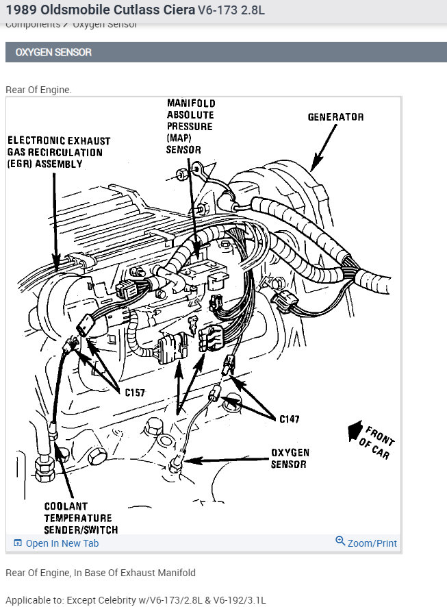

i have a bad O2 sensor but can find specifics about the location.

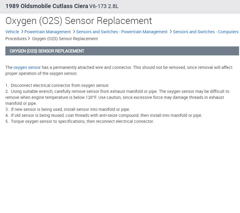

The oxygen sensor is located on the back of the engine, at the base of the exhaust manifold.
https://www.2carpros.com/articles/how-to-replace-an-oxygen-sensor
I have attached a diagram showing the location and replacement steps.
