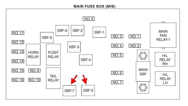

That code refers to the oxygen sensor's heater circuit. It could indeed be caused by a defective sensor, but it is just as likely to be caused by corrosion on a connector terminal, a cut wire, or water in the connector that caused a fuse to blow. Also look for a wire harness that fell down onto hot exhaust parts.
Lets start with the easiest thing to check. I can only find two fuses related to the O2 sensors. Those are SBF-5 and SBF-7, both 30-amp, in the under-hood fuse box. Check for 12 volts on both sides of both fuses with the engine running. If you find 12 volts on one side of a fuse and 0 volts on the other side, that fuse is blown.
