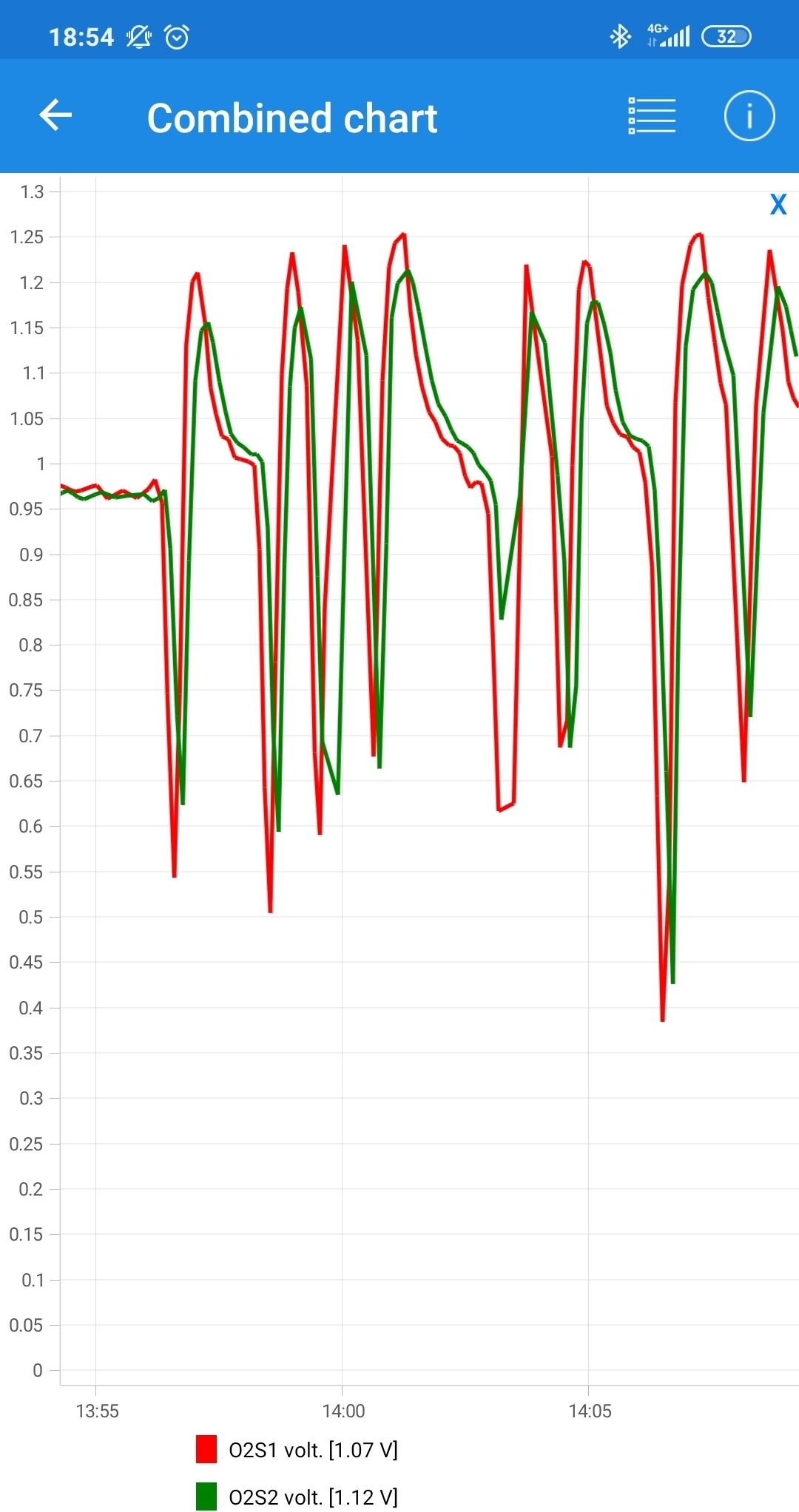

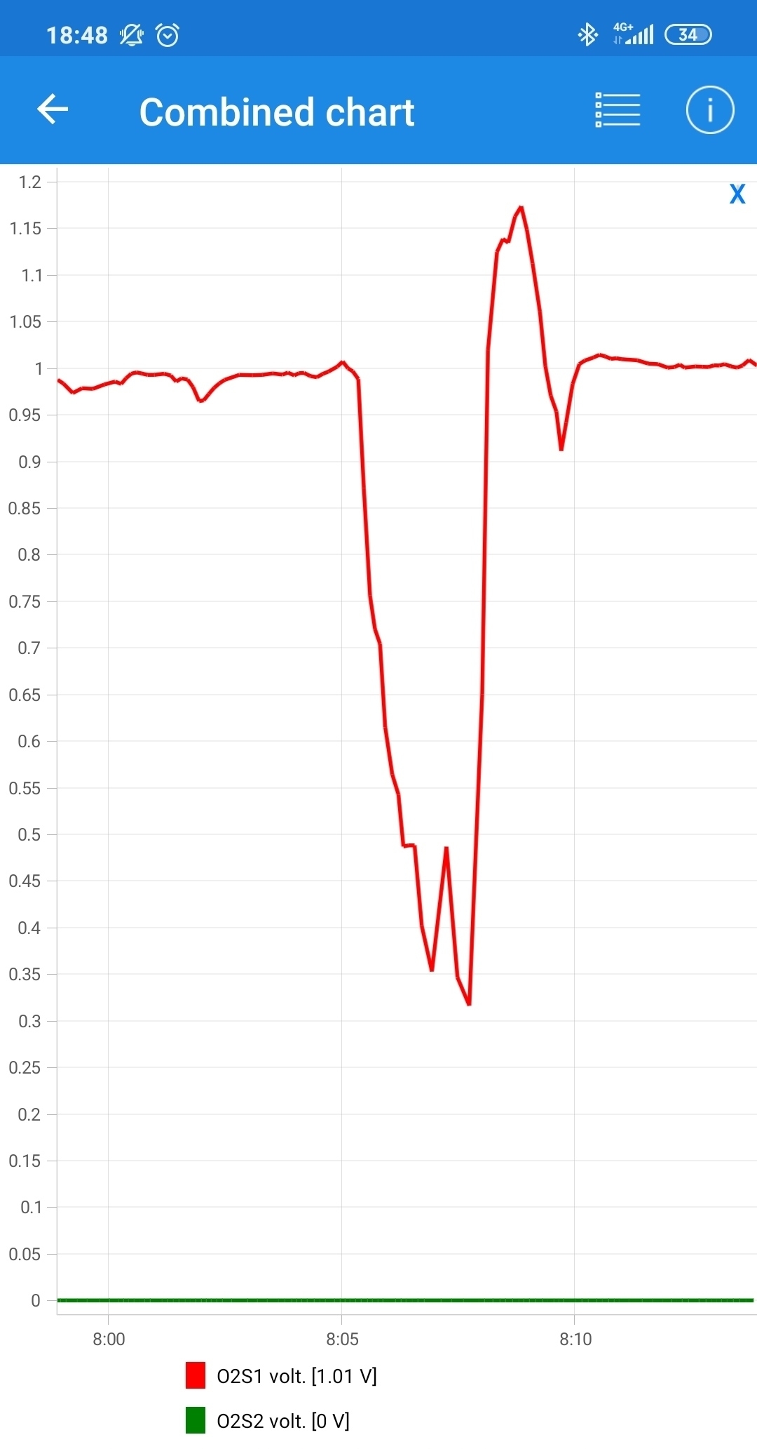

My car has judder on cold start when you pull away from first gear. This happen only when the weather is cold or wet. There is no light on dash, no error code. I have obd2 scan tool and i have notice that on cold start my o2 sensor 2 (downstream) is not responding in first 15 minutes while the upstream start to measure in 1m. After downstream will start showing voltage the issue is gone and car runs smoothly. My question is, should downstream sensor start working sooner and can be that cause of my judder when the car is start from cold?
