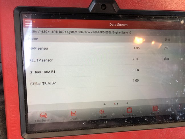

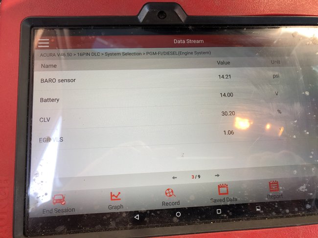

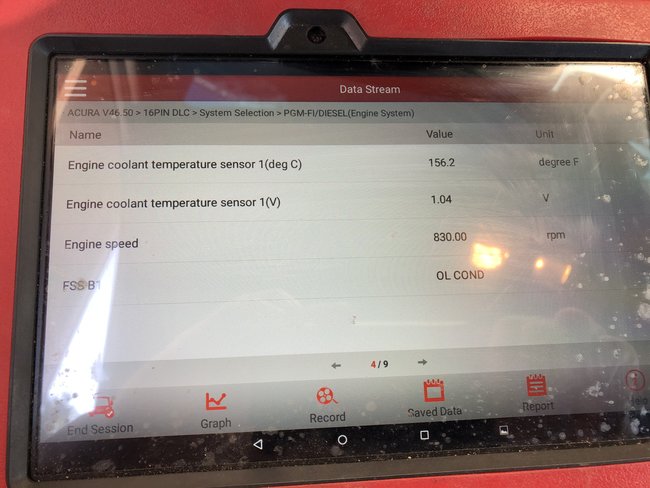

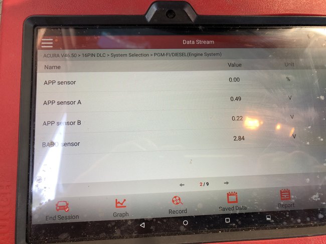

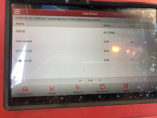

NASER NASER
  • 836 POSTS

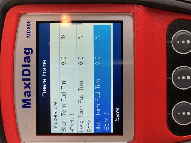

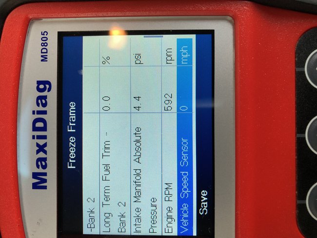

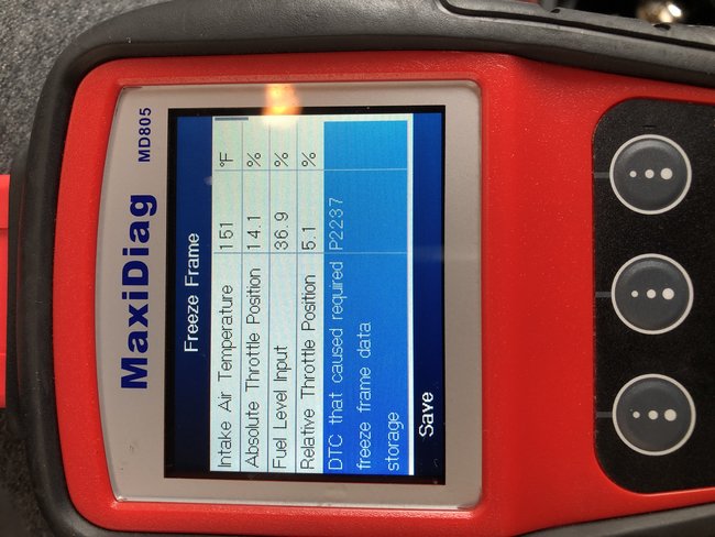

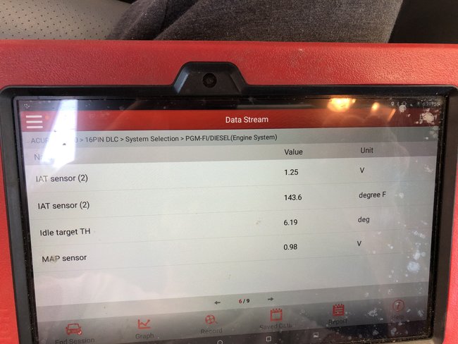

Cleared it. Started the car. Throttle doesn't affect it. Waited 15 seconds and cane back, did it again and again it cane back in 15 seconds. Attached
Aug 4, 2020 at 1:51 PM
NASER NASER
  • 836 POSTS
More.
Aug 4, 2020 at 1:53 PM

It could be not always. In the case he was talking about it wasn't a constant failure but sending odd data. So instead of a pattern of data like 1-2-3-4-1-2-3-4 it would send 1-2-3-3-1-2-3-4 instead. However it's hard to know for sure when there is no real data on that code.
Do you perhaps have a second scan tool that can read just the code? Just want to verify the number. I don't want to give you info on a code only to discover it was something like a coil failure.

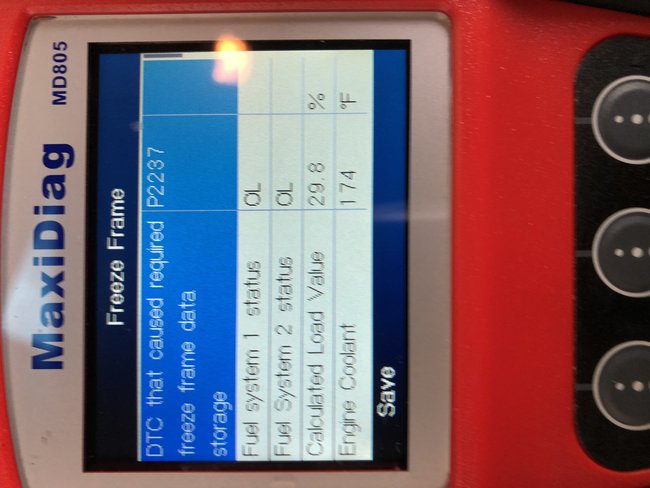

NASER NASER
  • 836 POSTS
Yes, i have other scanners, just the fault code or freeze frame data?
Aug 4, 2020 at 3:08 PM
NASER NASER
  • 836 POSTS

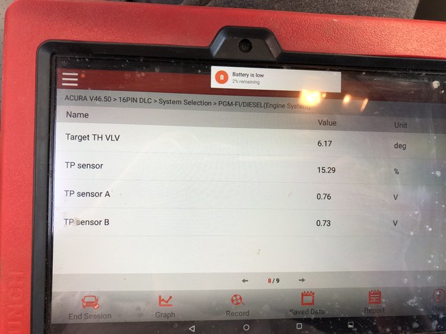

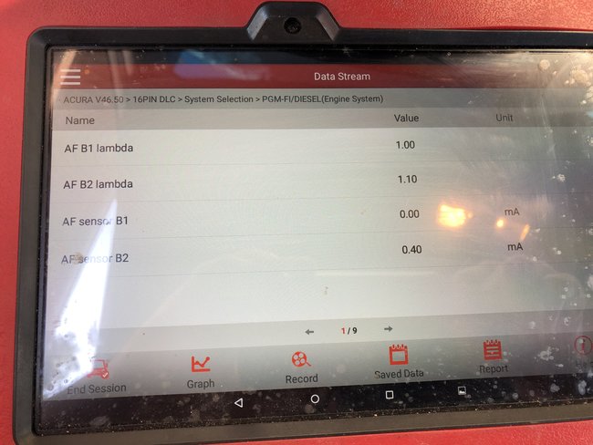

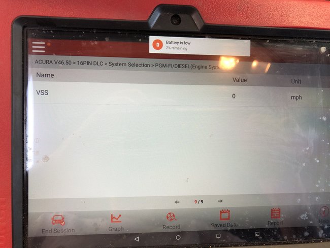

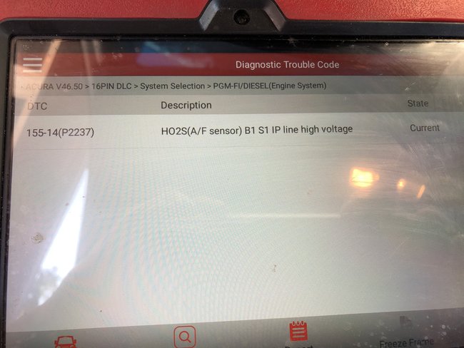

Attached.
Aug 4, 2020 at 3:28 PM
STEVE W.
  • 15,113 POSTS
Okay, those numbers let me find a bit more. Acura shows the 155-14 code as almost identical to a P0155 code, except it is an issue with the Os sensor being shorted to a higher voltage. I would verify the ground for the sensor as a bad ground could cause the signal to be elevated. If the ground is good then monitor the sensors output to see if it's correct and changing the way it should. My bet is that it is showing a voltage higher than it should and that is setting the code. Check the green wire to the sensor for a problem.
Aug 4, 2020 at 3:55 PM
NASER NASER
  • 836 POSTS
Thanks. How to check the output? I will ground is good and green has power, these tested while car running? Measure output via scanner? When cold? Operating temperature?
Aug 4, 2020 at 4:02 PM
STEVE W.
  • 15,113 POSTS
Being an AFR sensor and not a standard O2 sensor they can be a pain. The scan tool should read the lambda, amps and voltage from the sensor. Looking at that second image showing those numbers you can see there is no ma draw on the bank 1 sensor. That makes me think it has either a bad ground or a bad connection. The Lambda of 1.00 also makes me wonder as that isn't something that normally happens unless the mix is perfect. Lambda at perfect stoichiometric is ­displayed as lambda 1.0. Numerical values above lambda 1.0 indicate a lean ratio, while ­values below lambda 1.0 indicate a rich ratio. If you look at bank 2 it's showing 1.10 or slightly rich. A quick test is to run the engine until a bit, they normally start working at 10-20 seconds of run time, now stomp the gas pedal to create a rich mix and watch that lambda number. It should change to a rich mix and then settle back fast if the sensor is working.

The code you have is for B1 S1 which is the upstream AFR sensor. Upstream should be a 7 pin connector while the downstream is a 4 pin. Both of the upstream units are the same so you could swap the sensors around and see if the code changes. That would narrow it down a bit.
