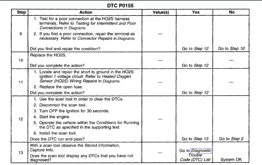

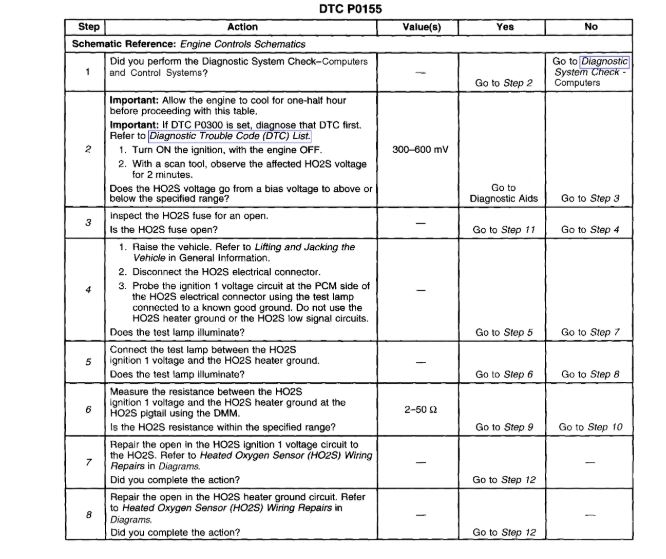

Good afternoon,
I attached the description and a flow chart for you to follow. It is the sensor in most cases that causes this code but there are many other possibilities as well.
