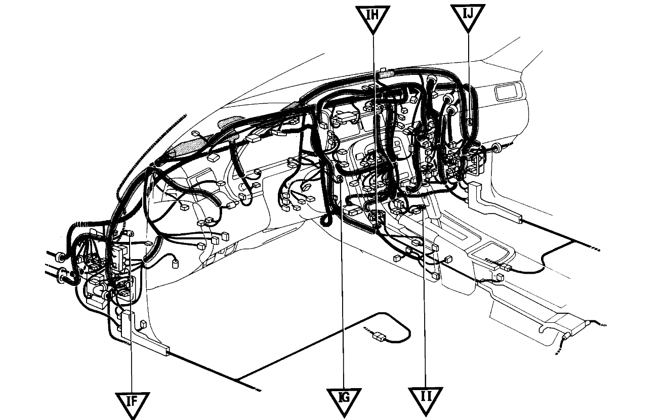

When you say you changed the condenser module, do you mean at the front of the car, or do you mean the evaporator under the dash? If under the dash you need to check the ground wires. here is the location I am talking about. Check out the diagrams (below). Please let us know what you find. We are interested to see what it is.
