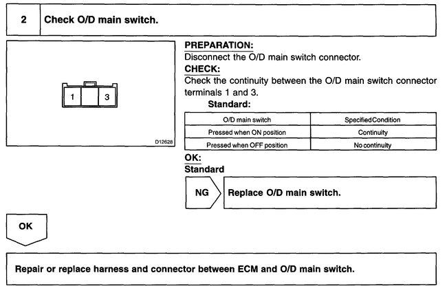

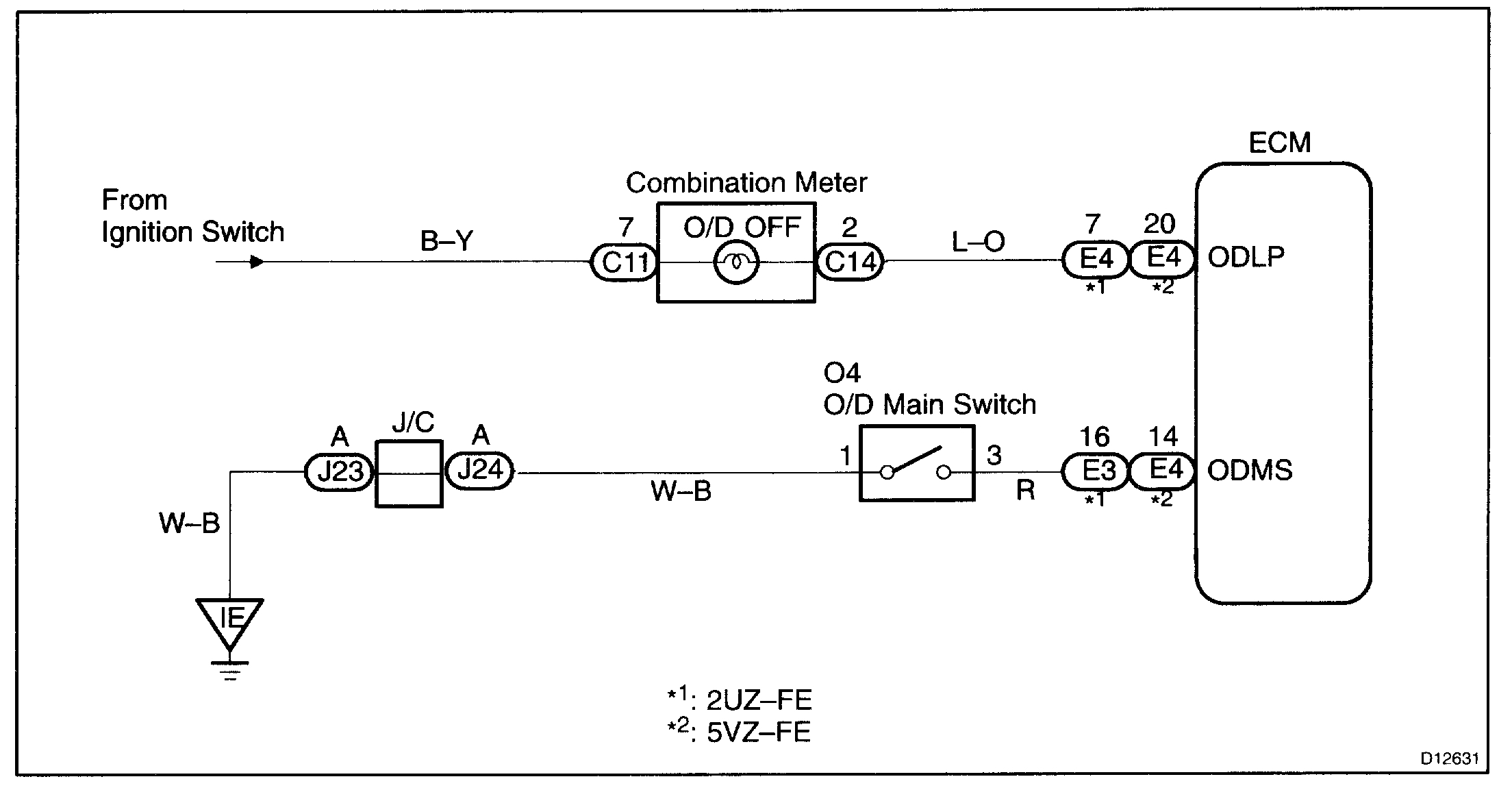

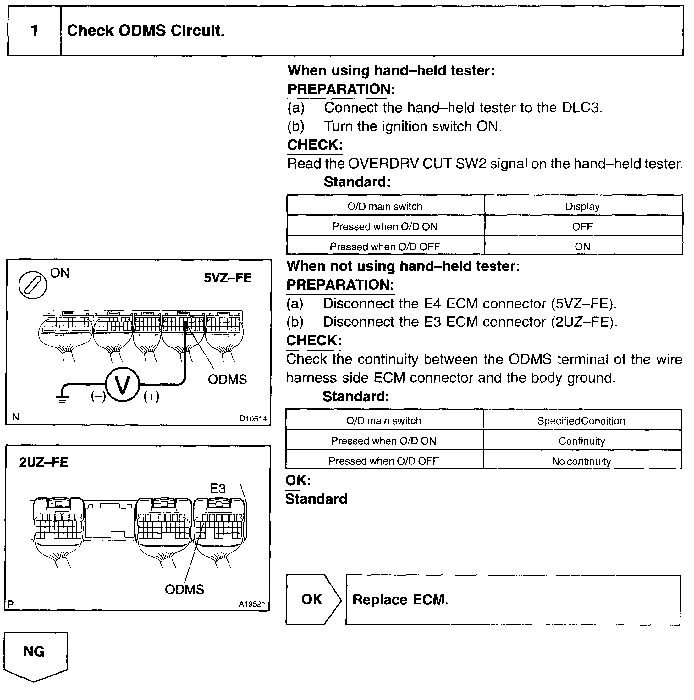

It sounds like an issue in the switch wiring. I have a diagnostic chart. It is somewhat involved for testing specific leads. However, I have a feeling it is related to the wiring. Something must be shorting to power when the switch is in the reverse position.
If you look at the attached pics, it shows the schematic and the procedure. Again, it's a little involved. However, here are a few links you may find helpful:
_____________________
Let me know if this helps.
