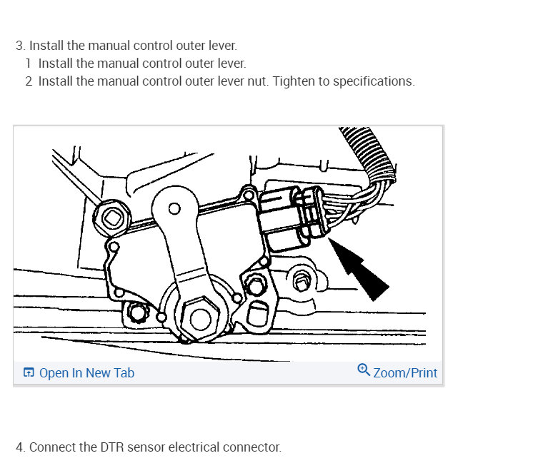

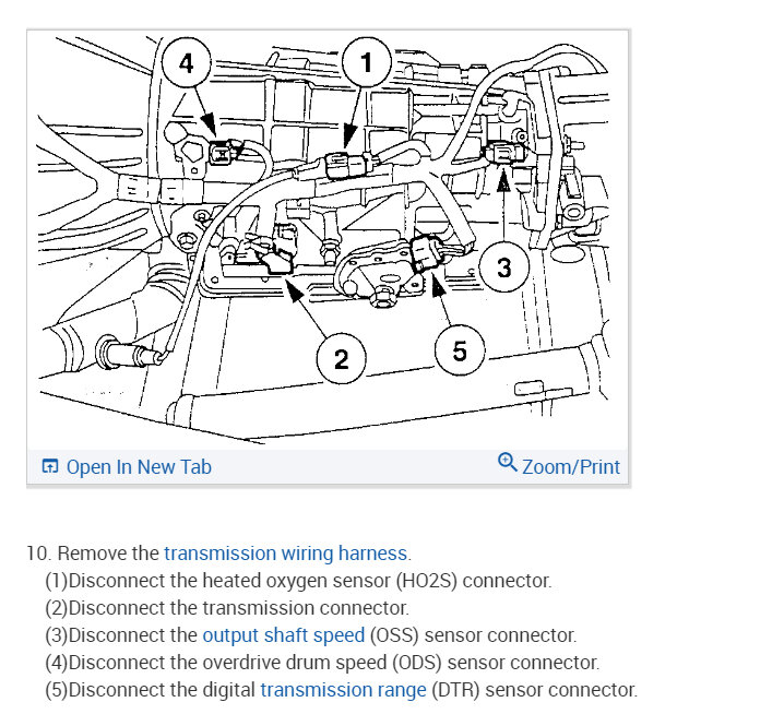

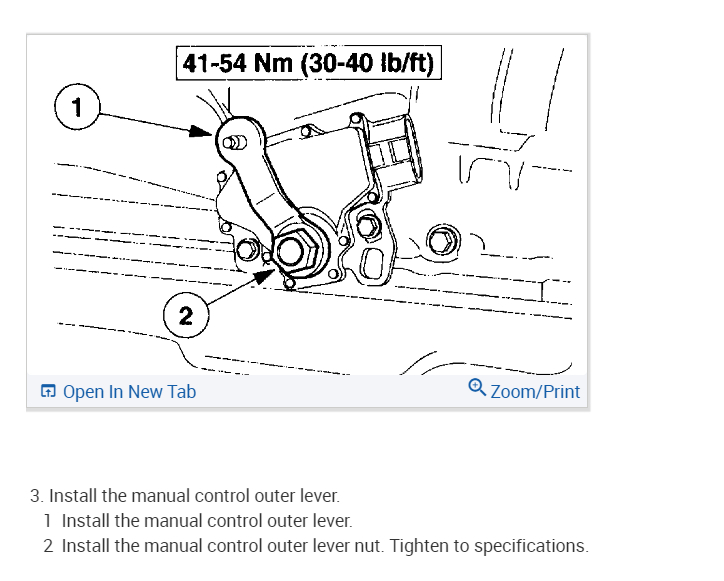

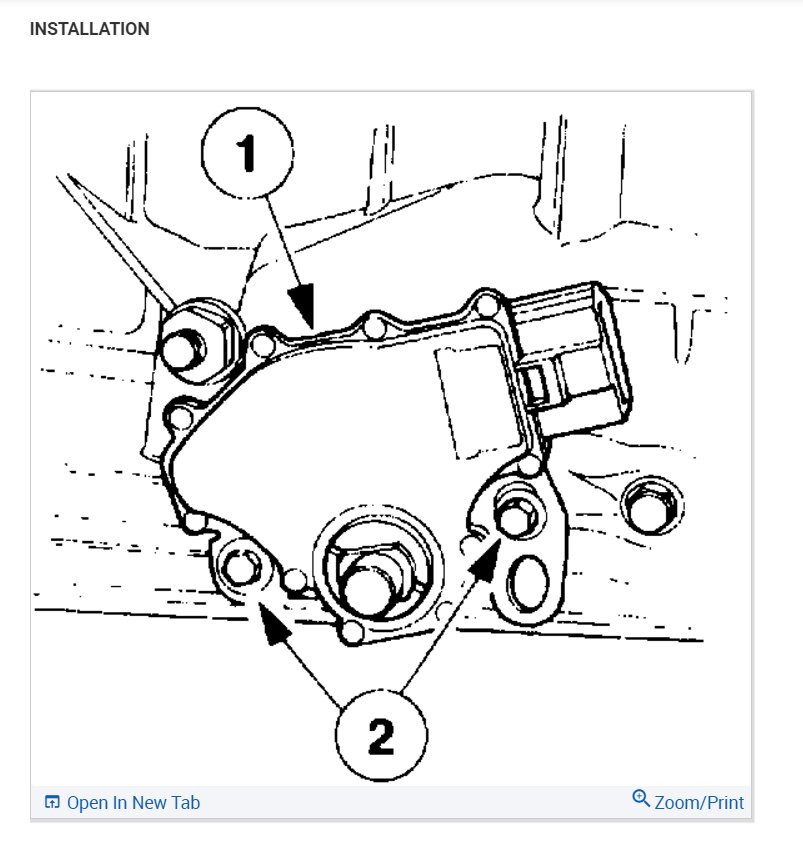

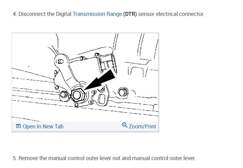

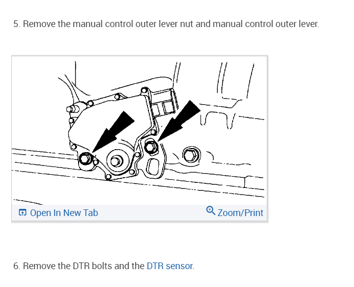

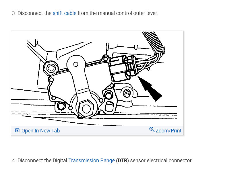

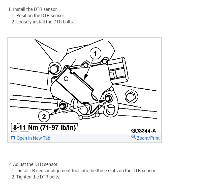

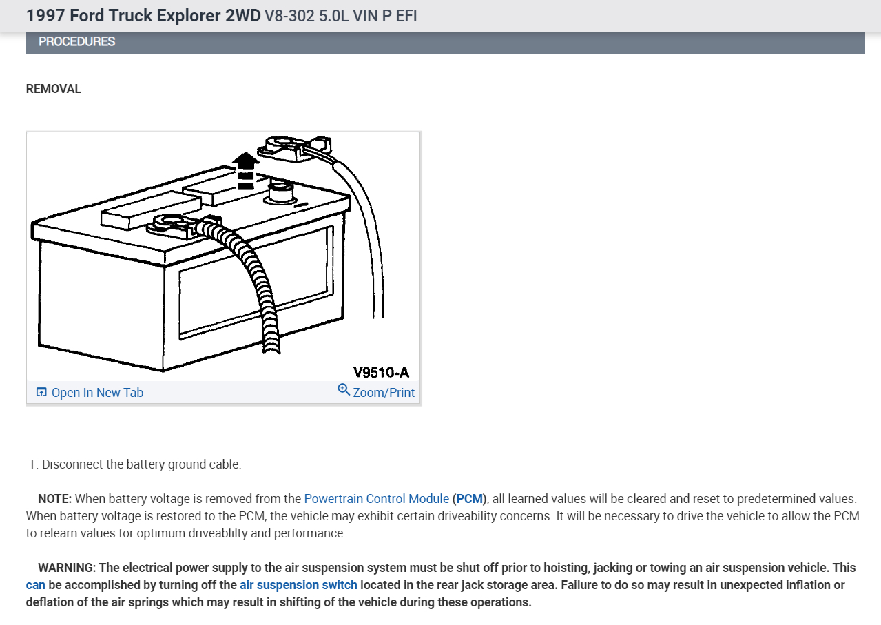

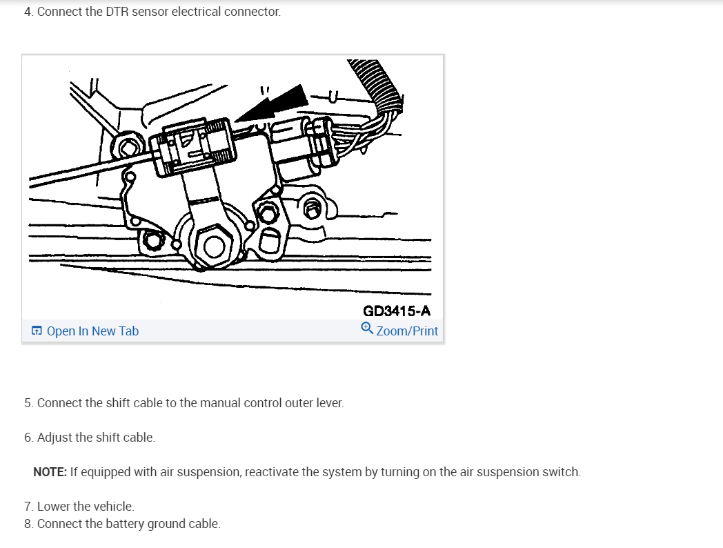

Any codes? Let's use this guide to see what comes up, also I have seen the transmission range sensor cause issues like this as well.
Here is how to replace it in case you need it. Check out the images (below). Please let us know what you find. We are interested to see what it is.

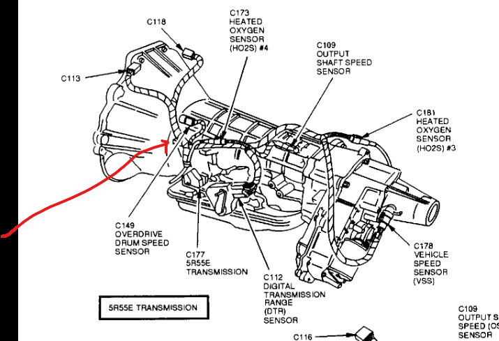

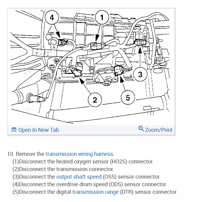

How does the transmission seem to work? I have seen the overdrive drum sensor go out and cause this problem here is the location in the images below. Please check it out and let us know.

Transmission was replaced as I initially thought that was the problem. But I did notice something else. It seems to shift through 4 gears before it gets to 30. And sometimes it shifts hard through all gears and sometimes not. Also, if I turn overdrive off it will be high RPMs at 20 MPH. And I also noticed that if it hits a bump hard enough, the transmission will not engage and you have to shift through 4wd, 4wd low and then back again to get it to reengage. At this point I am starting to suspect transfer case itself.
