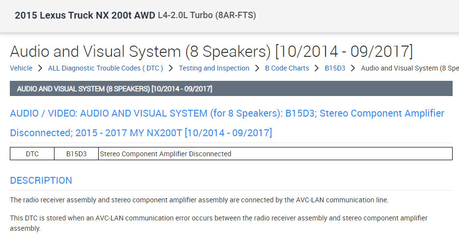

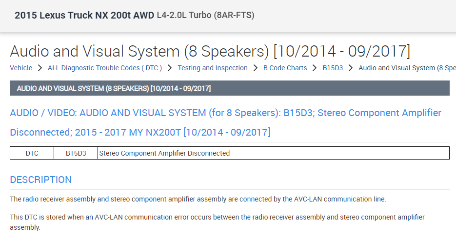

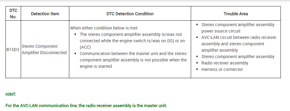

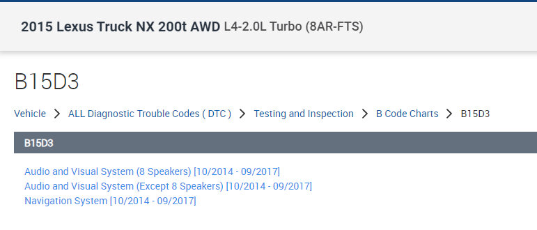

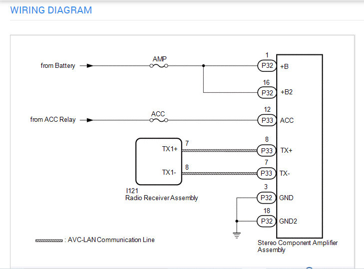

The B15D3 is related to the communication between the tuner and the audio amp. This DTC is stored when an AVC-LAN communication error occurs between the radio receiver assembly and stereo component amplifier assembly. Since it appears you have lost control at the tuner, I suspect that is where the issue is.
However, to diagnose it properly, I need to know if it is an 8-speaker system or not. See pic below. Let me know.
See pic below.

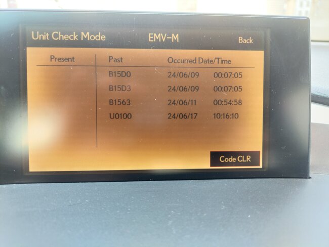

Moreover, I just tried to diagnose and found further error codes as below.
B15D0
B15D3
B1563
U0100
Note: please, note that there is a dim circle in the middle of the display i forgot to mention earlier and also forgot to answer your question yes there is no sound at all.

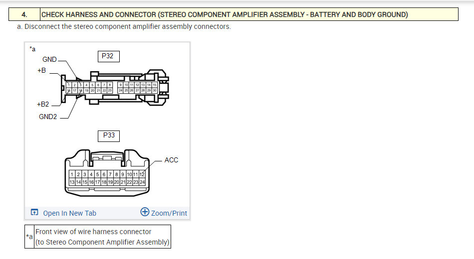

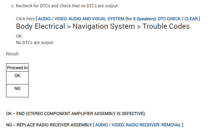

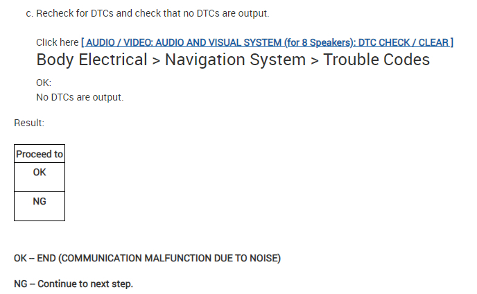

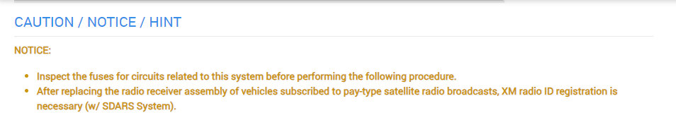

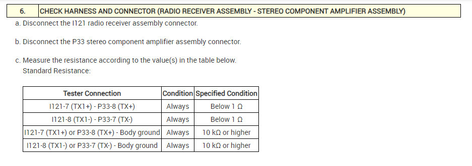

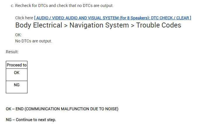

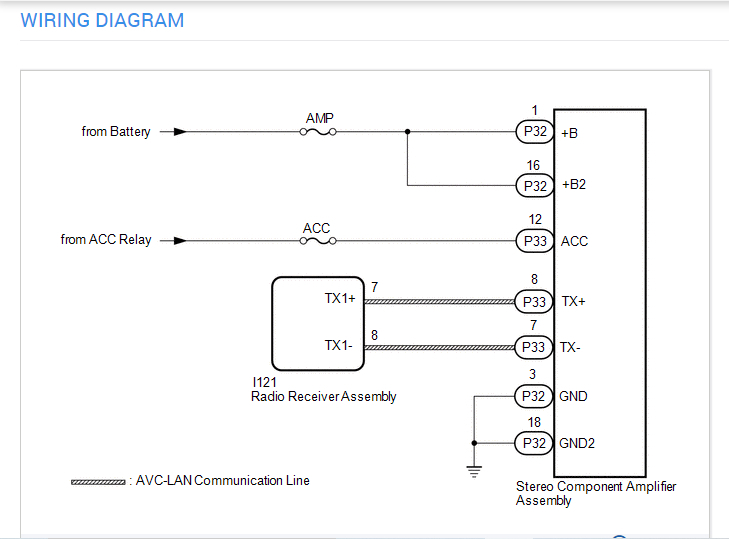

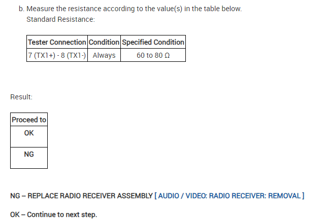

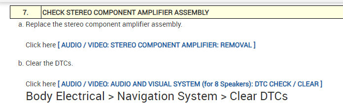

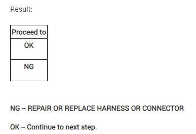

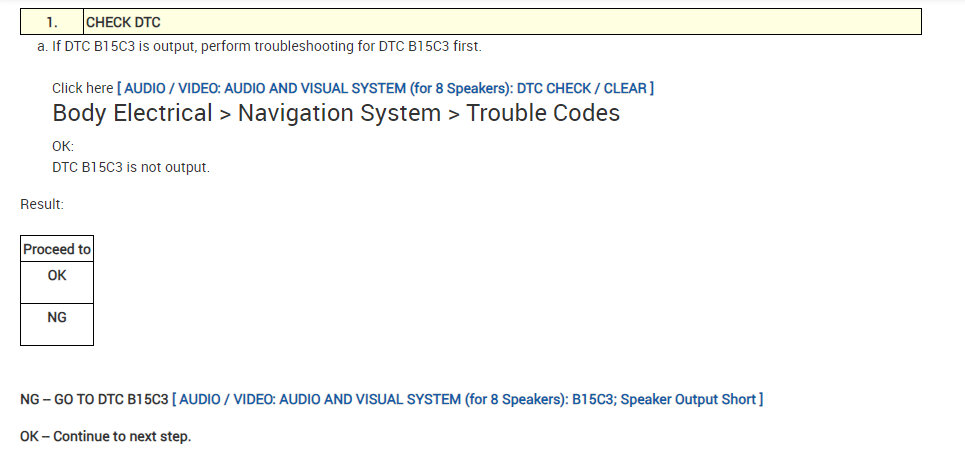

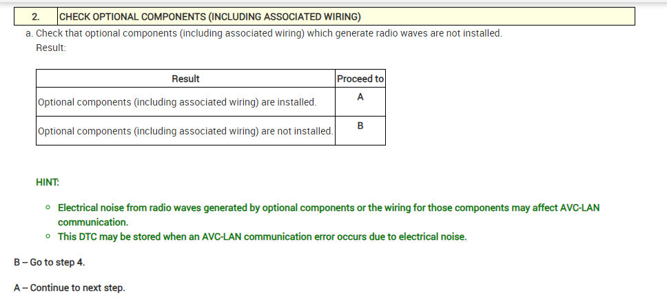

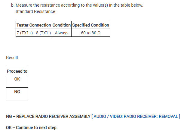

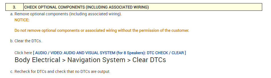

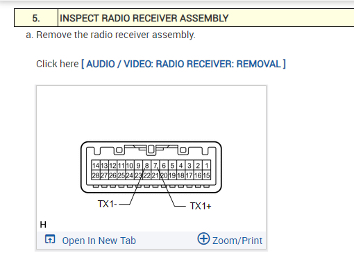

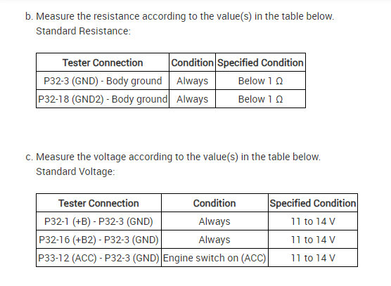

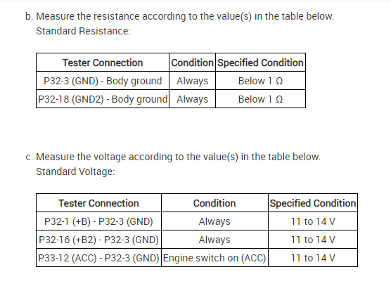

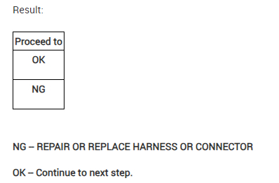

We have several codes that seem to lead me to believe there may be an issue with the wiring itself. I'm not sure how much help I'll be from here, but I'll give it a shot.
After reviewing the codes you provided, I attached the diagnostics below B153D. This is where I would start because it checks power and communication lines between the tuner and amp. Additionally, it will also check the components. Take a look and let me know if this is something you are comfortable performing.
See pics below.
