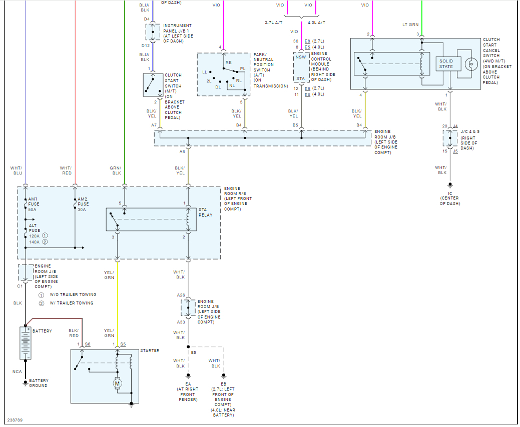

My truck broke down and I'm stuck in traffic. How do I bypass the switch so I can get home? thanks
Jan 23, 2024 at 9:39 AM

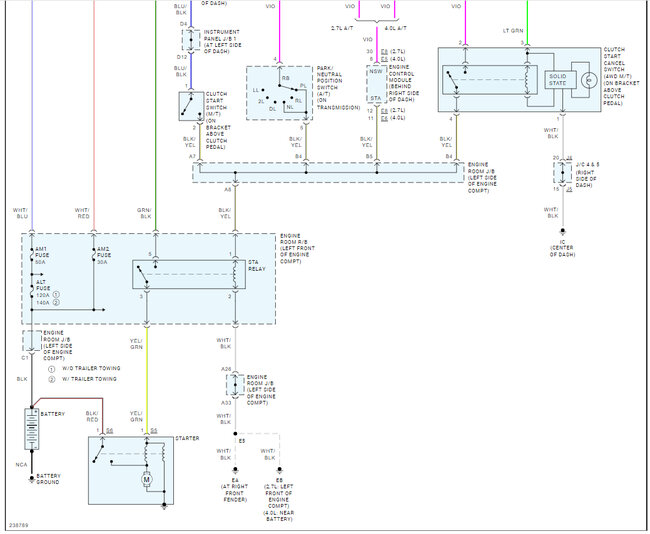

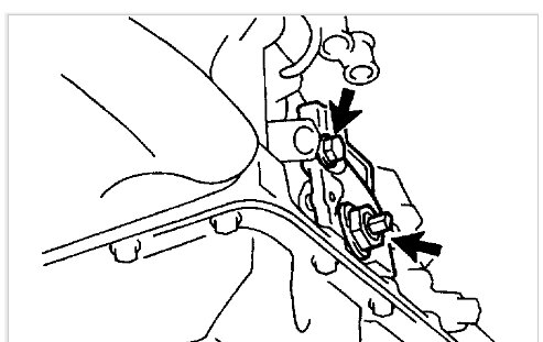

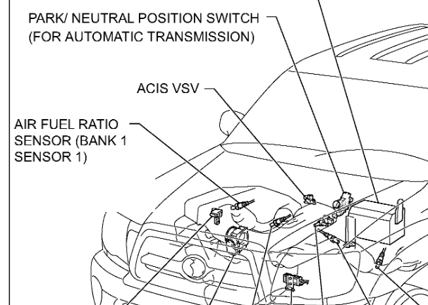

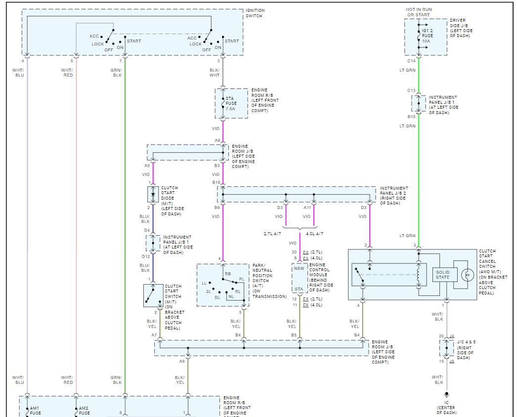

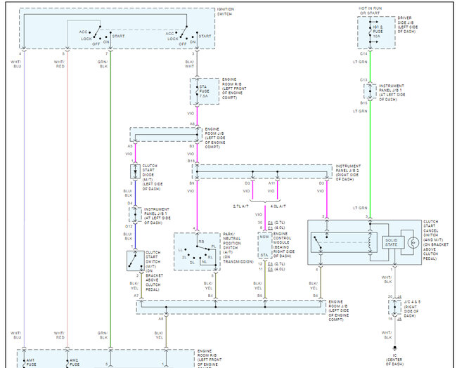

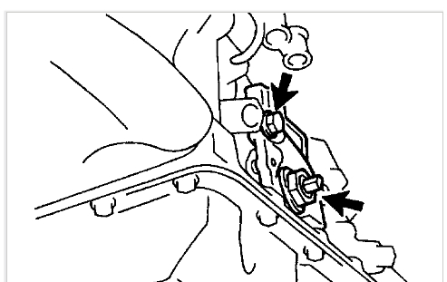

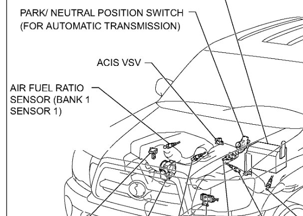

We can't tell you how to bypass the switch due to safety hazards, but you can look at these wiring diagrams to see how the system works. I would just replace the switch here is how. Check out the images (below). Let us know if you need anything else.

One more thing, can I get the wire diagram for my harness there's wires and how do I put the new range sensor in where do I set dial on sensor?
Jan 23, 2024 at 12:20 PM
You should be able to match it to the old one, they don't show me anything else. Can you upload an image of the problem you are having? That way I can see what's going on.

It only shows in and reverse but does not move forward or reverse there is a specific way I think how to put range sensor on. I had a po2174 pressure sensor d I replaced it. do you think I messed something up? my old range sensor is in pieces really hard to get off.
Jan 24, 2024 at 10:17 AM
ROBERT JAMES TEMPLE
  • 15 POSTS
I am able to start it using a jumper wire on relay but still moves nowhere.
Jan 24, 2024 at 10:18 AM
The engine computer needs to see what gear the truck is in for the transmission to work.
