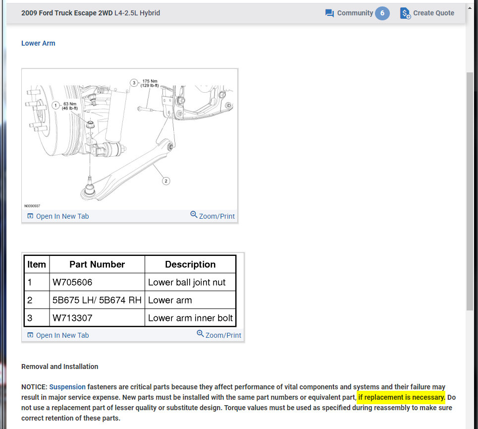

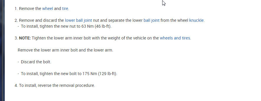

As for the sizes of the nuts and bolts, we don't have the sizes in the manual that we have so your best bet to find these is to check with the dealer and they can actually look up the part numbers of the bolts.
However, I attached the process below of the lower control arm and as you will see on the first attachment it says that you must use the correct bolts "if replacement is necessary" so i is not something that must be replaced.
Let us know if you have other questions and sorry we don't have this level of detail in the manual.
