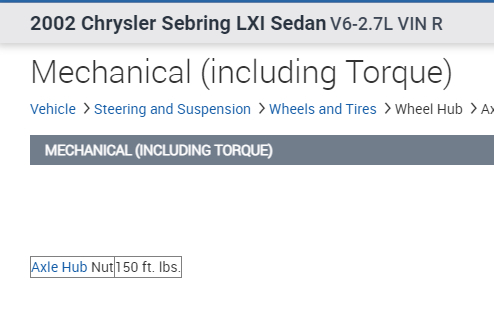

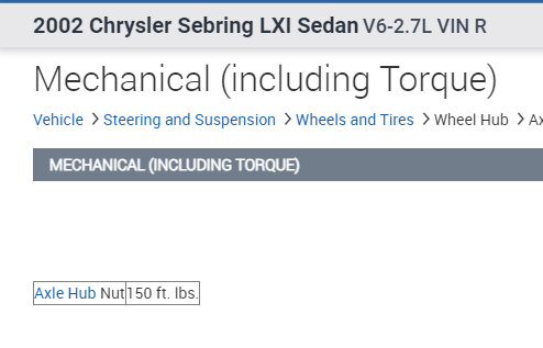

That is a tough question to answer because they used different ones. Also, when replaced, the new ones are usually different.
The manual only provides the torque specifications, which I attached below. As far as the nut size is concerned, it is going to be approximately 32mm.
Let me know if that helps.
See pic below.
