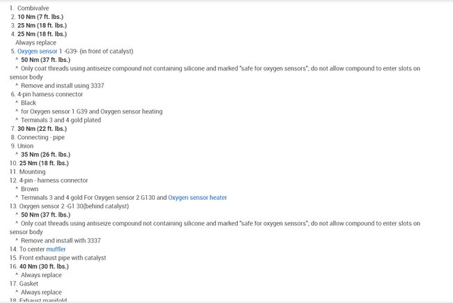

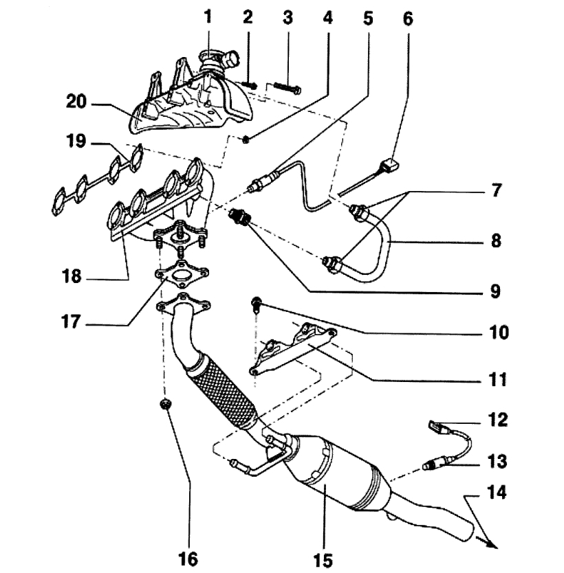

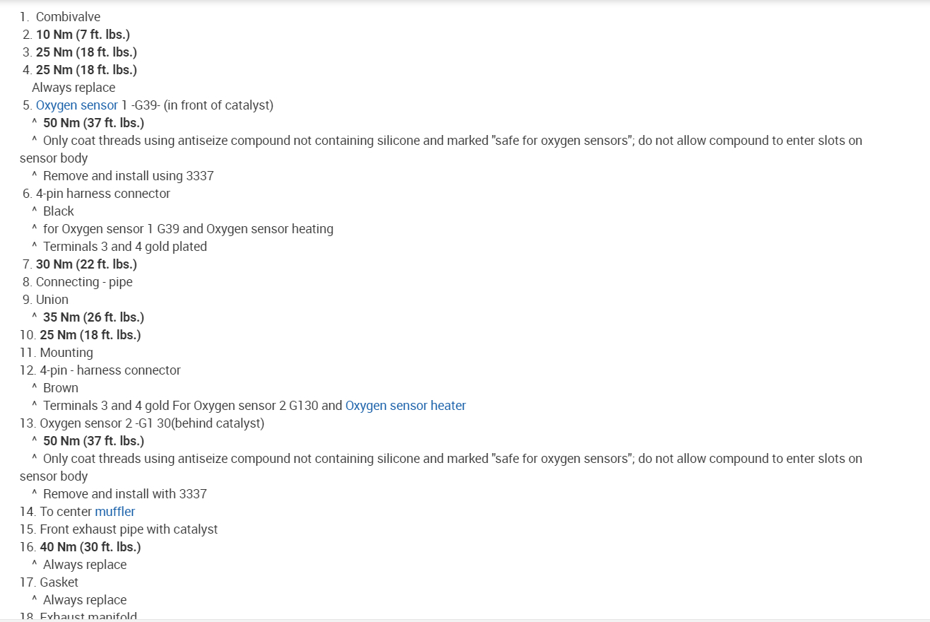

I believe it is a 17mm, but they can change, here is a video of the job being done on a similar car and I have included the instructions on how to change the catalytic converter out int he diagrams below.
https://youtu.be/1Hh12_mWw8k
Check out the diagrams (below). Please let us know if you need anything else to get the problem fixed.
