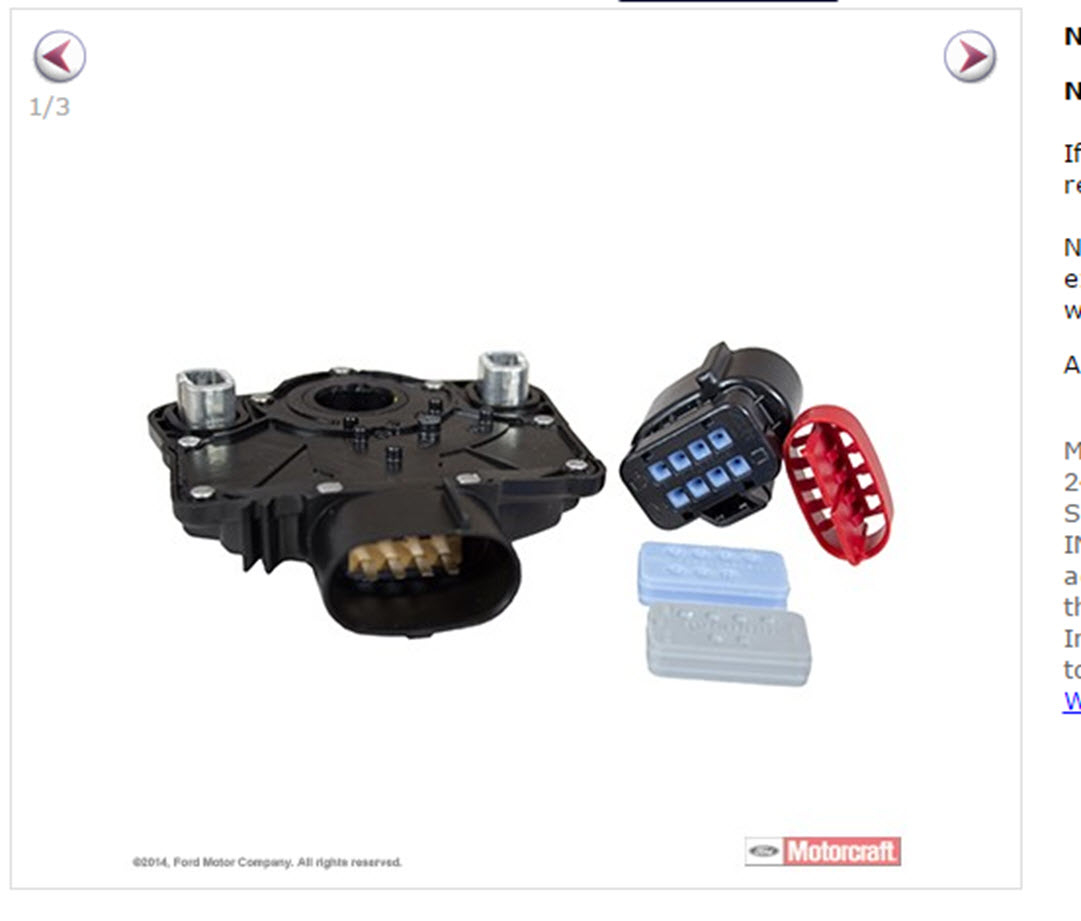

The neutral safety switch for my C6 transmission and no overdrive is apparently discontinued and more rare than a unicorn. I have called all over the country trying to find the part with no luck. Every specialty parts dealer, local Ford shops, online sellers, junkyards have all come up empty.
Do I have to bypass the switch somehow? My pigtail on the wiring harness has six connectors, everything I have found has four.

if i am not mistaken a Bronco is the same as a pickup for parts mostly. I looked on rock auto and found this , its a Motorcraft part and looks to be a replacement with an adapter. i am sure there will be instructions with it.

RHINO99
My connection end is round. I checked the rock auto site.
At least the one pictures will accept six wires.
but I would have to cut the 'male' connector and try to get the wires to marry to this switch.

HMAC300
  • 48,601 POSTS
that is why they have the adapters. according to wire diagram is because a C6 is not the standard transmission it shows E40d as transmission and from what I can see it only takes red wire and black/white wire for other than E40D.

RHINO99
Thank you for the replies and help!
So you are suggesting to splice the wires into the adapter. The next problem would be that the wiring harness (female) that comes off of the solenoid is likely going to be several inches short of reaching this adapter without the mail pigtail.

HMAC300
  • 48,601 POSTS
then you will have to splice in longer wires so it can fit. But this truck is supposed to have a E40d not a C6.
