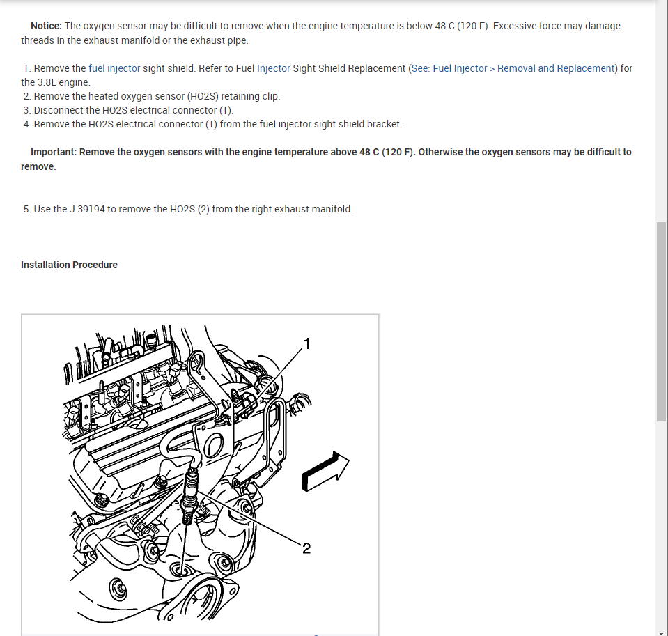

Can you help me change the oxygen sensor out please?

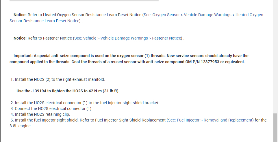

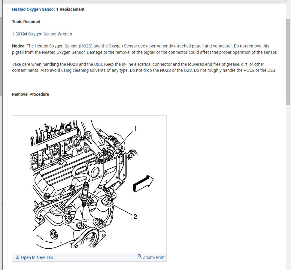

I am attaching the guides below that will help with step by step instructions that will help with this. Also, there is a guide on testing o2 sensors in case you need that as well.
