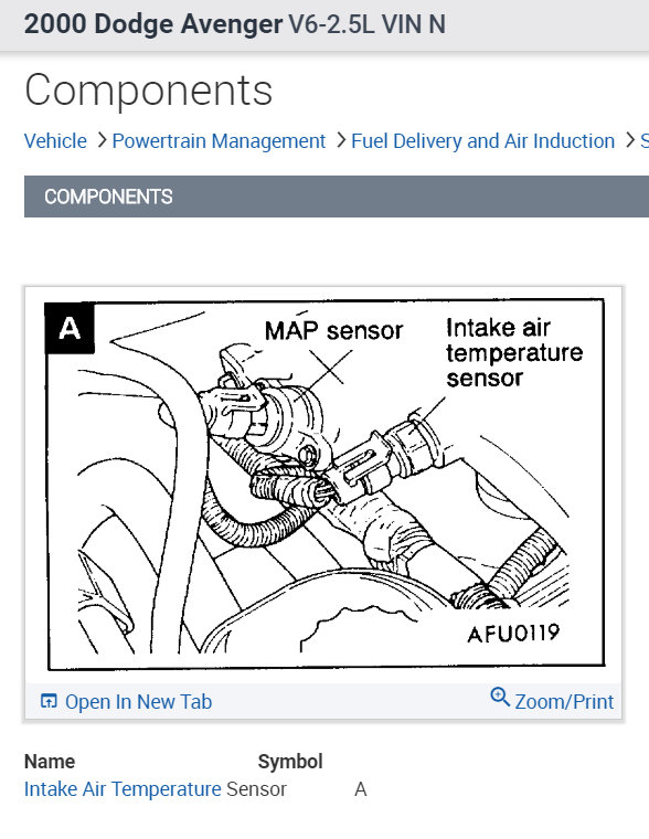

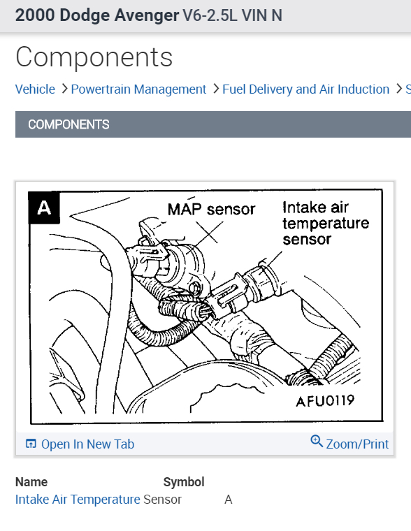

Ken. I changed plugs and wires. Was not the solution. What do you think about the vehicle speed sensor casing the problem?
Dec 21, 2018 at 1:43 AM
CERTIFIED EXPERT
53,854 POSTS

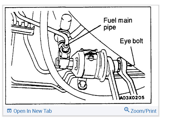

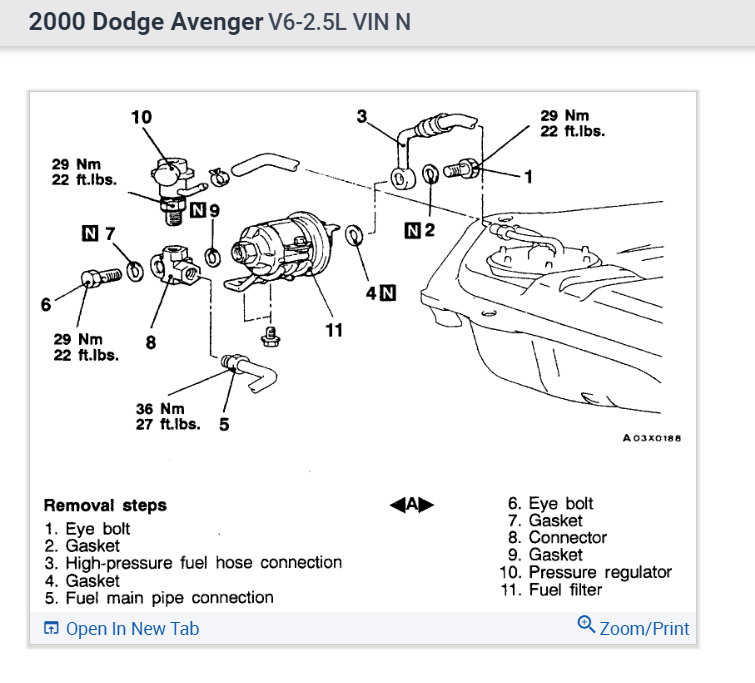

It would through a code if the sensor was causing problems. It sounds like the MAP or clogged fuel filter. If the MAP becomes weak it will give a false reading to the computer without setting a code. Here are the locations for both below with a guide to walk you through the filter change:
