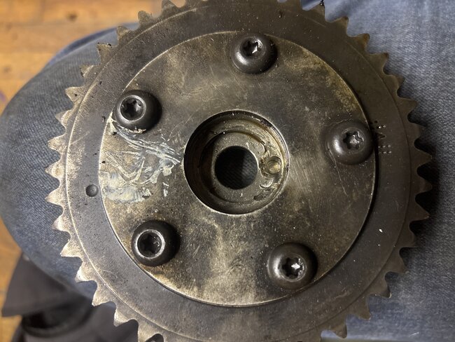

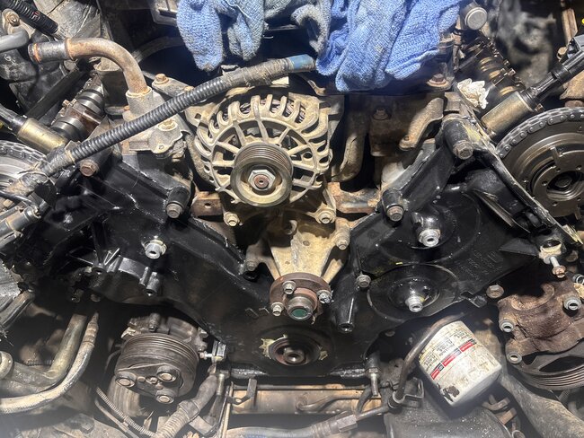

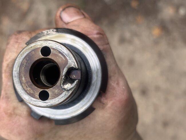

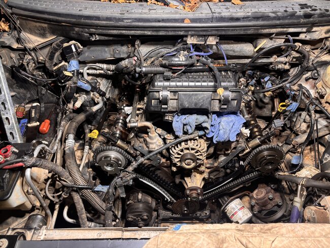

So, about a year ago, truck started making a bad timing chain noise, I parked it, took everything off, sure enough my chain guide on the right side broke, so I replaced cam phasers, chains, tensioners, crankshaft sprocket and gaskets. It drove ok for a while then it started making the noise again one day on my way to work so I tried easing it very slow (maybe 5mph) just trying to get it to my job, well about a half mile from my job, it shut off. Called my brother, who’s a mechanic, he came, put his scanner tool on it and it showed the whole right (passenger) side had no compression. So we towed it home, pulled everything off again and once again the passenger side guide was broke and my cam phaser, the three little pins in the middle broke, so I ordered and new one from Ford, took the old phaser off and seen that the roller pin on the back of the cam phaser sheared the heck out of the slot on my cam shaft. So, I took my camshaft off. Well, I didn’t set the timing before I too the old phaser off and the camshaft…. What do I do? Or how do I know what position to lay the new camshaft in when I install the new one?
