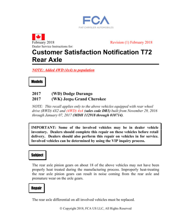

I drive the vehicle listed above r/t 5.7 liter awd. When shifting from reverse or drive I hear a loud clunk.
Aug 15, 2022 at 6:17 AM

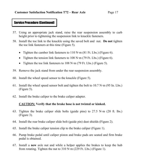

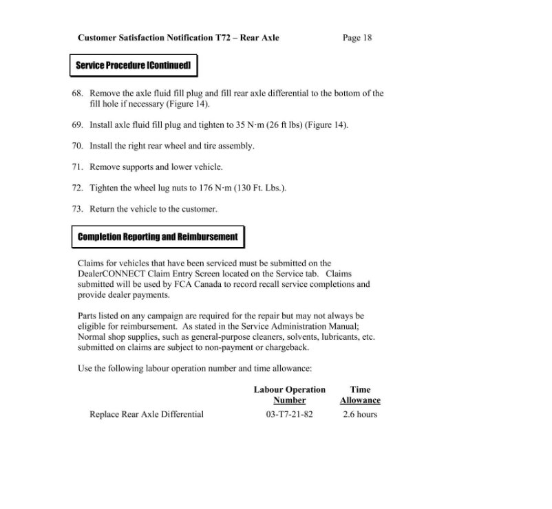

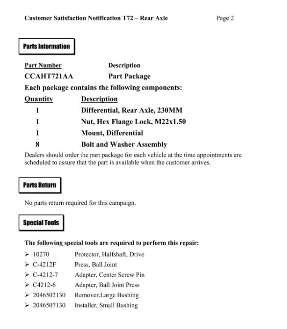

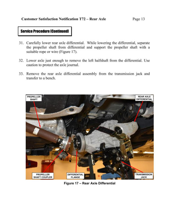

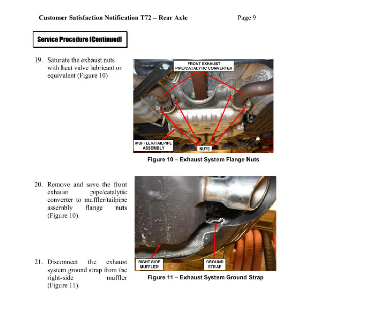

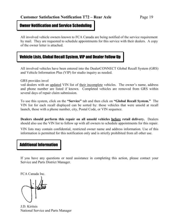

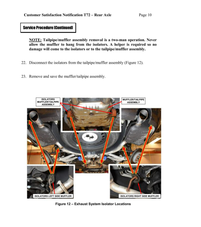

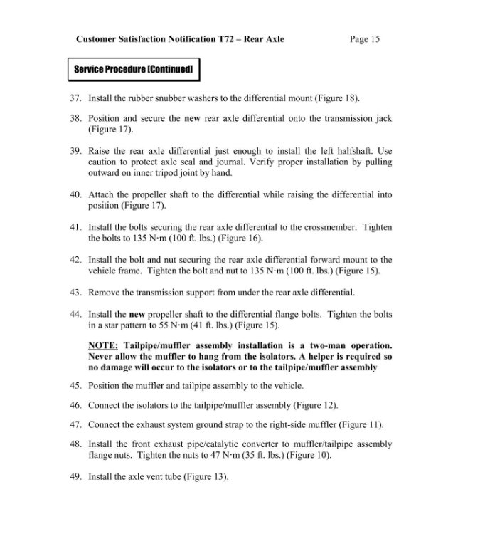

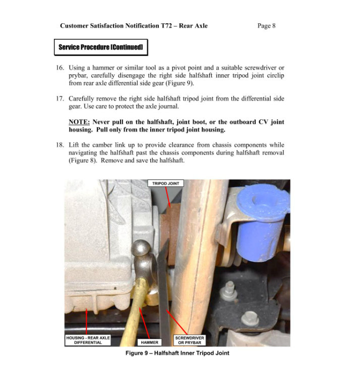

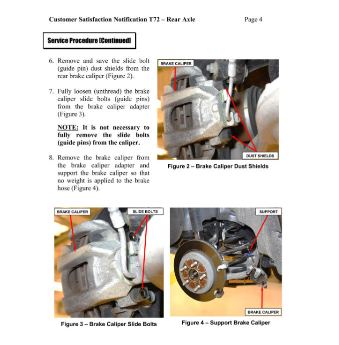

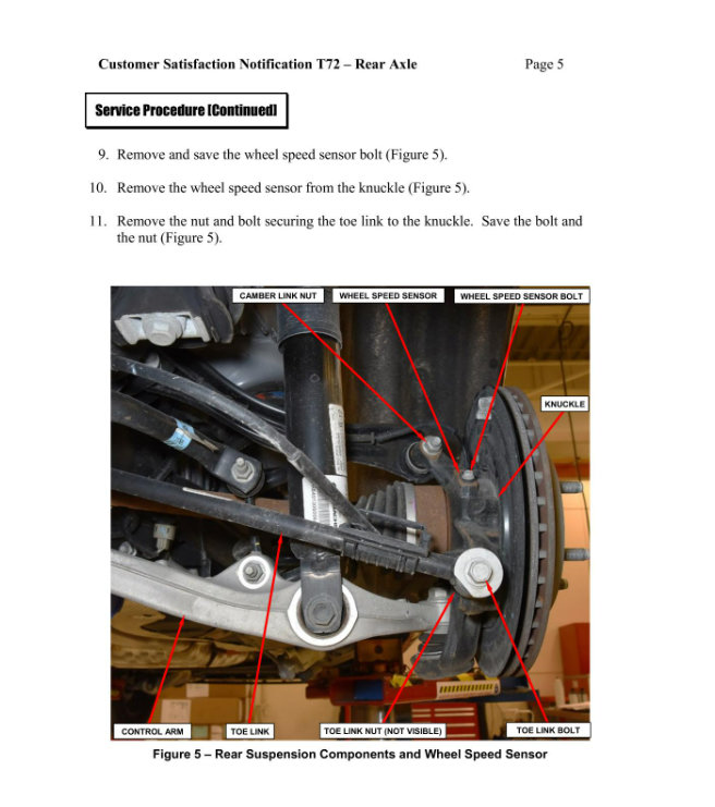

We are going to locate the origin of the noise, front, back or middle of the vehicle. The unusual suspects are the driveshaft, rear differential or transfer case. There is a 19 page TSB that shows they had a problem with the rear differential and the bushing that mount the differential which I have found and are in the images below. Check out the diagrams (below). Let us know what happens and please upload pictures or videos of the problem.
