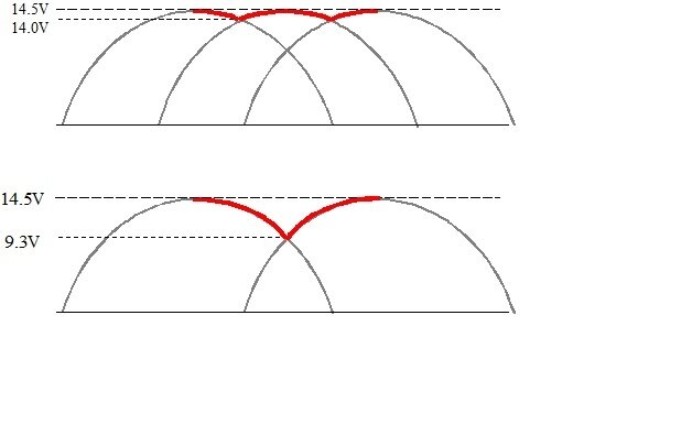

"Ripple" voltage refers to the unsteady output voltage, as shown in my first drawing. This generator will develop up to 90 amps with all good diodes, and ripple voltage for this example is shown as 0.5 volts, (red section). Below that, one phase is missing. Here again, the red section shows the output voltage that will be developed. Ripple voltage is 5.2 volts.
Professional load testers test charging systems on the car by measuring maximum output current and ripple voltage. Both are indications as to the condition of the diodes. A few testers that can make paper printouts will list an actual voltage for ripple voltage, but most testers just show it on a relative bar chart as "low" or "high".
The bottom line is bench testers don't measure ripple voltage and they aren't strong enough to drive a generator to its full output current capacity, so they can't show if the diodes are all good or not. This goes back to which way a voltage regulator works. Some will look at the low points in the output voltage, (9.3 volts in the lower drawing), and respond by bumping up the charging voltage. Some will look at the highest point, (14.5 volts), and cut back on generator output, often, again, to the point of stalling.

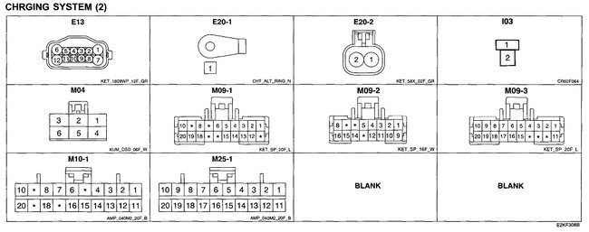

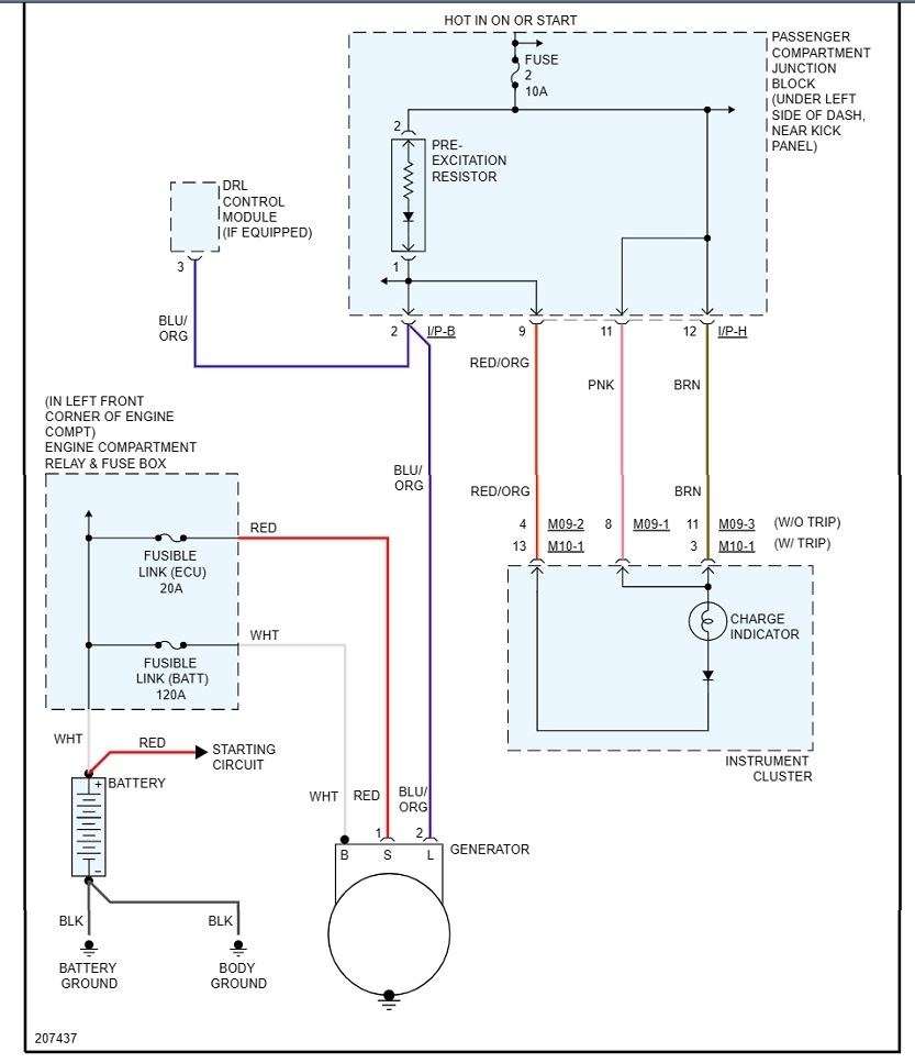

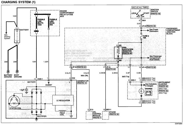

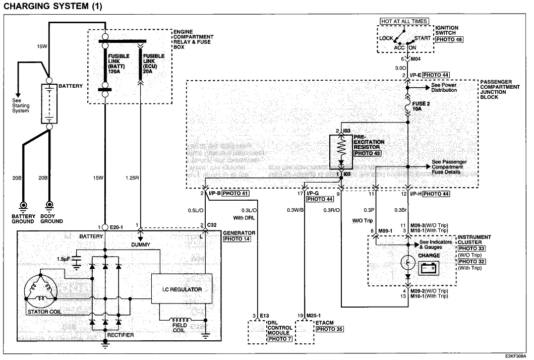

If you can read this diagram, I'm guessing you know how to use a digital voltmeter, but for the benefit of others researching this topic, this article explains it better:
They're using an "auto-ranging" meter which is an expensive feature that isn't needed. You can find a perfectly fine meter at Harbor Freight Tools for around $7.00. Also look at Walmart or any hardware store. I can help with setting it up if necessary.

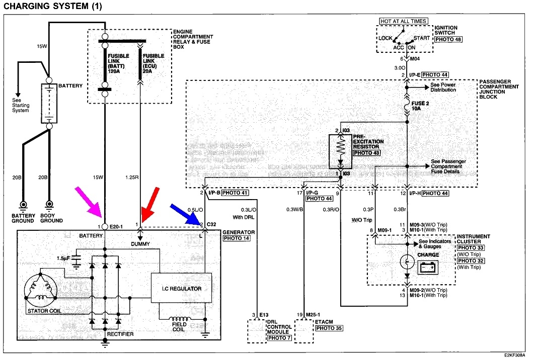

The first step in diagnosing this system is to observe if the "Battery" warning light on the instrument cluster turns on when the ignition switch is turned to "run". If it does not, the blue / orange wire likely has a break. Next, measure the voltage on that wire at the generator's plug, (blue arrow in the third diagram). To be valid, these next two readings must be taken with the connector plugged in. Back-probe alongside the wires to take the readings. Expect to find very close to 2.0 volts. That says the warning light will be on, that wire doesn't have a break in it, that wire's connector terminal where you're measuring is making a good contact, and that wire is not shorted to ground. That is the turn-on circuit that wakes up the voltage regulator to get it started.
Measure next on the red wire, (red arrow). That one must have full battery voltage all the time. This circuit supplies the current that runs the voltage regulator, feeds the electromagnetic "field" coil, and is where system voltage is monitored.
The last wire is the fat output wire that's bolted to the back of the generator, (pink arrow). That one also must have full battery voltage all the time. If you find 0 volts there, the large 120-amp fuse link is burned open. The two common causes of that are a metal tool touched it and something metal on the engine at the same time, or a defective generator had two or more shorted internal "diodes" that created a dead short.
Let me know how far you get with these tests, then we'll figure out where to go next.

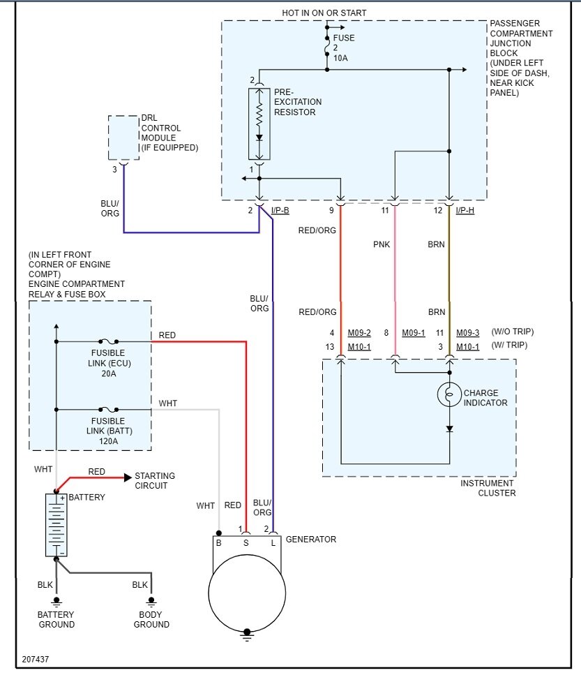

Here's another version of the charging system diagram. If any of these are too hard to read, you can copy them into a typing program such as MS Word where they can be expanded, or I can cut them into smaller pieces, then expand them for you.

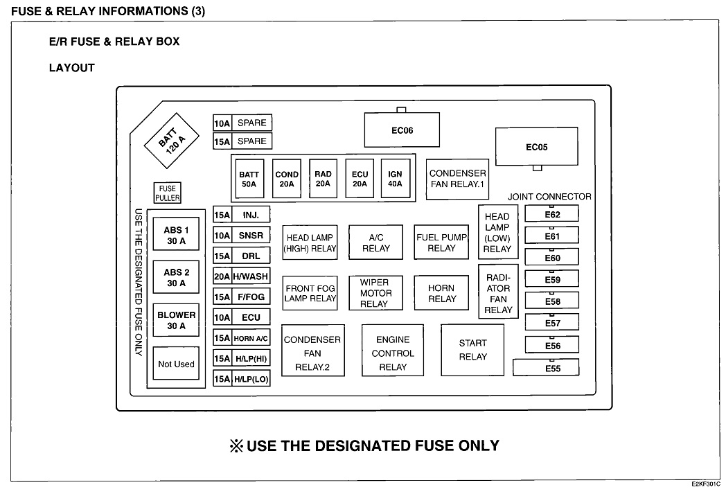

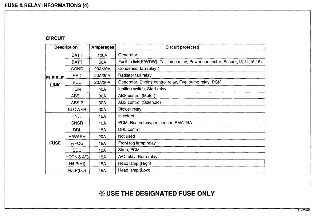

The problem was the alternator fuse that was fixed but now the headlights and everything in the inside of the car doesn't work now but it was working before the alternator fuse was changed.
Mar 8, 2023 at 10:40 AM
CARADIODOC
  • 34,306 POSTS

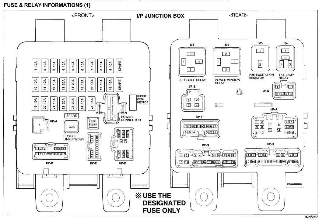

The two are very likely not related, but what is pretty common is for multiple fuses to blow for no reason when connecting the battery or when connecting jumper cables. That is due to the in-rush of current to charge the memory circuits in the dozens of computers. It's even not unheard of to have five or six blown fuses. This is less likely to happen to the large cartridge fuses. You have to rely on a visual inspection to find those. The smaller fuses are the ones to suspect. Most have two tiny holes on top for test points. Test lights work best for finding those that are blown:
This article does a dandy job of showing how this is done so you don't have to pull each one to inspect them:
What you're looking for is any fuse where the test light is bright on one test point and off on the other one. If it's bright, meaning you have 12 volts, on both test points, that fuse is okay. If the light is off on both test points, that circuit is not turned on. You may have to turn on the head light switch, heater fan, and things like that when checking those fuses.
Let me know how this turns out.
