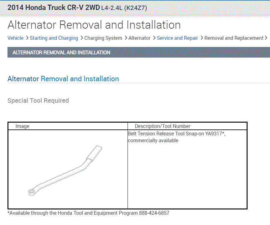

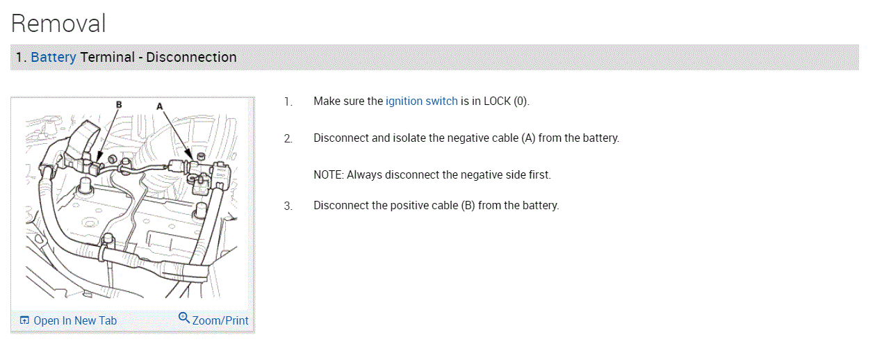

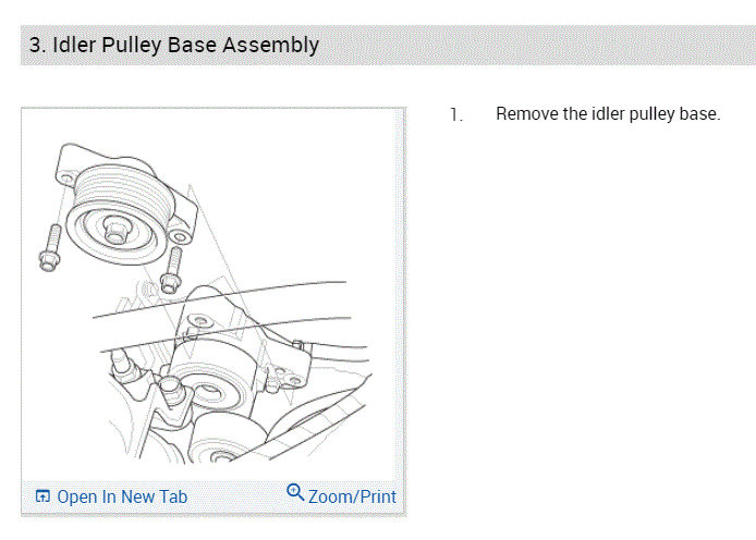

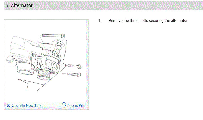

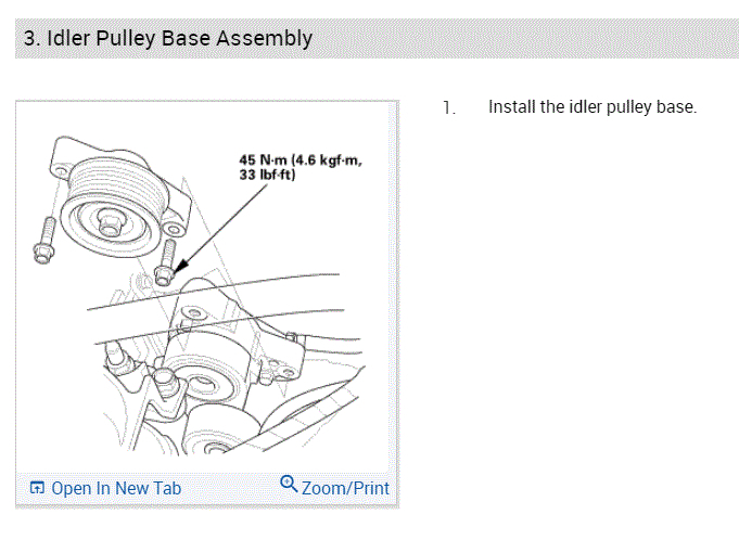

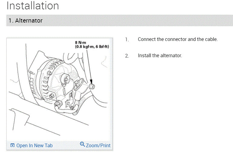

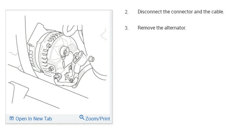

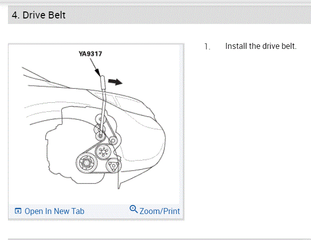

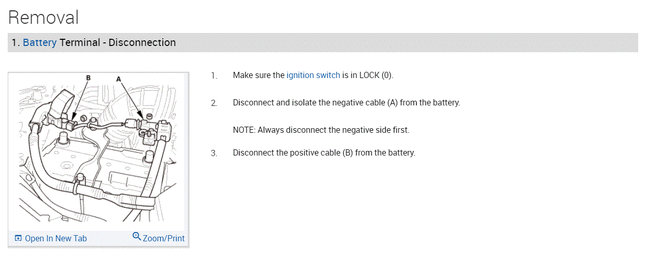

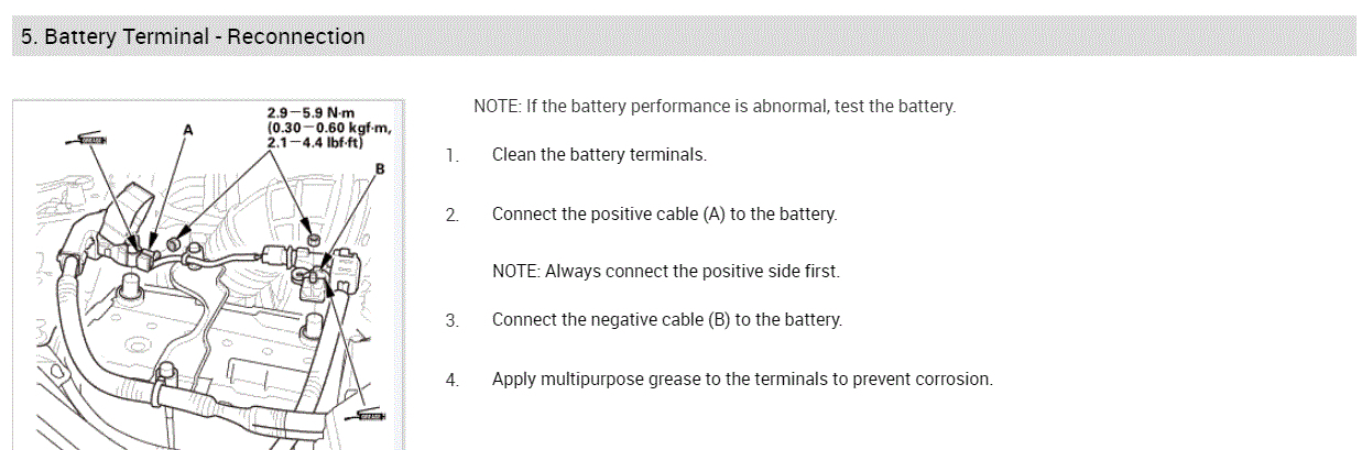

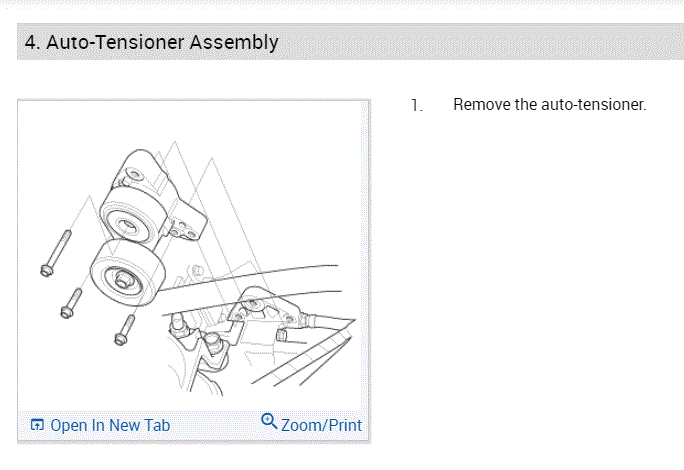

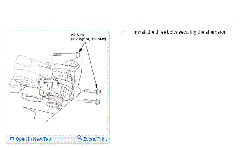

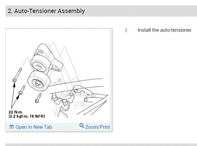

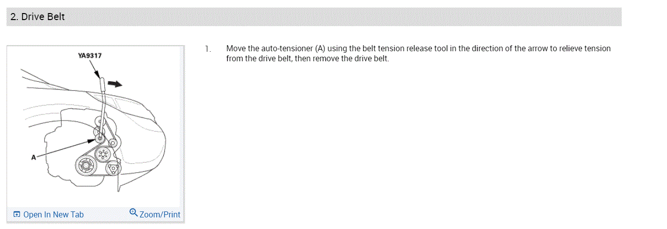

Also, I attached replacement directions specific to your vehicle below.
Let me know what you find or if you have questions.
See pics below.
