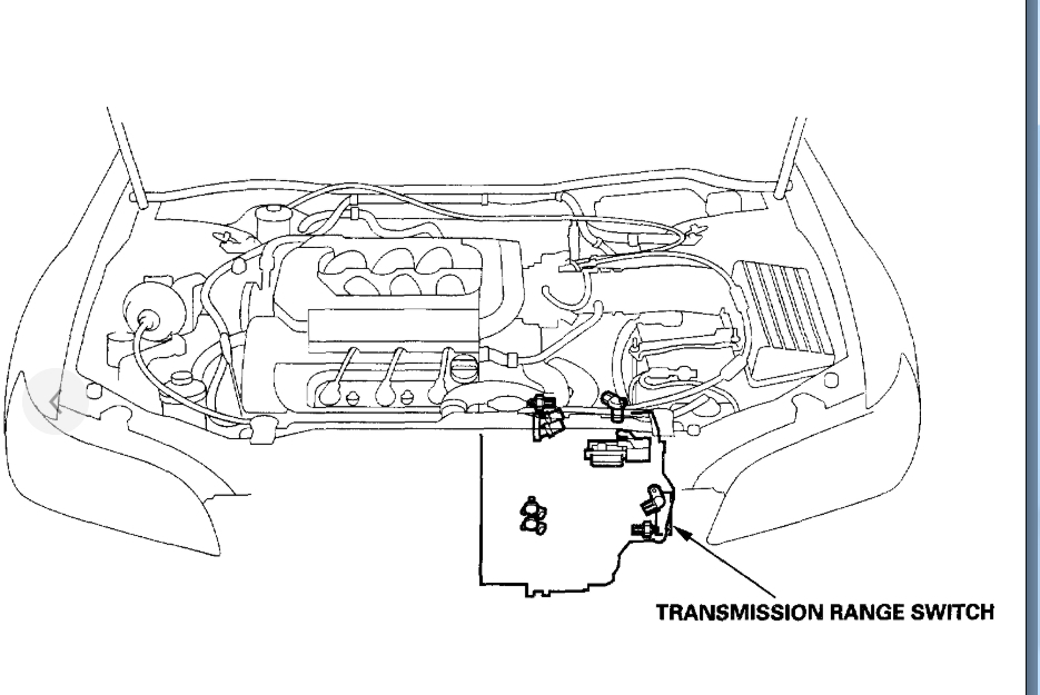

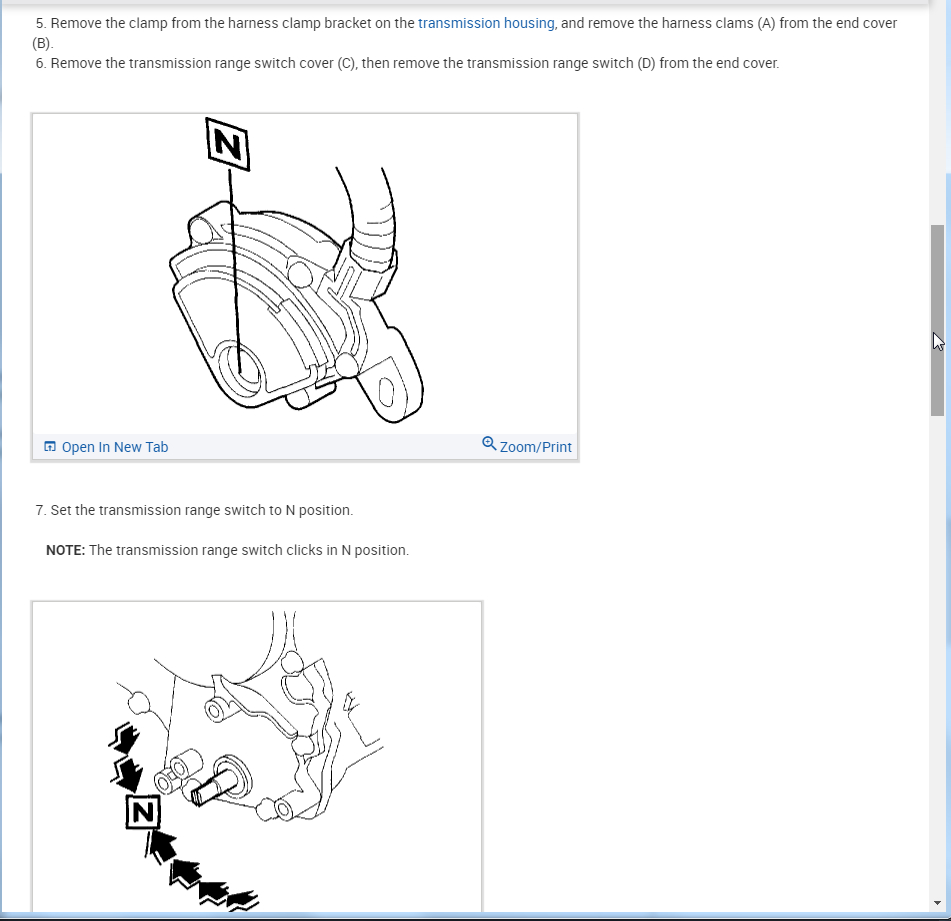

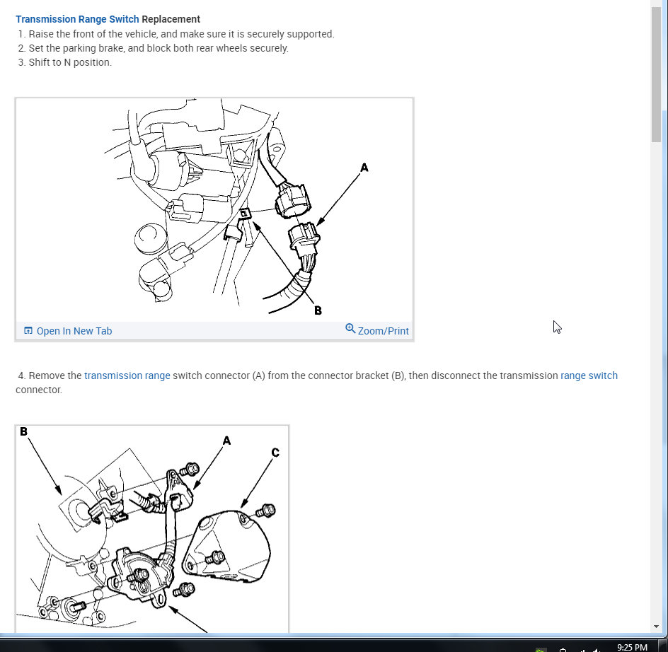

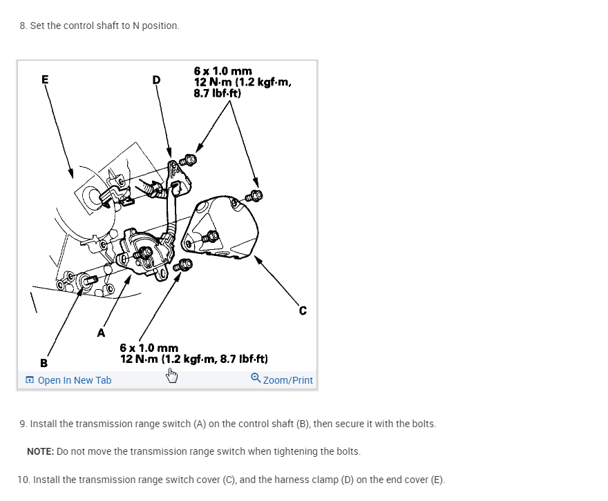

you will need to check the neutral safety switch it's mounted on the transmission where your manual shifting the transmission at the end of the shift cable. You may have pulled the wiring connector loose or might need to try and realign it. if that doesn't work you may have to replace it so it will start in neutral and park.

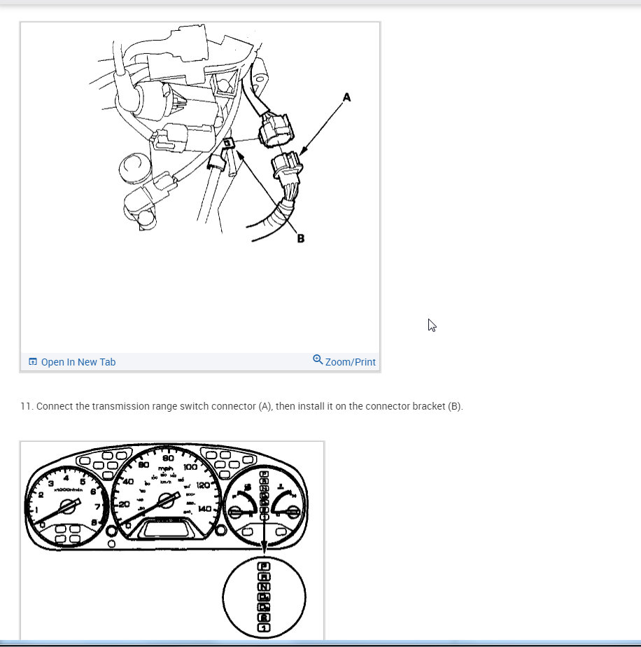

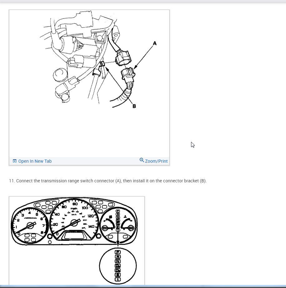

As it turns out a couple things of concern... first either my memory or the memory of the gentleman who was helping me get started reveals a bit of a lapse - critical albeit... lol... one of us dion nectar two electrical plugs on driver's side of dash (behind a pear shaped panel wherein electrical on nectar and fuses are located). Once I made that discovery and performed the subsequent reconnecting of said cables all was right with the Honda world... dash indicators worked, car started and ran!
However, the second issue is of greater concern... in the process of diagnosing the issue a check of the transmission end of the shift cable (again a V6 3.0 w-another 4 speed transmission) confirmed my recollection that the cable was completely mechanical. No electronic sensing device present. My assumption at that point was the position sensing device must be in the passenger compartment attached in some fashion to the shifter/cable.
I reviewed parts listing for a Honda 2000 Accord V6 auto transmission and sure enough the only part listing I could find showed it to be located -as you indicated - at the end of the cable beneath a cover fastened to transmission by three bolts... hmm....
further review of online info including YouTube video revealed same thing you described...
For the record what do you think is going on? We have owned the car for 10 years no wrecks no engine/transmission changes. Why the obvious radical difference -admittedly the car is and was functioning properly... mid-year change over? I can't find reference to it anywhere.

- in event D4 indicator is flashing that is the equivalent of the "check engine" warning indicator - in this case either open circuit - connector unplugged OR as I believe is also possibly true, flashing may also indicate position sensor detects a 'miss-aligned' sensor (incorrectly replaced on shafts not corresponding to ECU/TCS expectations) need to remove & remount so position indicator reflect transmission gear shaft's actual position.

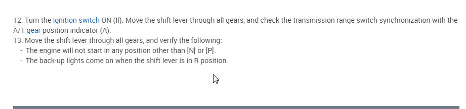

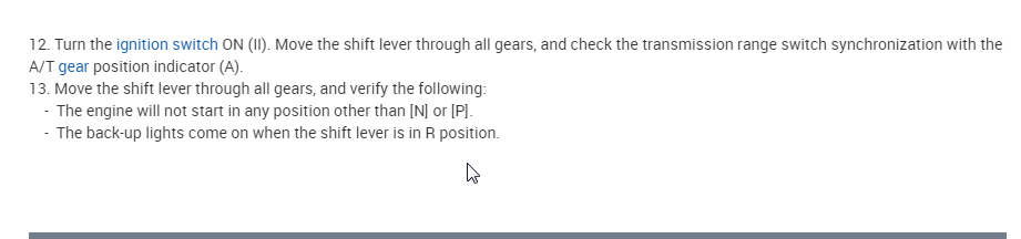

This issue is caused by what is called the transmission range sensor. Basically it tells the PCM that the vehicle is in park or neutral and is okay to start. When this is not hooked up or not giving a good signal then the car will not start and the P and N will not light up.
I would suggest you go back and double check your work to make sure this is not unhooked. If it is not then we need replace it and then retest the issue.
