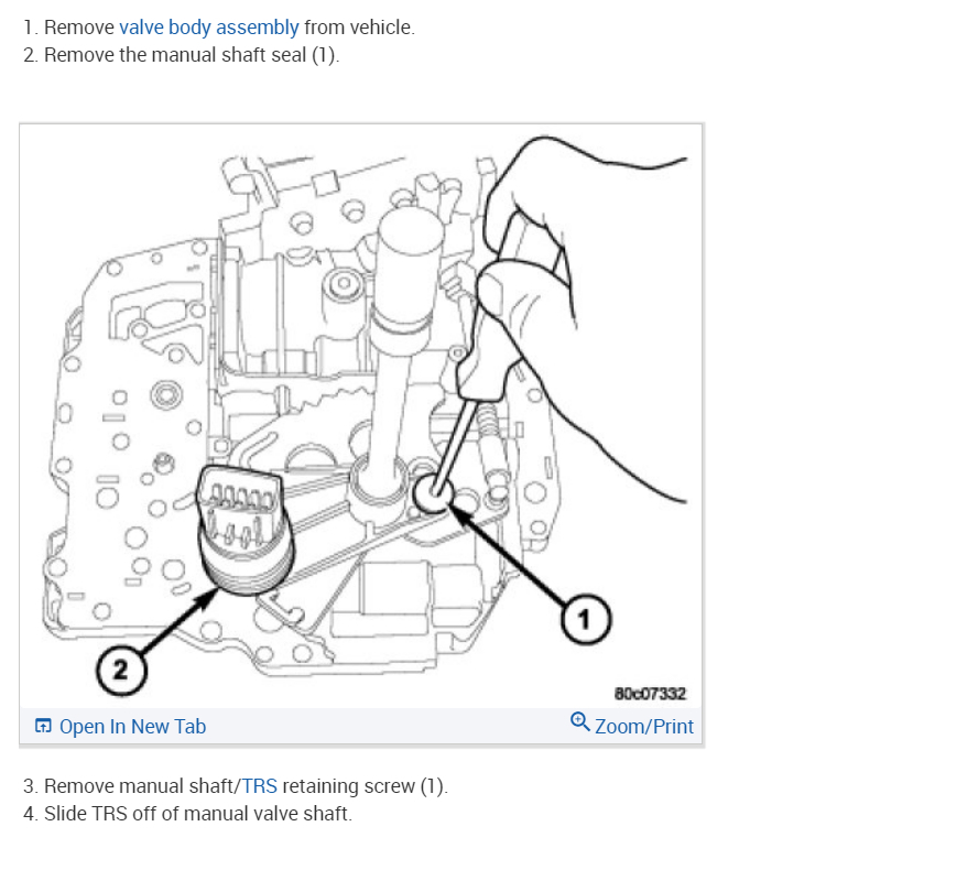

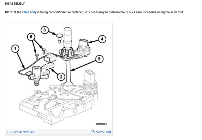

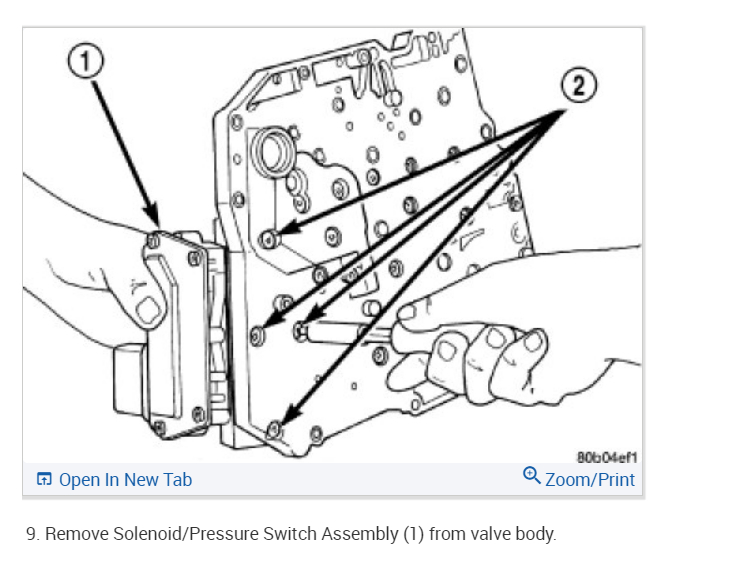

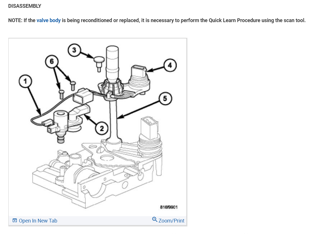

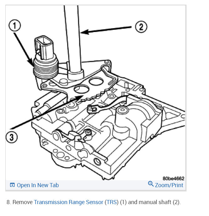

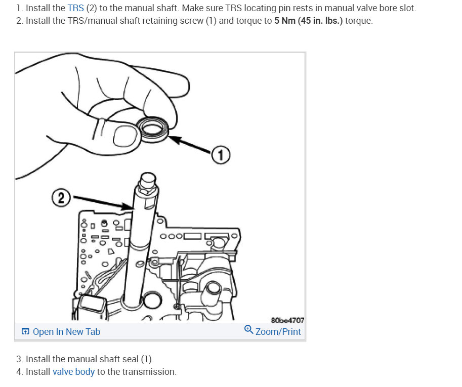

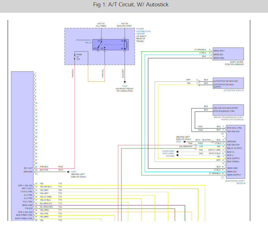

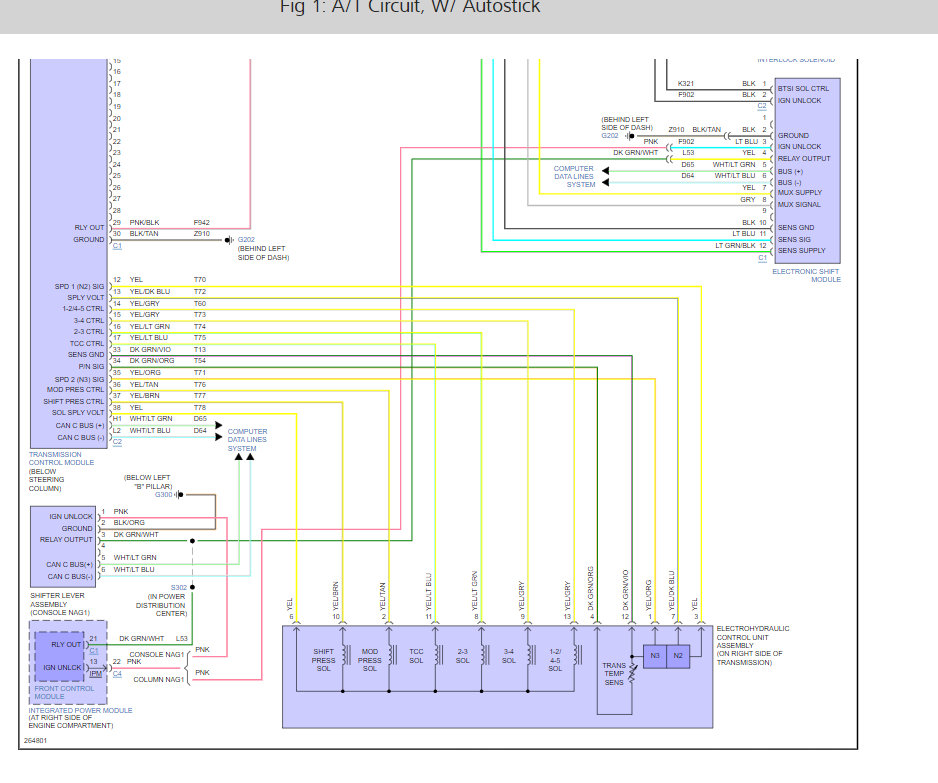

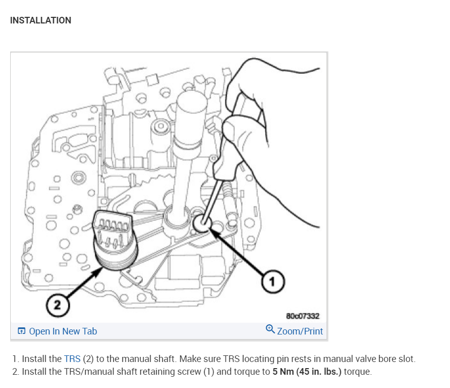

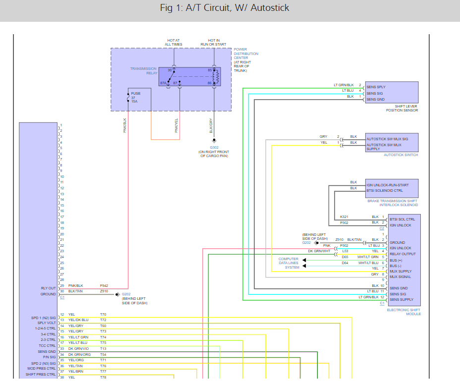

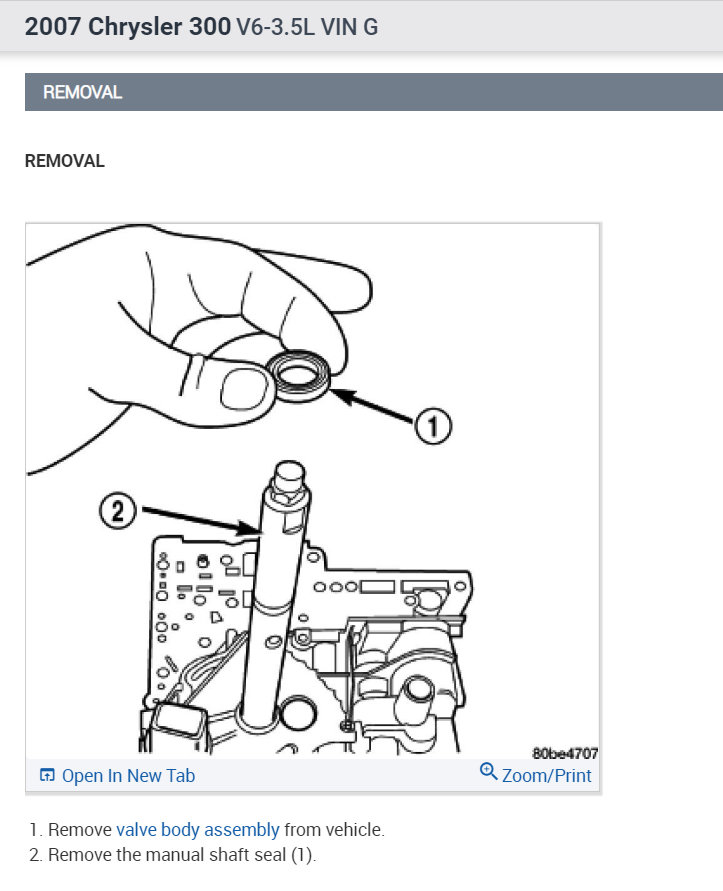

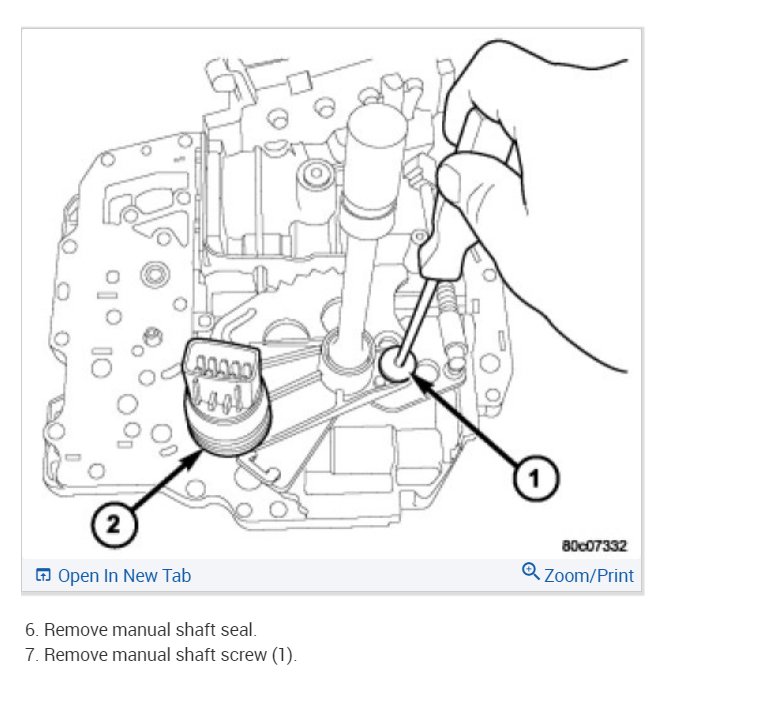

It sounds like the gear range sensor may be going bad or the fuse # 37 in the fuse panel in the trunk is blown. If the fuse is good, we should run the codes these guides will help:
and
I have included the gear range sensor location and how to change it out also I found the shift lock wiring diagrams so you can see how the system works. Check the diagrams below and please get back to me.
