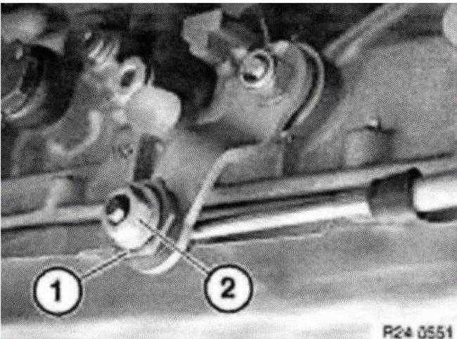

Next, make sure no transmission cooling lines were damaged, leaking, or pinched shut.
If that all looks good, check the shift linkage on the side of the transmission to see if there is any evidence of damage to that component. I attached a picture of what you are looking for.
