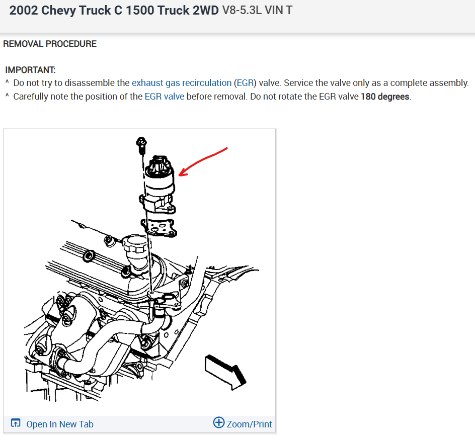

Trucks was running horribly, missing, not getting enough fuel, vacuum leaks, well fixed the vacuum leaks, changes out the MAP sensor, put new injectors, coil packs, spark plugs and wires, changed fuel filter also ran scan again cleared codes, trucks harder to start now than before I changed everything, turns over with key if foot is holding pedal down, shakes real bad then after 15-20 seconds RPMs go up and feels smooth as can be, let foot off the pedal stays idling but just barely, starting fluid changes nothing on idle spraying around to see if RPMs changes or not, and another scan afterwards no dtcs, foot on the gas blinking service engine light, foot off barely idle no engine light.
