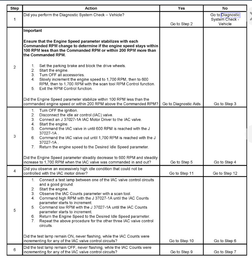

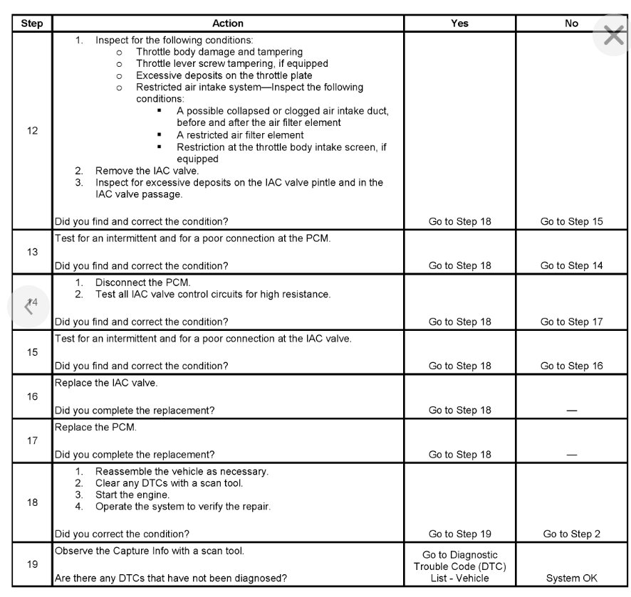

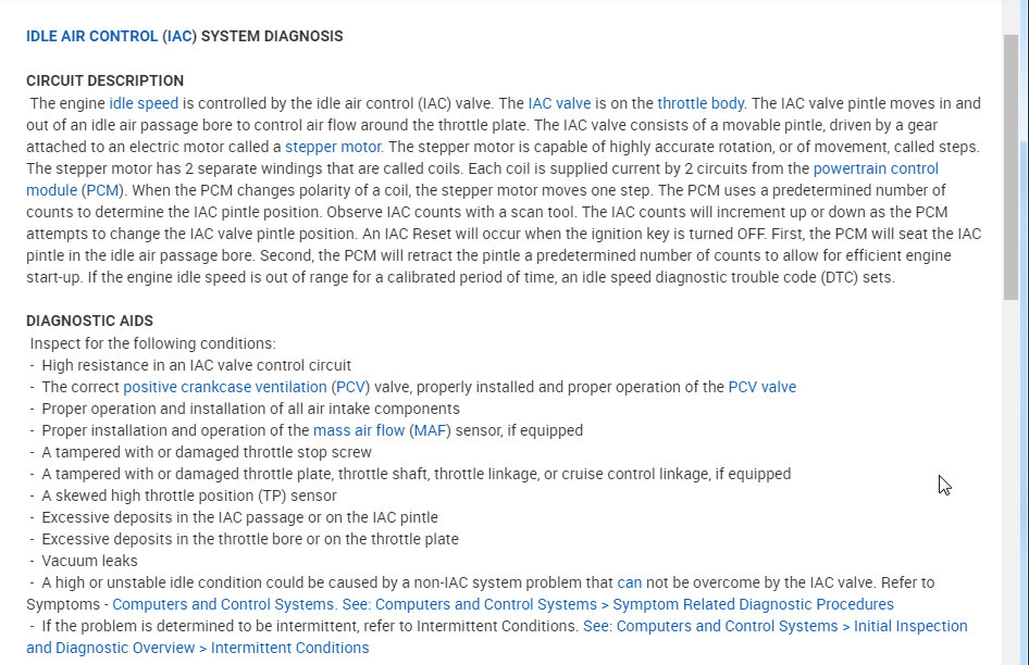

Is the idle smooth and steady at 600 RPM or is it rough? Is it just lower then it was or is there another issue? What did it use to idle at?

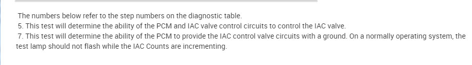

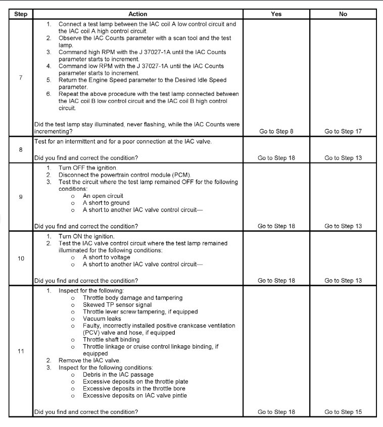

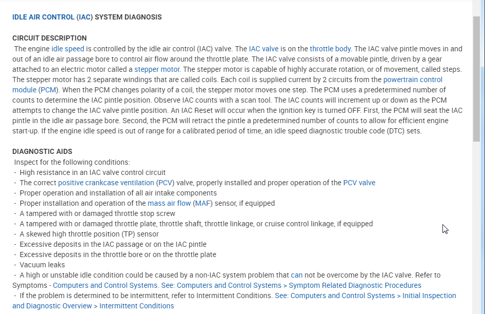

I attached the info and testing on the Idle Air Control which is what controls the idle speed.

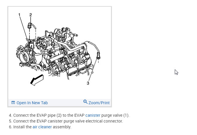

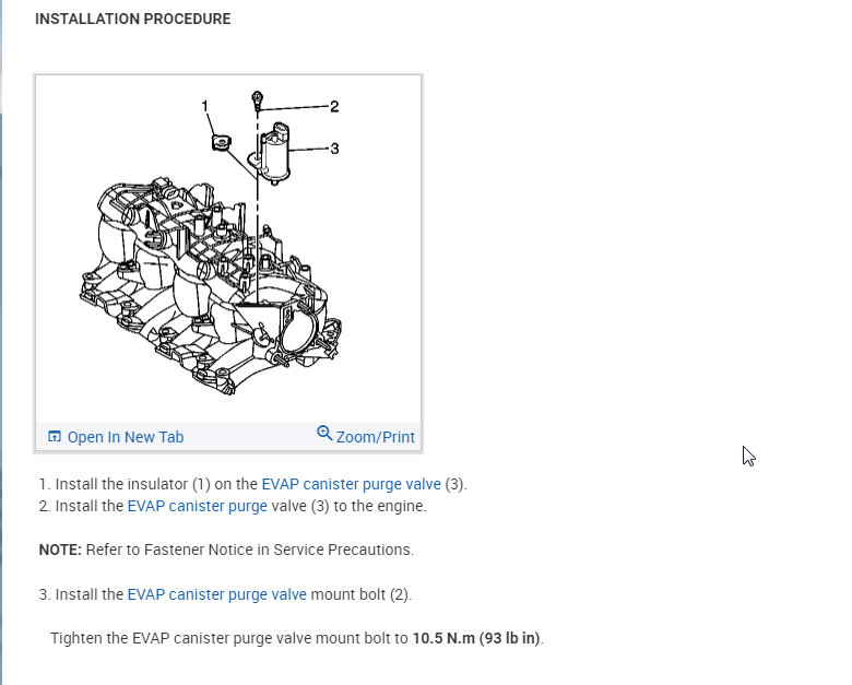

I attached the process for the purge solenoid and I don't see a gasket that needs to be installed so it is possible that was the issue.

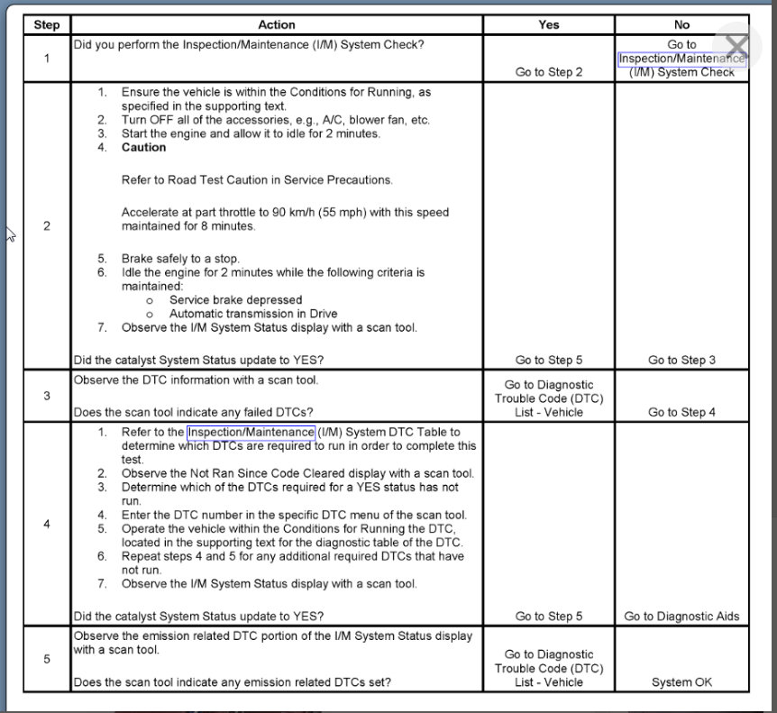

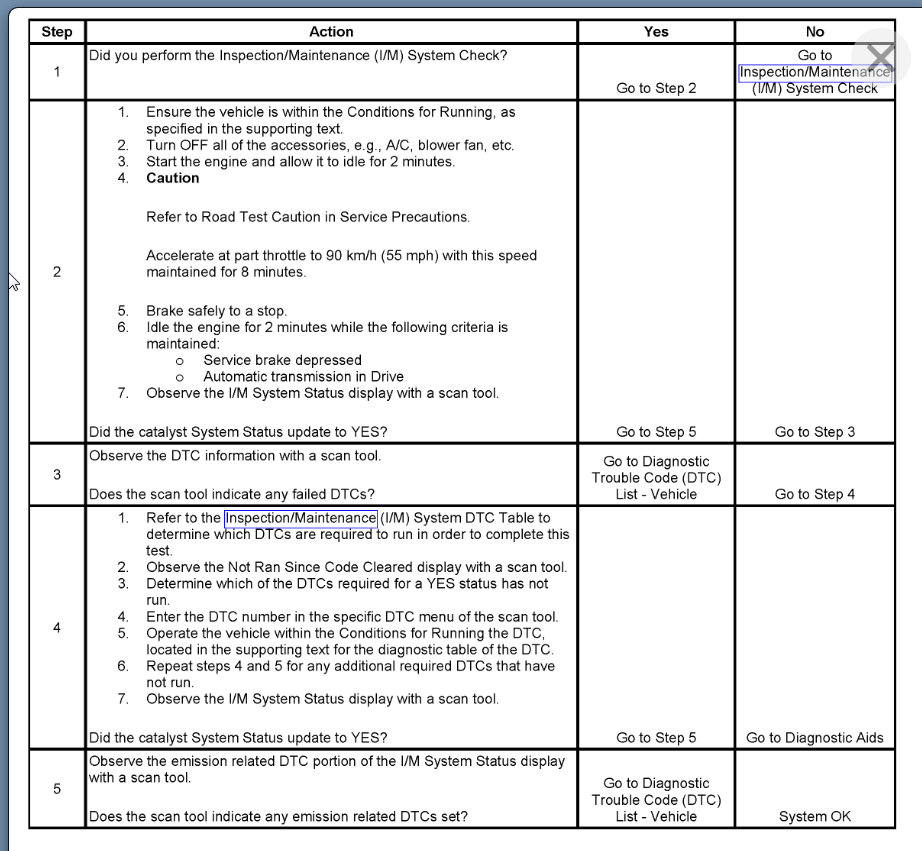

I attached the drive cycle that you need to follow in order to force the catalyst monitor to run. It is not the easiest to get to run so just read through the whole thing and then drive to an area that you can perform the entire thing before trying to start it.

Okay. This is what I was saying that this process of running at 3,000 RPM's for 3 minutes and then idling and shutting off is not the actual process.
If you want to force this monitor to run you need to do the following in this order. So if you can't do it in this order where you live, you need to drive somewhere that you can and shut the engine off and start the process.
1. Turn off all accessories, AC, blower fan, etc.
2. Start the engine and allow it to idle for 2 minutes.
3. Accelerate at part throttle to 55 mph and maintain 55 mph for 8 minutes.
4. Brake safely to a stop.
5. Idle the engine for 2 minutes leaving the engine in drive and the parking brake on.
At this point, the monitor should pass. If not, there is most likely a pending DTC that could be causing an issue.
Just want to stress that if you do what you said which is run the vehicle for 8 minutes, stop without the brake, and let is sit for 2 minutes with the service brake on is only part of the process. If you do it this way, it will not pass. It is only going to be forced to run if you follow the process step by step. See the attached for the actual document. The reason this is so critical is the PCM has been programmed to look for these steps to be followed in order to determine if the monitor passes or not.
