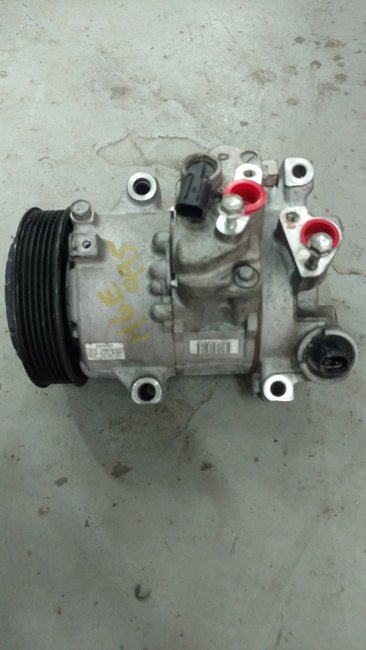

I have car made in Canada. I had replaced the AC compressor as mechanic told me compressor is not working.once replaced it was working for two months and then one day coming back from work it suddenly stop cooling. It is blowing the air but not cold.
I visited the mechanic again and he told me same thing that AC compressor not working again. I replaced the compressor and it works for two days and same problem happen it stop making cold air while on the way. My AC compressor has no mechanical clutch. Could you advise me what is the possible problem in my car AC system and how possibly I can fix it? Please

It sounds like you have a leak in the system. Please follow this guide to confirm
https://www.2carpros.com/articles/air-conditioner-leak-detection
Please run this test and get back to us we are interested to see what it is.

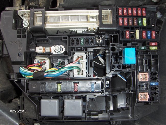

my car's air conditioner compressor turn on and off while driving. where is the relay of air condition is in the image? it is the image of my car fuse box?

the system you have the compressor is supposed to work like that so it does not freeze the evaporator that is quite normal.
