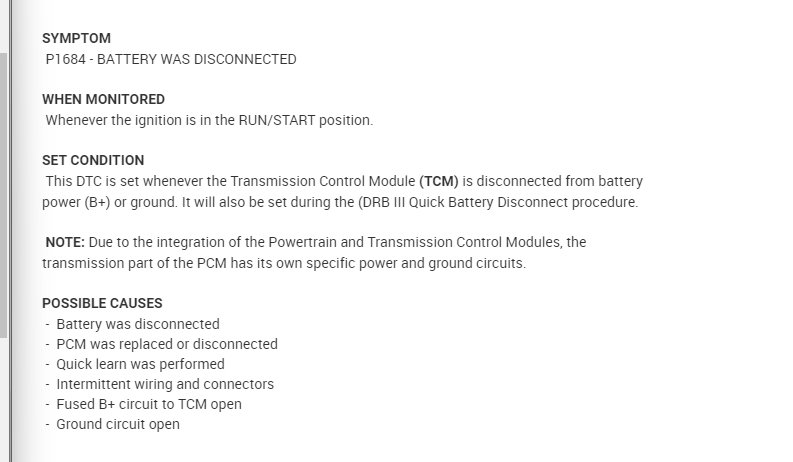

Then the P1684 is just telling you that you lost 12 volts to the TCM which is part of the PCM. However, the TCM portion has its own power and ground, so this is what was lost and not the power to the PCM portion.
This is important because it would cause issues but most likely not the loss of ignition.
