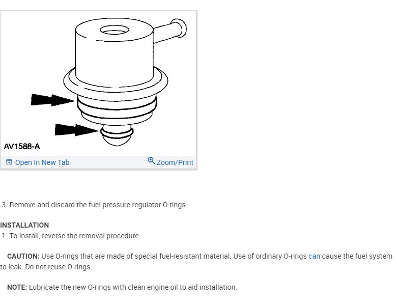

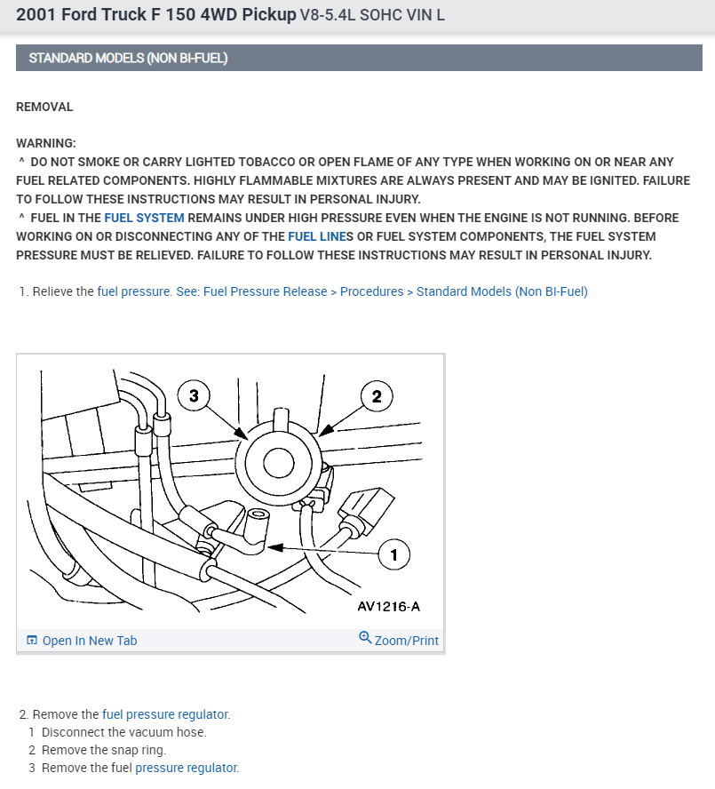

You can also check for fuel before the fuel pressure regulator. If there is fuel then it is probably a stuck regulator, if there is no fuel then the clog is on the line.
