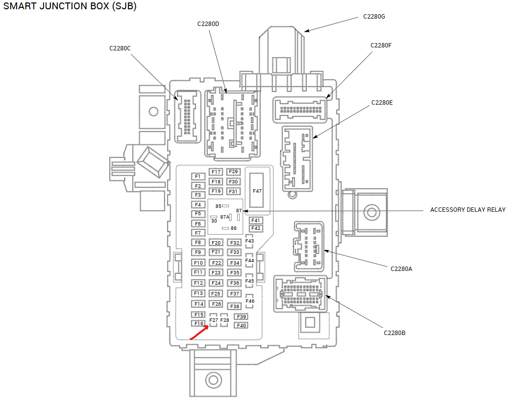

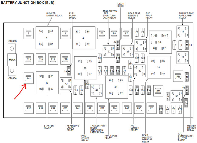

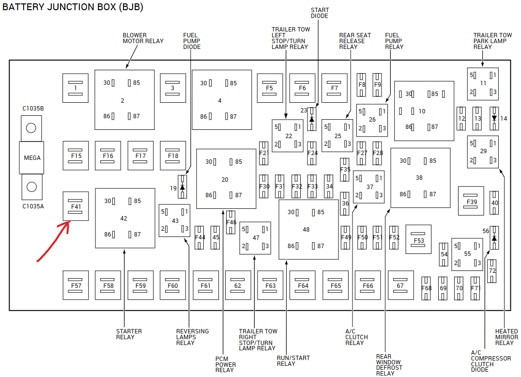

I would check the fuse #f27 in the smart junction box on the left side of the dash and fuse #f41 in the fuse panel under the hood. Here is a guide to help you:
