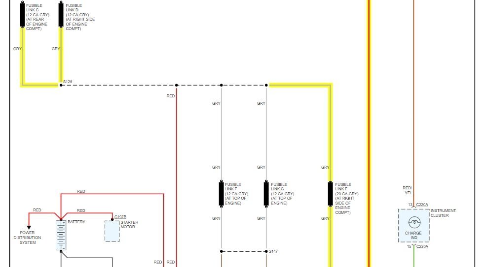

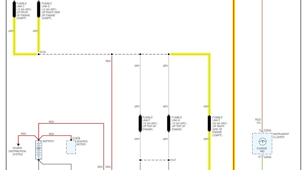

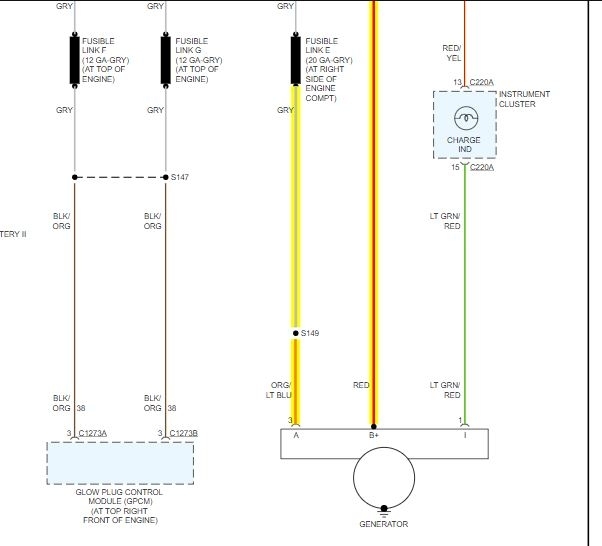

My batteries were draining overnight so I found that if I unplugged the pigtail on the alternator it was fine. I would just plug it back in when running. I bought a new alternator and installed it and when I plugged the pigtail in it hummed. So I am sending that one back and got a replacement from AutoZone ( alternator was lifetime) when I installed the new one I have nothing. No battery light on the cluster (cluster was rebuilt and I tried another and changed bulb) and when I test the lug on the back of the alternator I have only battery voltage. Yes I am waiting a couple minutes for glow plugs to go off. I also put the one that I ordered back on and it charges but hums key off. Any help would be appreciated. thanks
