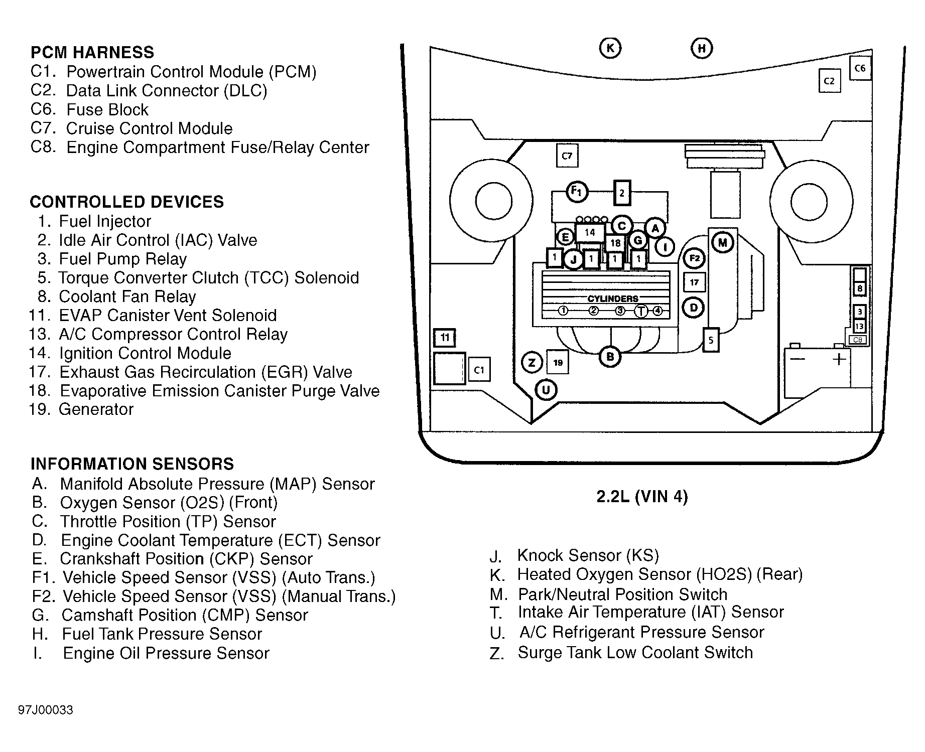

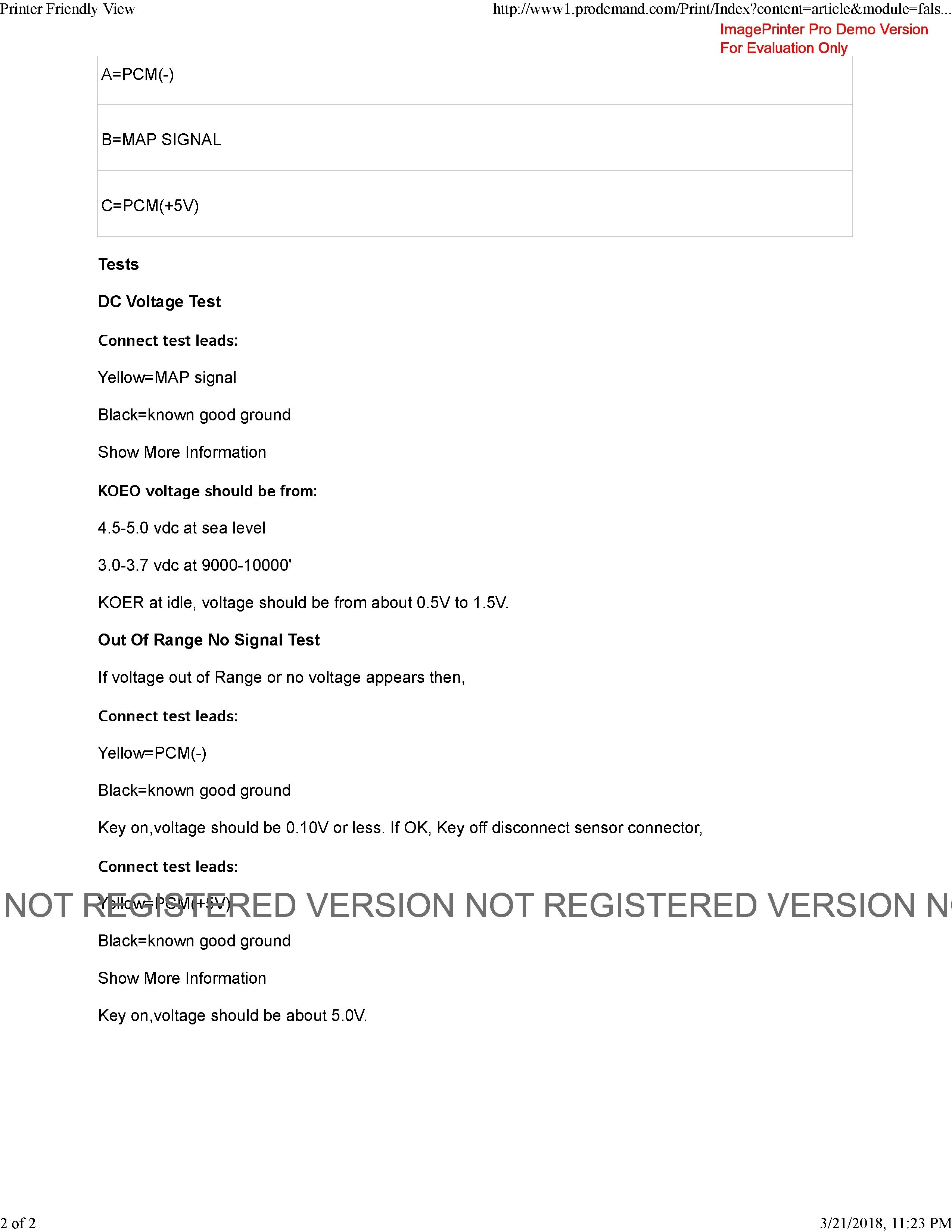

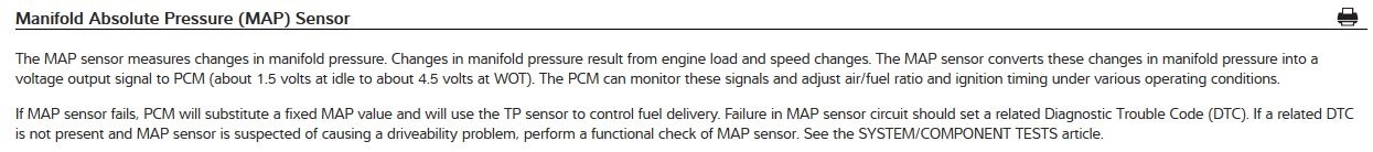

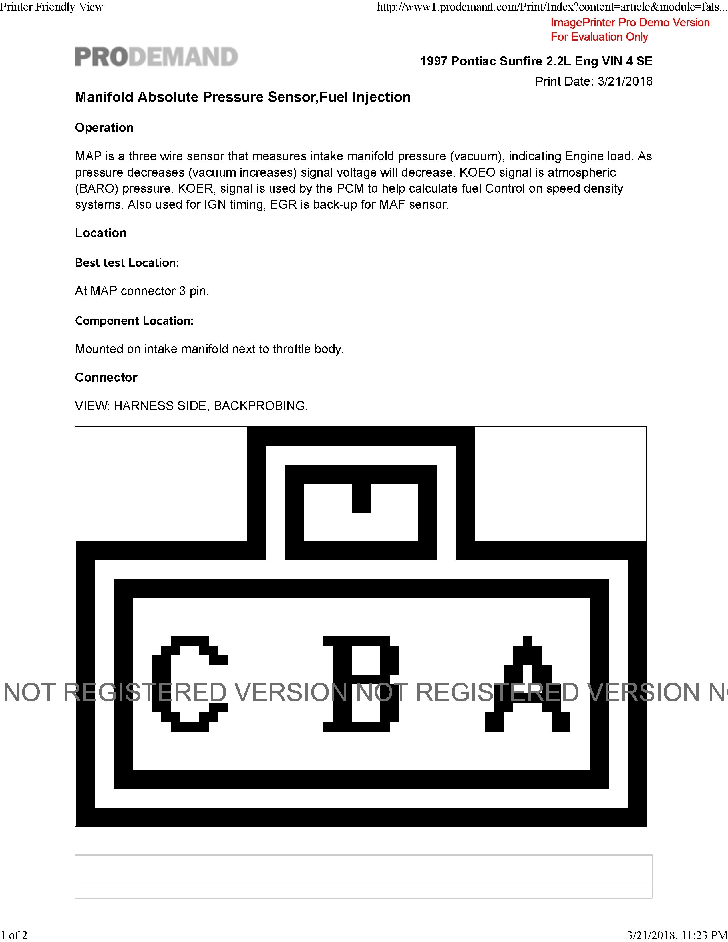

It does indeed have a MAP sensor. I am attaching all of the pertinent information that GM has provided on it in the images below. Please check it out and go from there.
