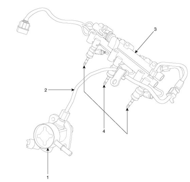

Yep, that is possible, you can have oil leak from the pump if it went bad though. I would lean more towards a bad HPFP especially when the engine will not go over 2500 RPM and hard starting. You can open the fuel cap and look down inside the filler tube with a flashlight to see if you can find traces of engine oil just incase. It is pretty easy to change the HPFP out, just bleed the fuel pressure slowly and have a shop towel ready to soak up the fuel. This diagram should help you do the job. Check out the images (below). Please upload pictures or videos in your response of any problems so we can see.
