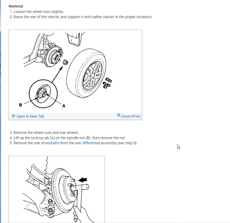

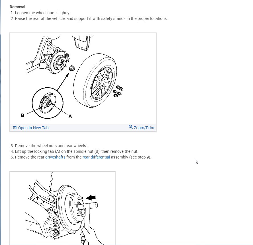

To confirm this is inside the transmission, the way to do that is remove the rear driveshaft and drive the vehicle. If it still does it then it is in the front drive-train (transmission or differential) and not the drive shaft or rear.
This will at least limit it down to a couple of components. At that point we need to decide if this is normal or not due to it coming from in the unit. If it is, can you get a video of the noise and what you are doing to get it to happen? I should be able to help determine if this is gear clash or not.
