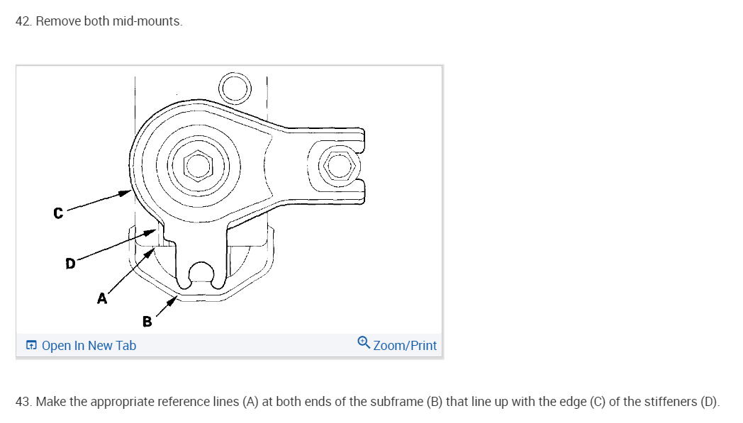

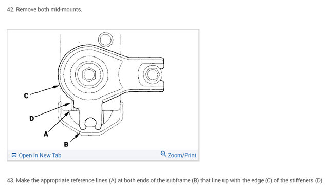

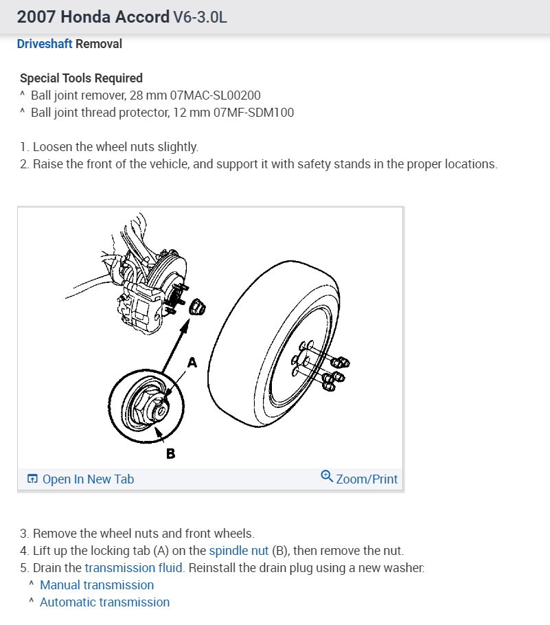

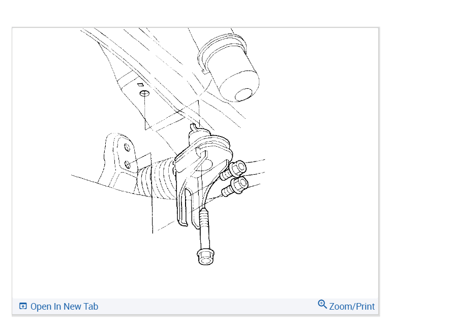

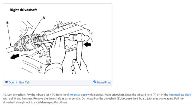

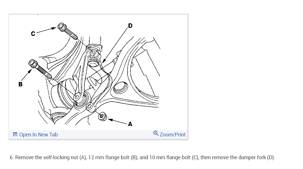

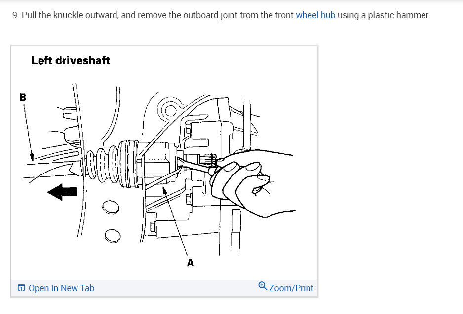

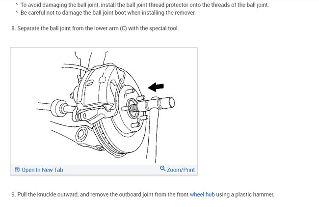

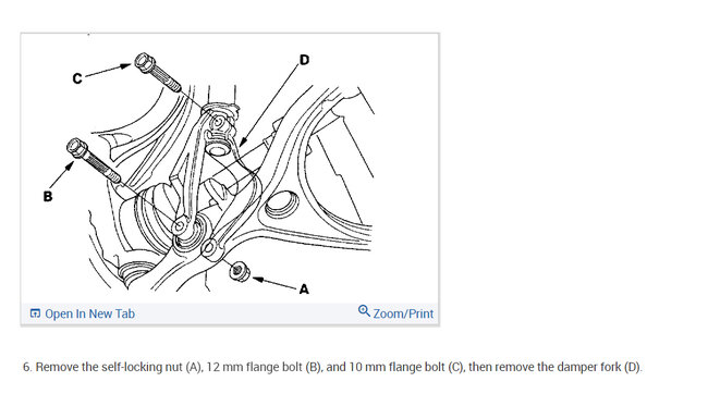

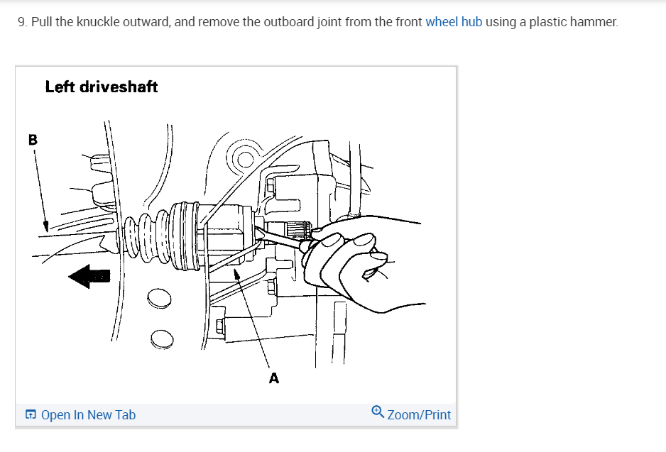

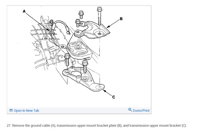

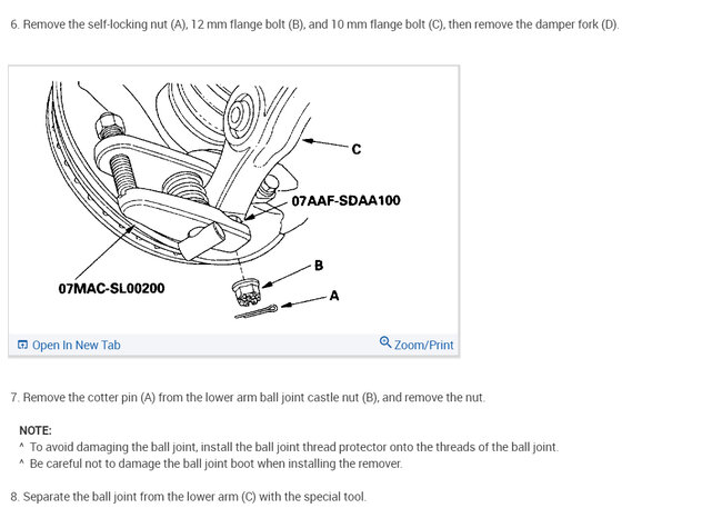

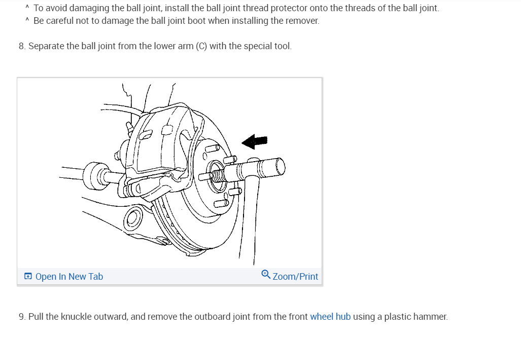

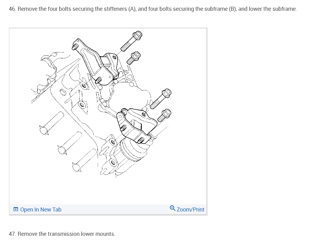

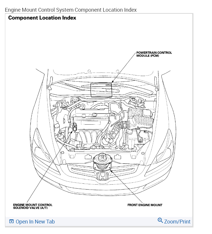

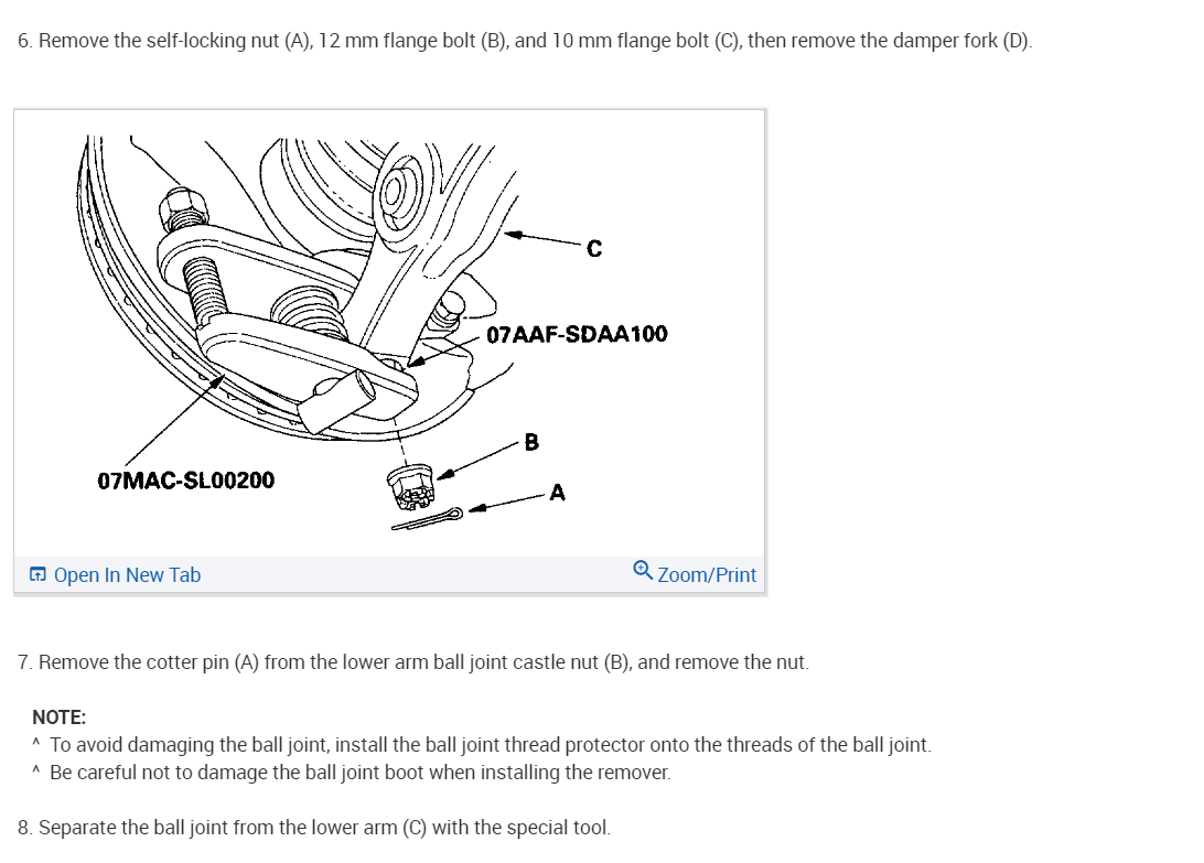

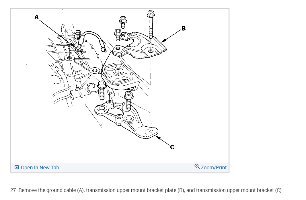

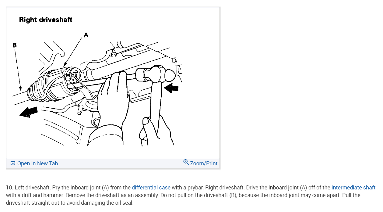

It helps if you can upload a short video of the noise so we can hear it, but I would say it will have a CV axle or a front brake pad issue. If you press on the brake pedal does the condition change? Also, if you steer the car around a corner does the vibration change? If so, it sounds like the CV axles are bad. here is a generic guide to help walk you through the steps and I have included instruction for your car in the images below so you can see how the repair is done in case you want to change the axle out yourself.
https://www.2carpros.com/articles/replace-cv-axle
What happens is the CV axle wears out causing the CV joints to bind and vibrate. Check out the images (below). Please let us know what happens.
