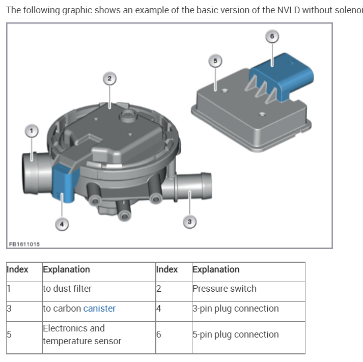

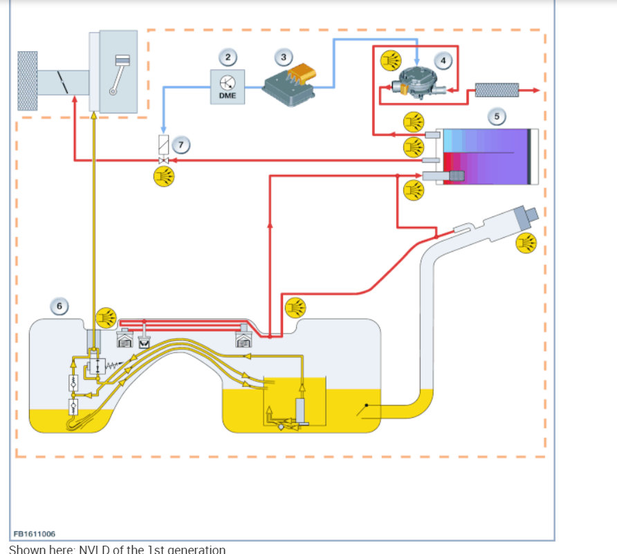

Put your hand on the EVAP tube in front of the A/C lines, it might be an EVAP purge valve. Here is the location of the valve so you can check it out. It looks like the valve is back at the fuel tank. Check out the images (below). Please let us know what happens.
