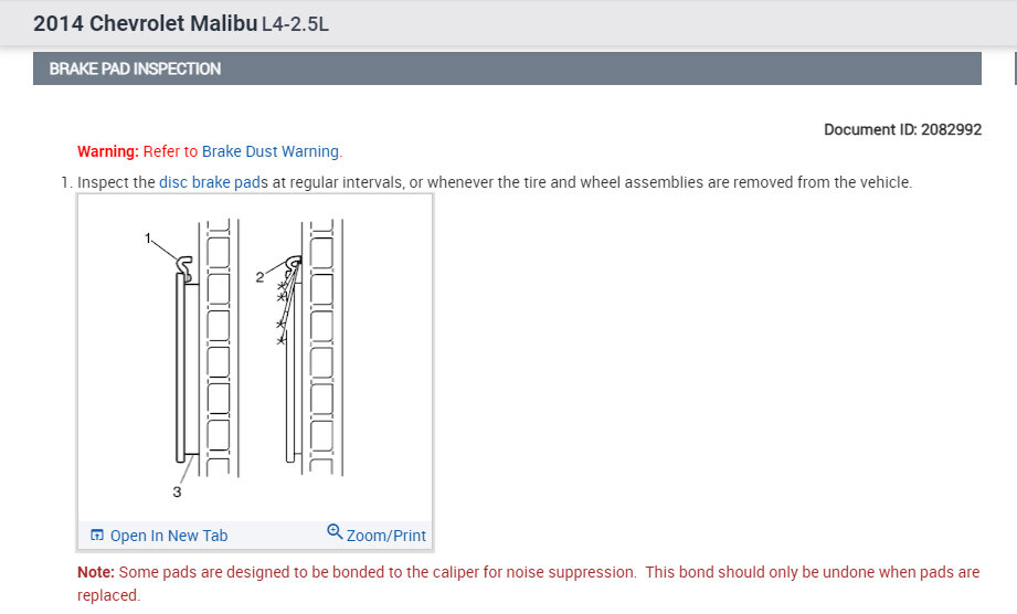

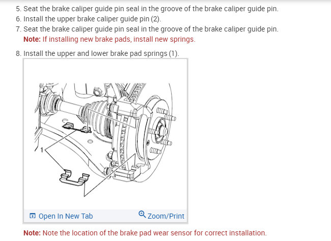

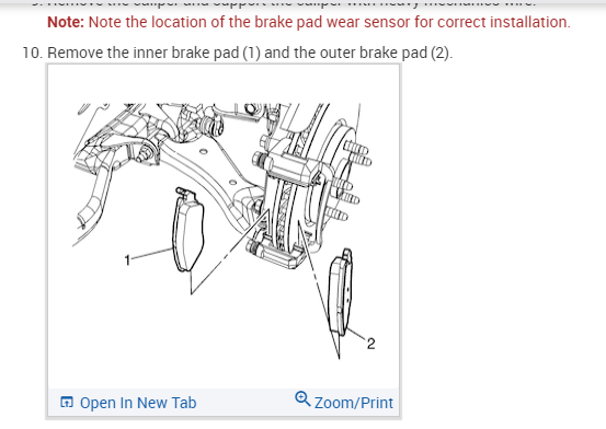

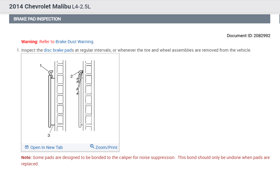

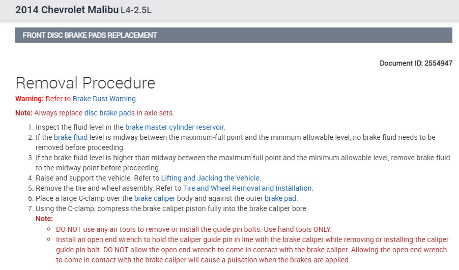

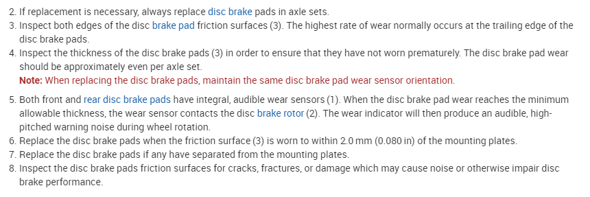

If the sound is only happening when braking, it is likely related to the brake pads. Have you inspected them? There are sensors on them that are designed to touch the rotor and make noise, so you realize they need to be replaced.
Also, I'm in PA, so I know all about rust. LOL Make sure the backing/dust plate behind the brake rotor isn't rusted and touching the rotor.

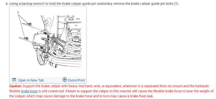

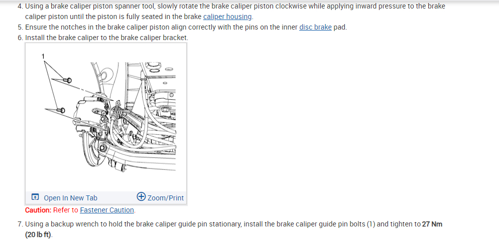

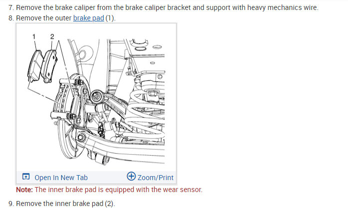

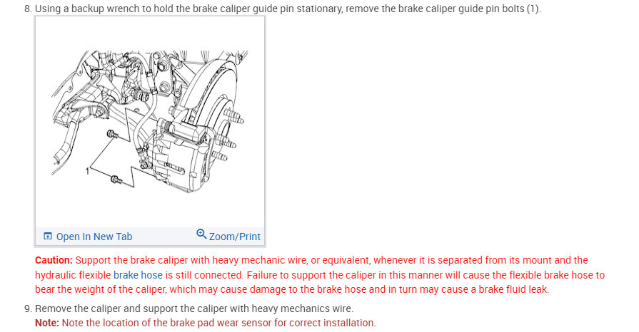

I attached directions for inspecting and replacing the front brake pads. Also, here is a link you may find helpful if they need to be replaced:
Note that the directions are for the front brakes. If the directions are needed for the rear as well, let me know.
Take care and let me know what you find.

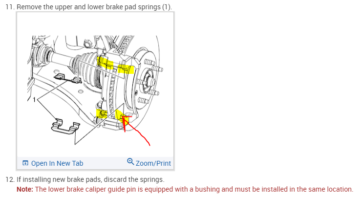

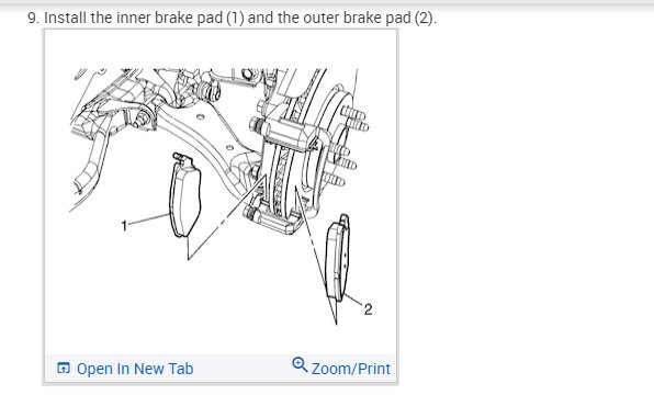

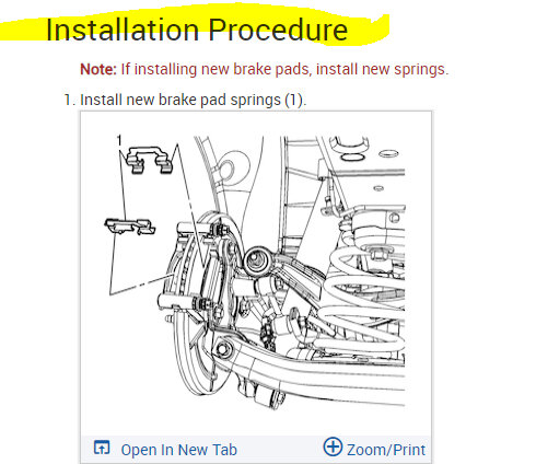

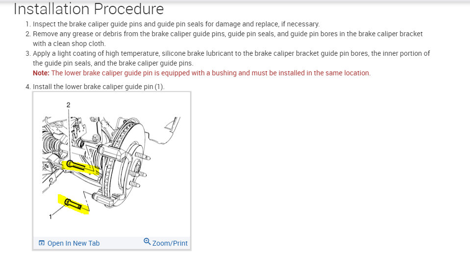

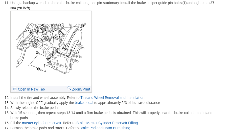

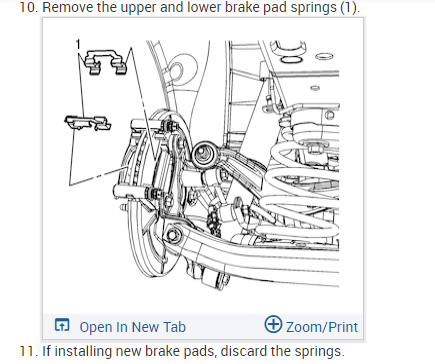

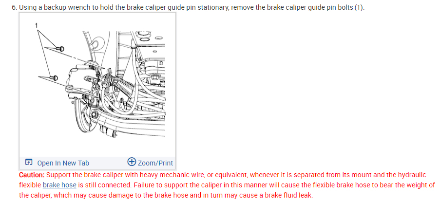

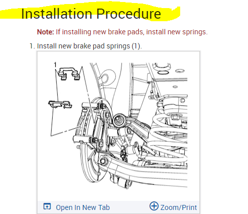

See pics below. Note: In pic 6, I highlighted 4 spots where the brake hardware is placed. Because of rust, take a file and clean the areas where the new hardware will sit. Pic 8 shows the slide pins. Make sure they are clean and lubricated with new brake grease.

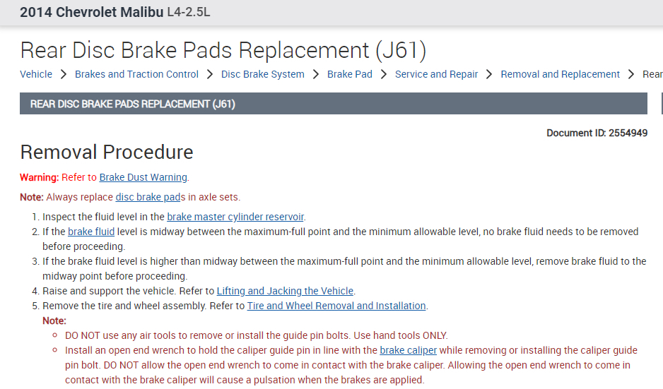

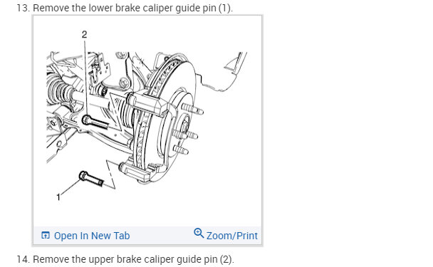

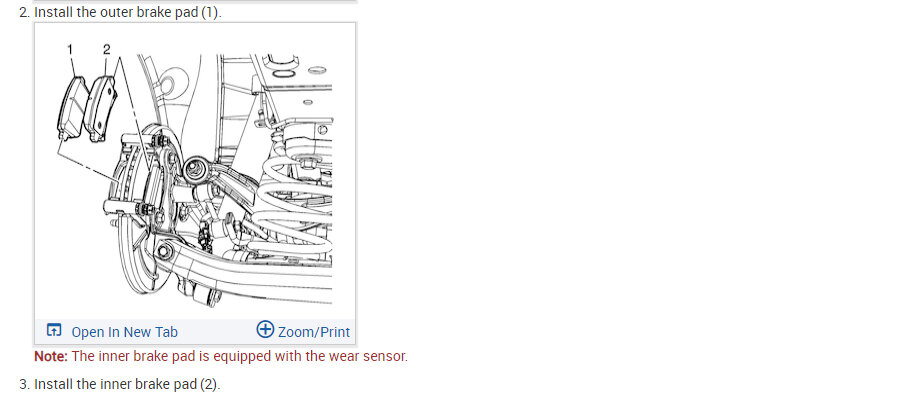

Thanks for the update. Chances are the rear is making the noise. If they are only replacing the brake pads and not the rotors, that is a little high for replacement. They aren't hard to do, so if you decide to do it yourself. let me know and I'll help you through the process.
If you want to only replace the pads, you could do it for under 50 dollars.
Here is a link that shows in general how to replace pads and rotors:
https://www.2carpros.com/articles/how-to-replace-rear-brake-pads-and-rotors

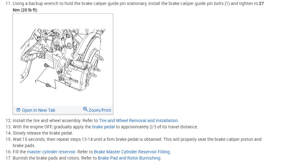

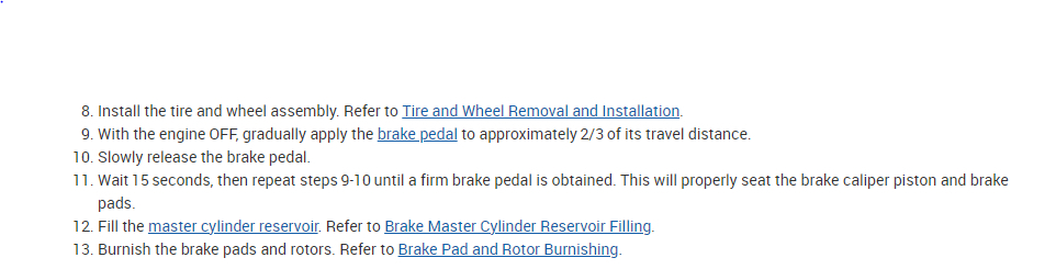

Also, I decided to attach the directions specific to this vehicle for rotors only. At least you can see how it's done and if you would be comfortable doing it.
Take care and let me know if I can help.
See pics below.
