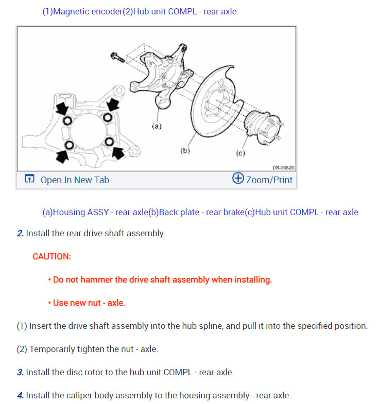

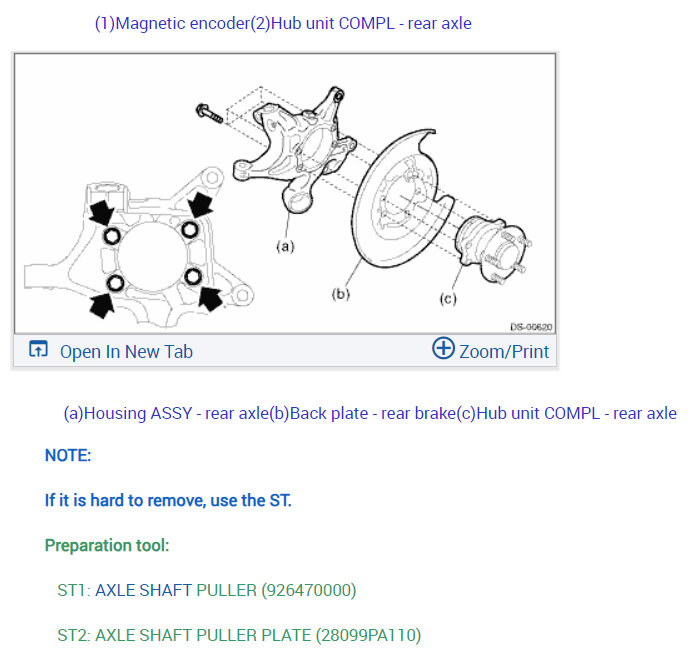

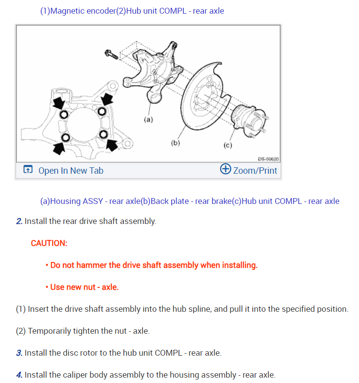

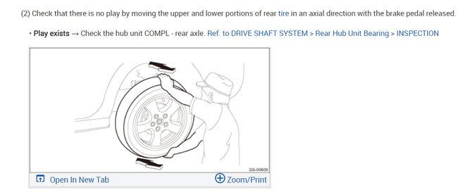

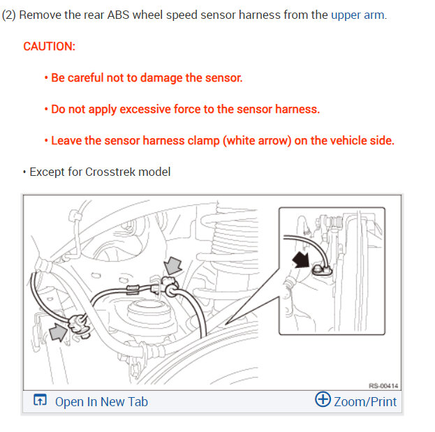

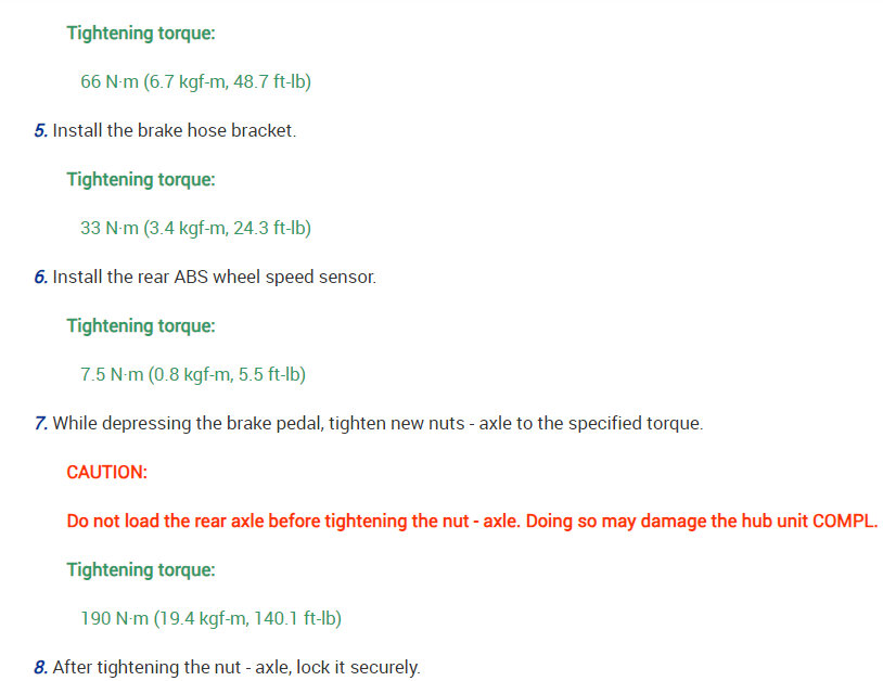

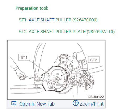

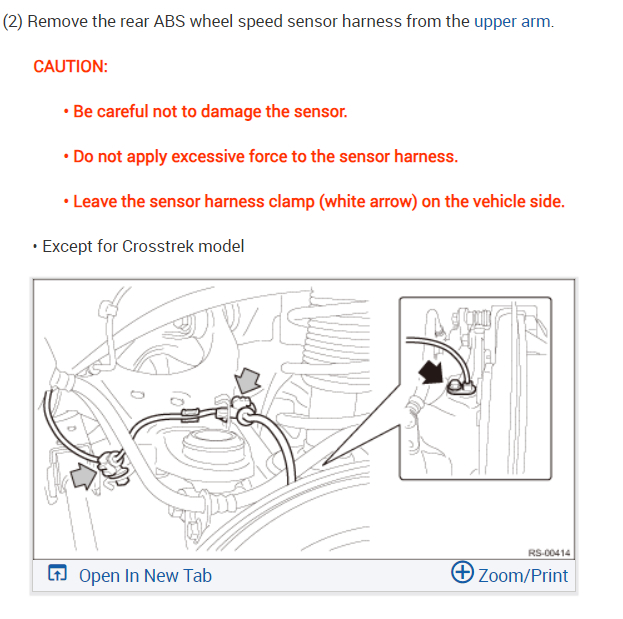

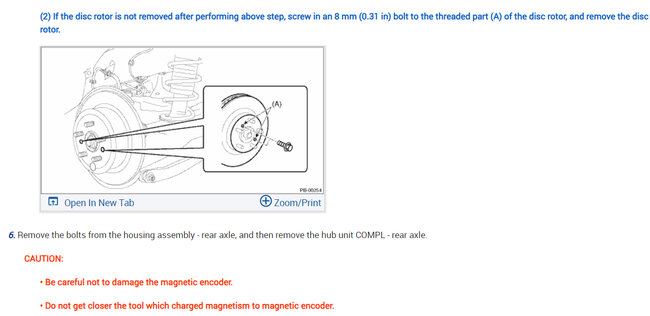

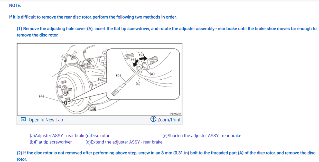

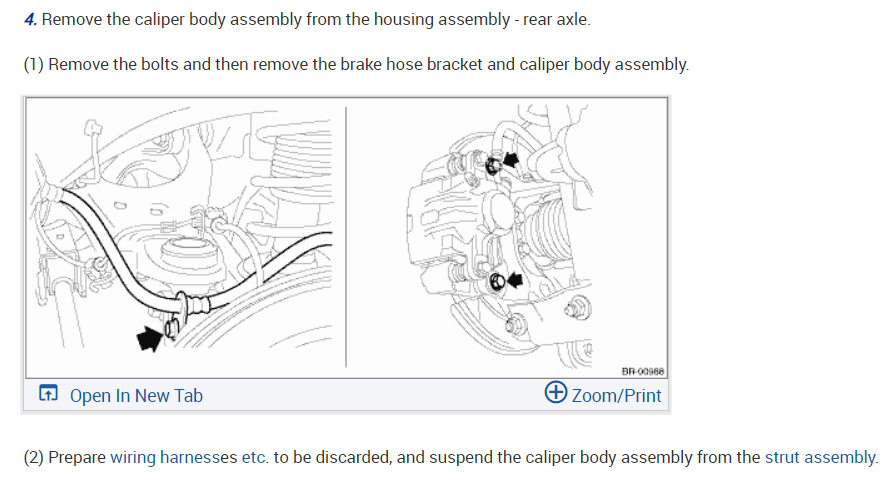

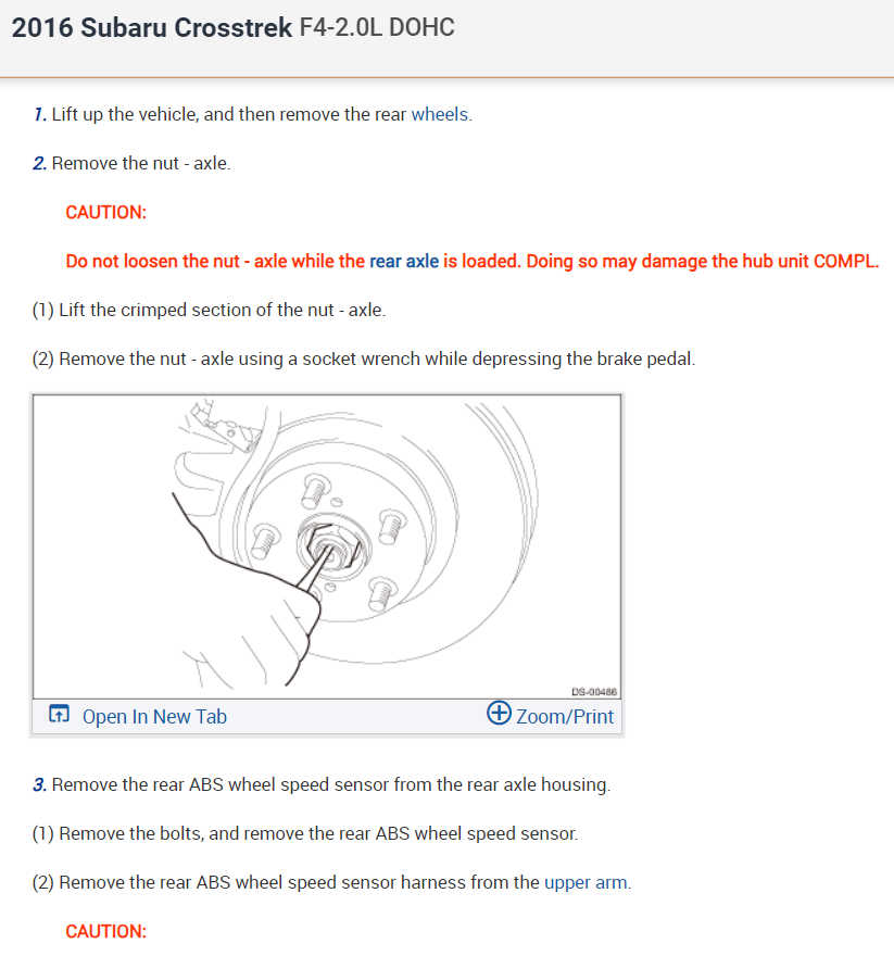

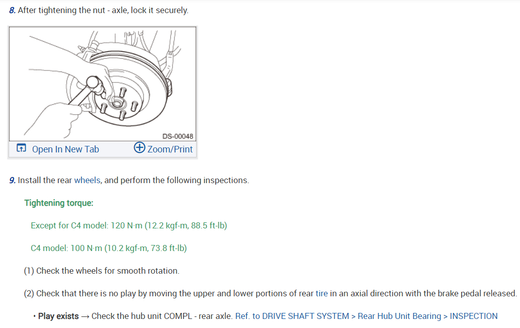

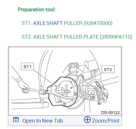

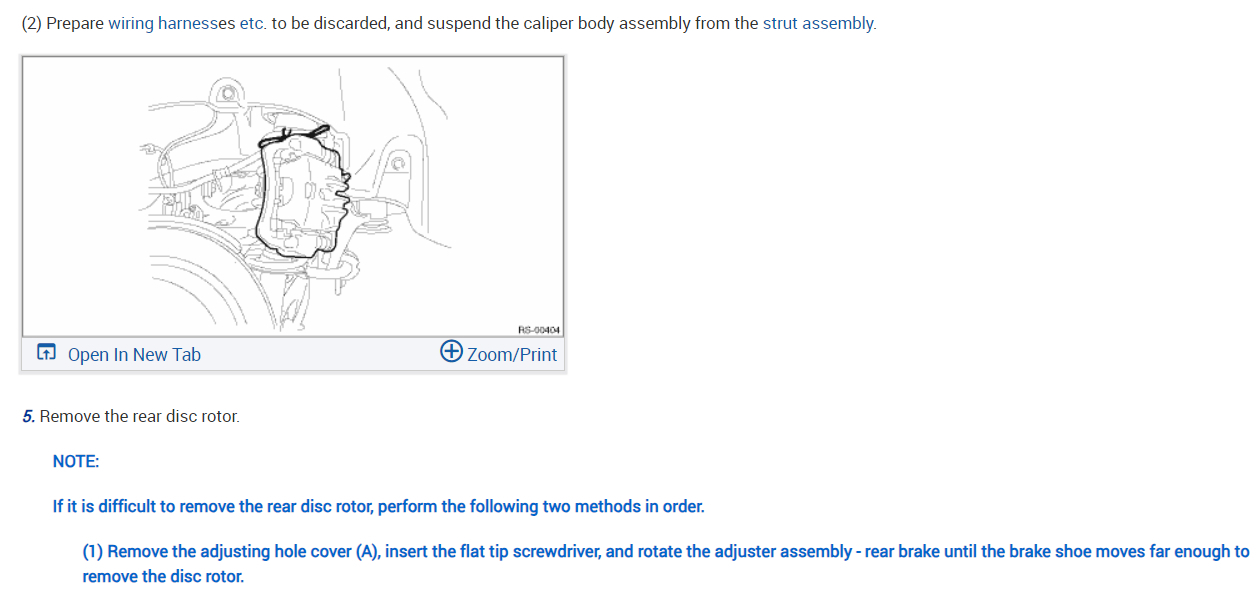

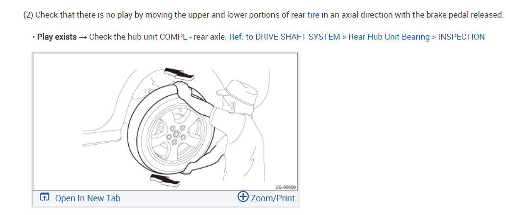

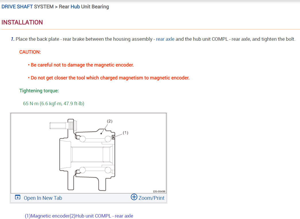

Yep, this is a classic wheel bearing noise, I would replace the wheel bearing hubs as needed to help fix the noise.

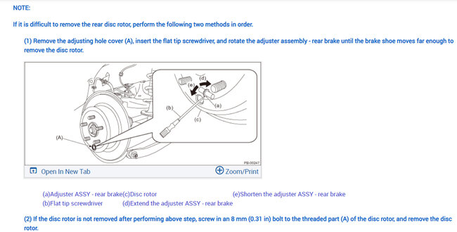

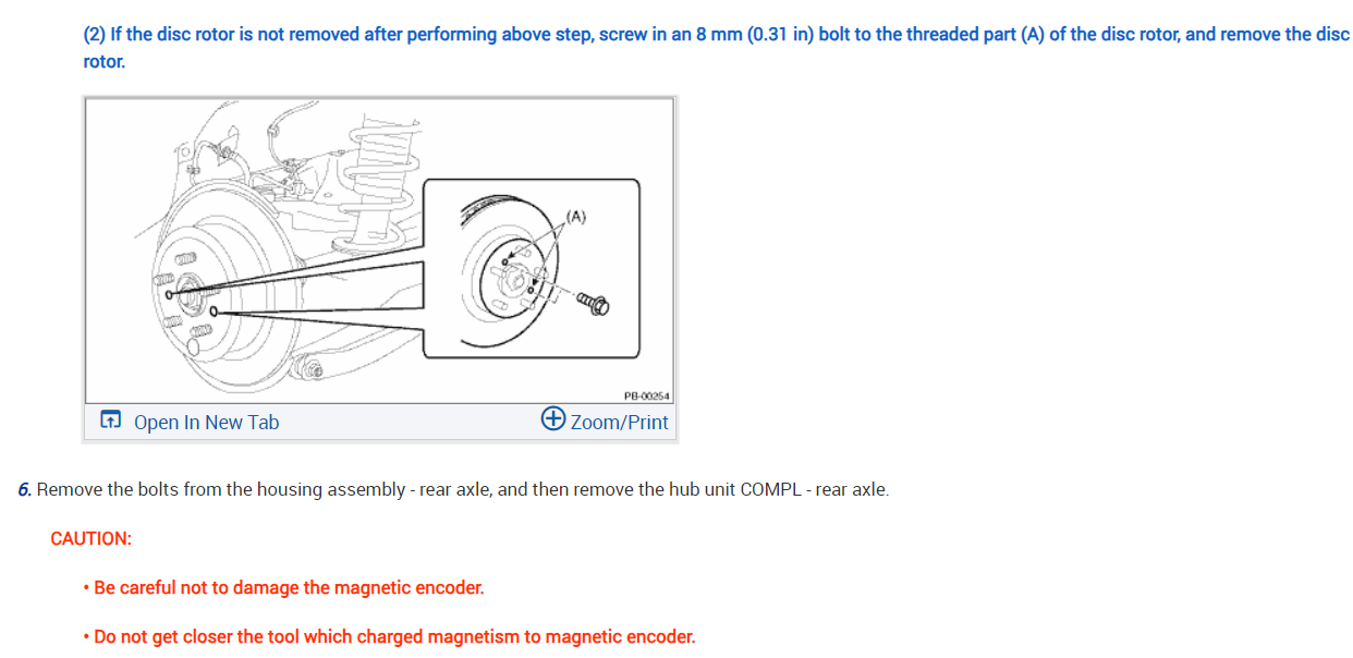

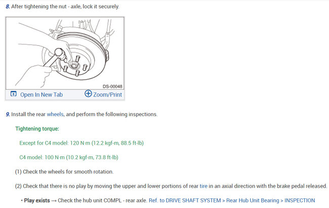

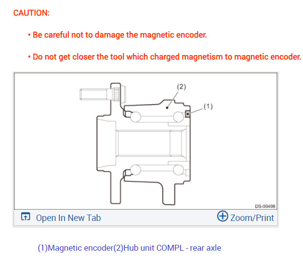

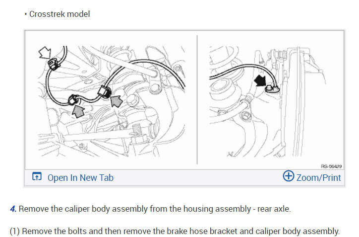

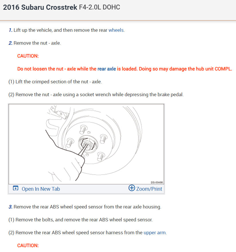

Here is a video of the job being done on a similar car with instructions for your car in the images below:
https://youtu.be/_FzmmBoa4Tg?si=tdF1tU1bPvpWEhuB
Here is how to replace the rear axle bearing hubs on your car. Thanks for the video, it helps. Check out the images (below). Please let us know what happens.
