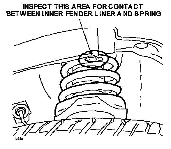

There was a bulletin from Mazda about the coil spring contacting/rubbing the inner fender liner. If you see a shiny part on the coil, near the top then that's the problem. I have attached an image also. Lets check this and then go from there
sean
