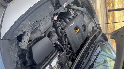

Here is the video.

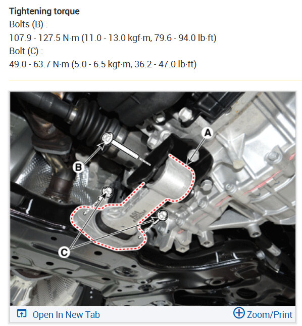

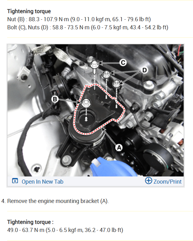

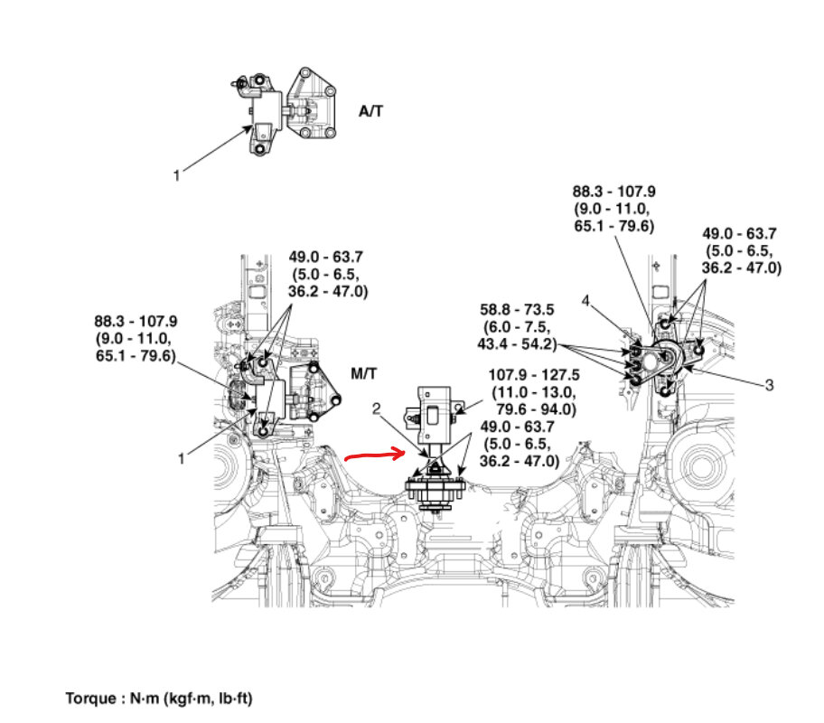

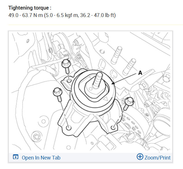

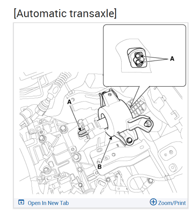

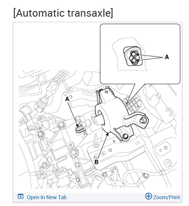

It sounds like you have an engine mount that needs to be replaced, most of the times it will be the torque mount, but you should inspect them all, thanks for the video it helped. If you need help with the engine mount inspection, please upload a video. Check out the images (below).
Mar 15, 2025 at 10:27 AM

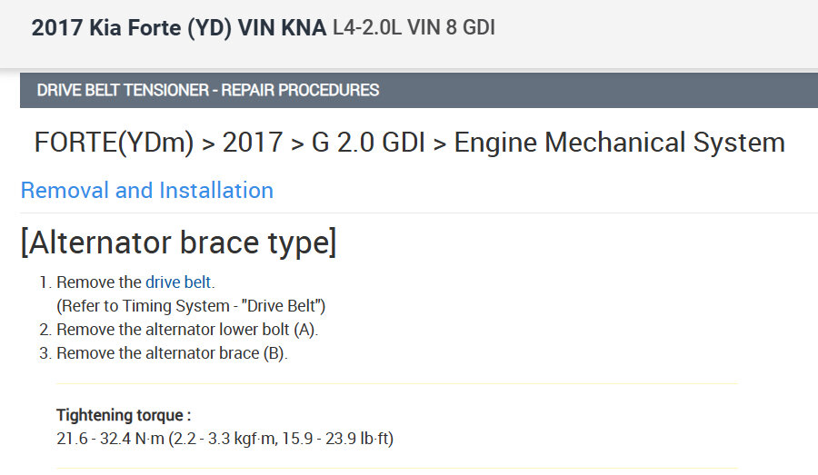

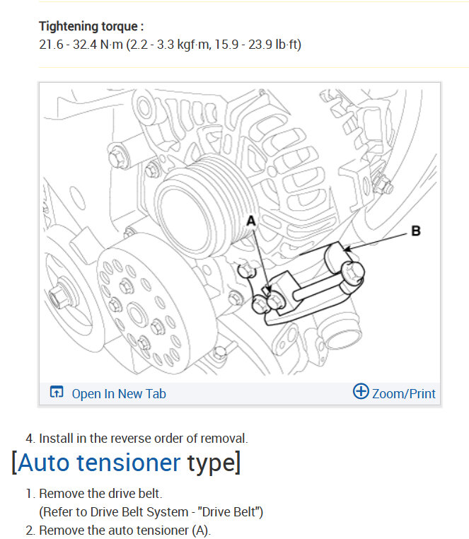

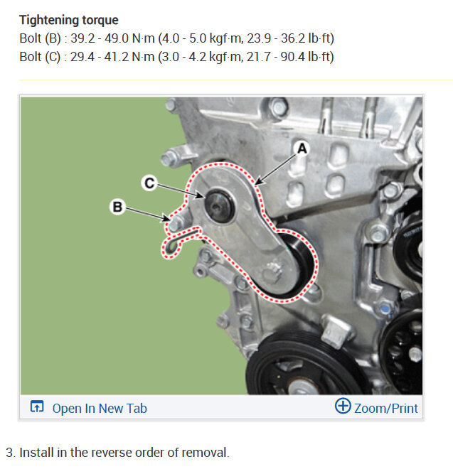

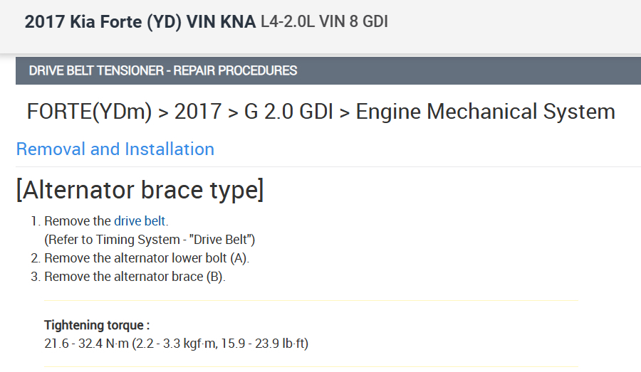

Thanks for going over the guide. Nice work, if the tensioner is bad, it will make this noise as well, here is how to change it out. Check out the images (below).
Mar 17, 2025 at 9:18 AM
