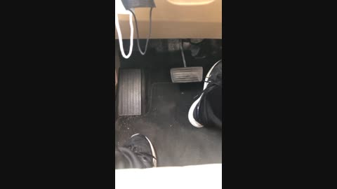

This is the video.
Aug 9, 2022 at 1:15 PM
Thanks for the video it helps, it sounds like one of the engine mount/cradle bolts is not in or loose allowing the engine to lay over onto the frame or brace. I would put the car on a rack or jack it up and use a flashlight to see if you can detect the problem. There should be clearance around the engine.
This guide can help:
Let me know what you find.
