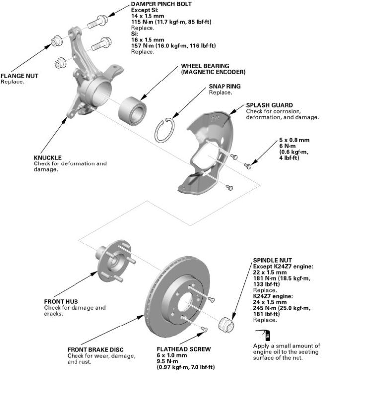

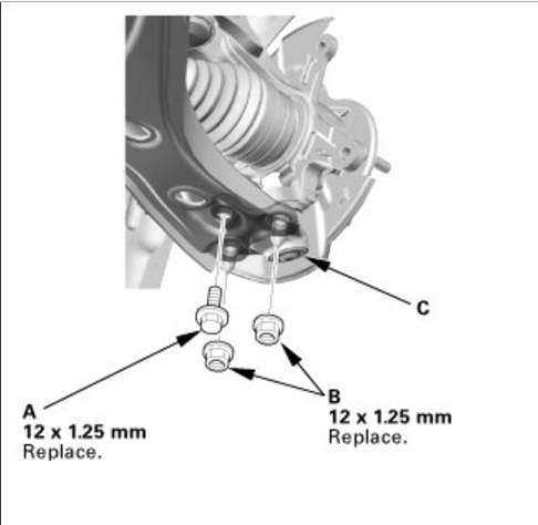

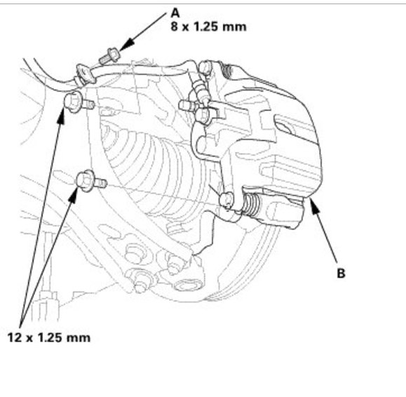

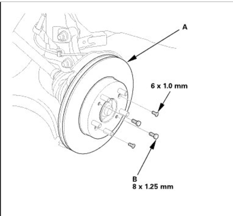

Can you take a video of the noise and give us a link? We have found it is must easier to hear the noise then to try and guess it at. If I were to guess I would say you have an axle bearing that is out.
Here is a guide to help you see what you are in for when changing the bearing:
https://www.2carpros.com/articles/how-to-replace-a-cv-axle-bearing
Here is what it is on your car:
Please let us know what you find.
